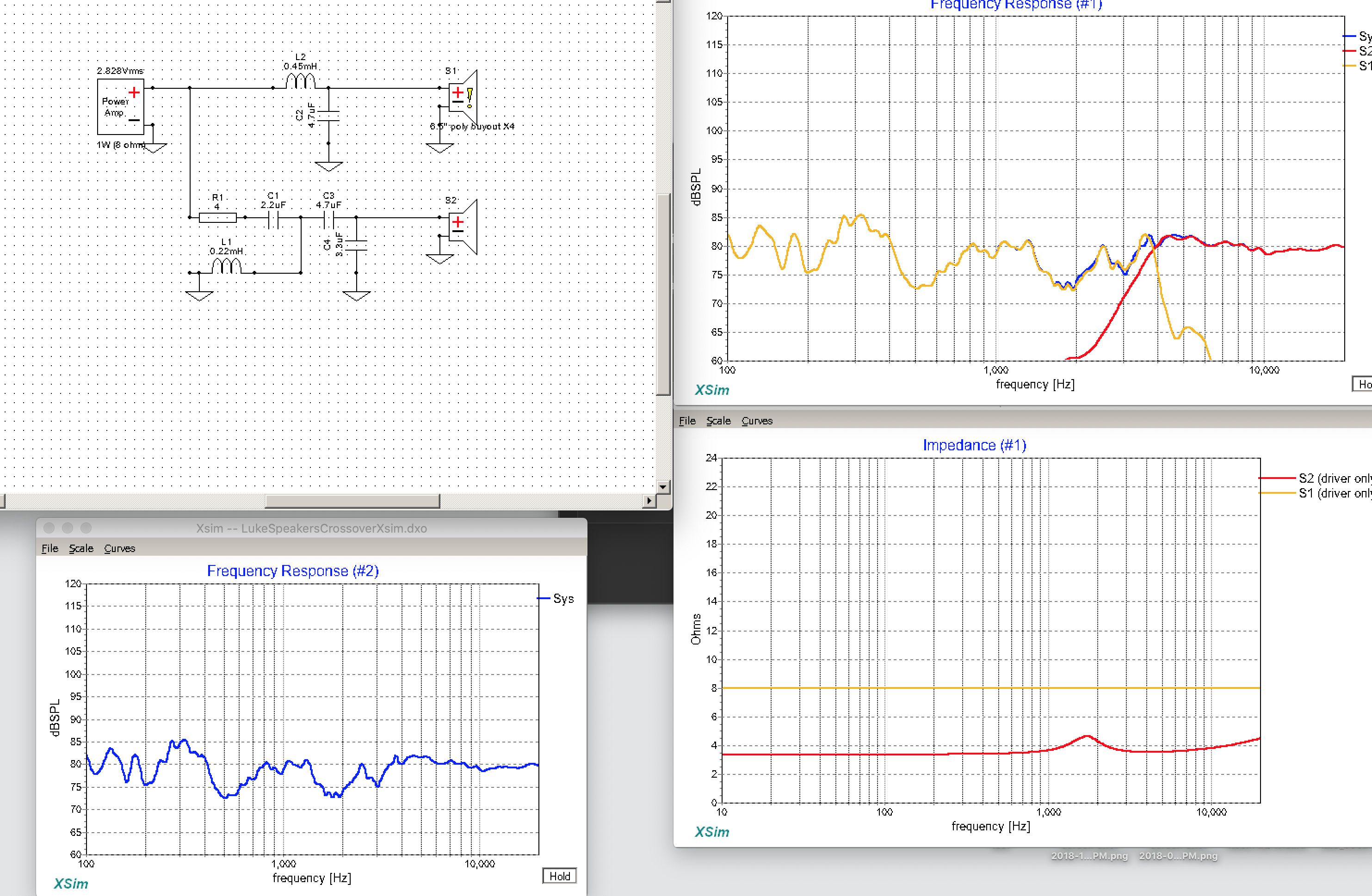

First crossover, be gentle
(4) poly buyout 6.5" (299-609) woofers and (1) Dayton TD20F-4 silk dome tweeter.
I used REW to get the response of the woofers in the cabinet, but used the FRD file from dayton on the tweeter.
How is this to start? The woofer is $6, the tweeter is $7 so temper expectations. I would like to keep it to (2) inductors as they cost enough to second guess adding many, but I have quite a decent assortment of electrolytic unpolarized caps and have a few power resistors.
Hopefully the forum allows the attachment of the Xsim and REW files.?

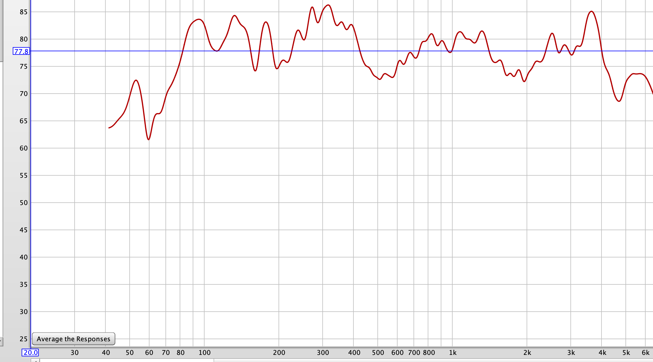

I assume you measured the woofer to capture the baffle effects? It seems that reflections have been included in the measurement. Rew can be a little challenging to learn with its gating, and it is necessary to concede the lower frequencies to the room and simply try to get the middle/higher ones captured without reflections.
yeah, the REW measurements are in a basement, near cinderblock walls. I have not figured out a good jig to measure outdoors yet. The other big thing I forgot to mention is - How do I know what offset to use for the woofer response? I have no idea what power it was getting, I just adjusted until REW was happy with 10db headroom, which then still gave me a clipping warning at higher frequencies.
If the levels are off a lot then it seems the 4 ohm resistor can just be increased to drop the whole tweeter down to match?

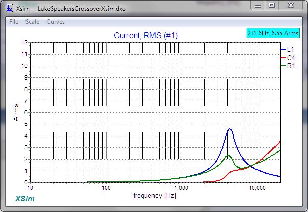

One thing you should always do in XSim is open the current panels...
Add Graph -> More -> Component Currents ... then jack up the amplifier power to see how much current is being diverted to ground.
Of concern is that R1 and C4 both show a rising current with frequency. You may want to rearrange the tweeter circuit a bit to see if you can eliminate that. Moving the resistor to be between the two caps, might help.
Basically any amplifier current routed to ground is wasted and if it gets out of hand, it could overheat and/or damage the amp.
There has to be some frequency down to which you can get a clean result.

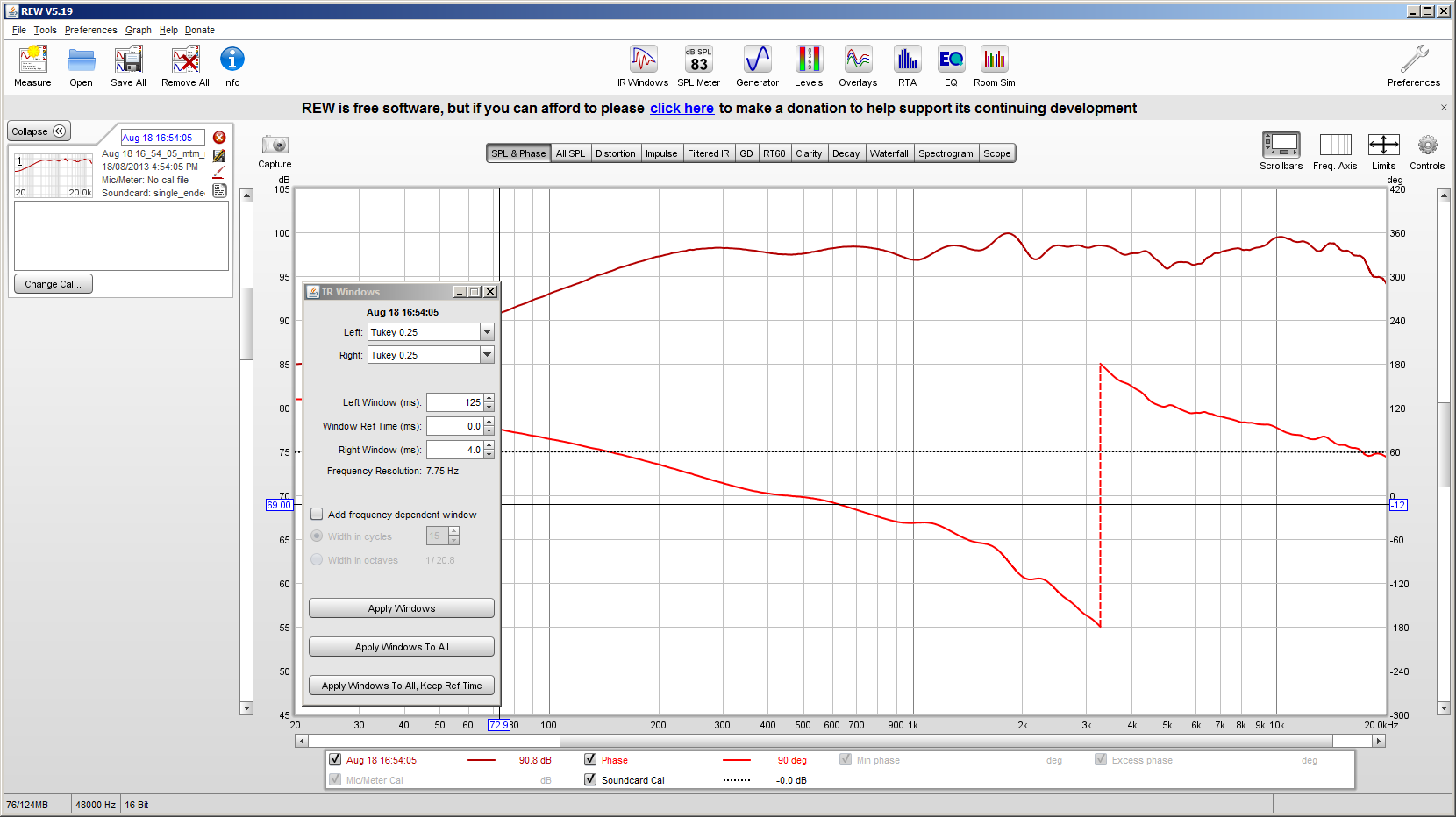

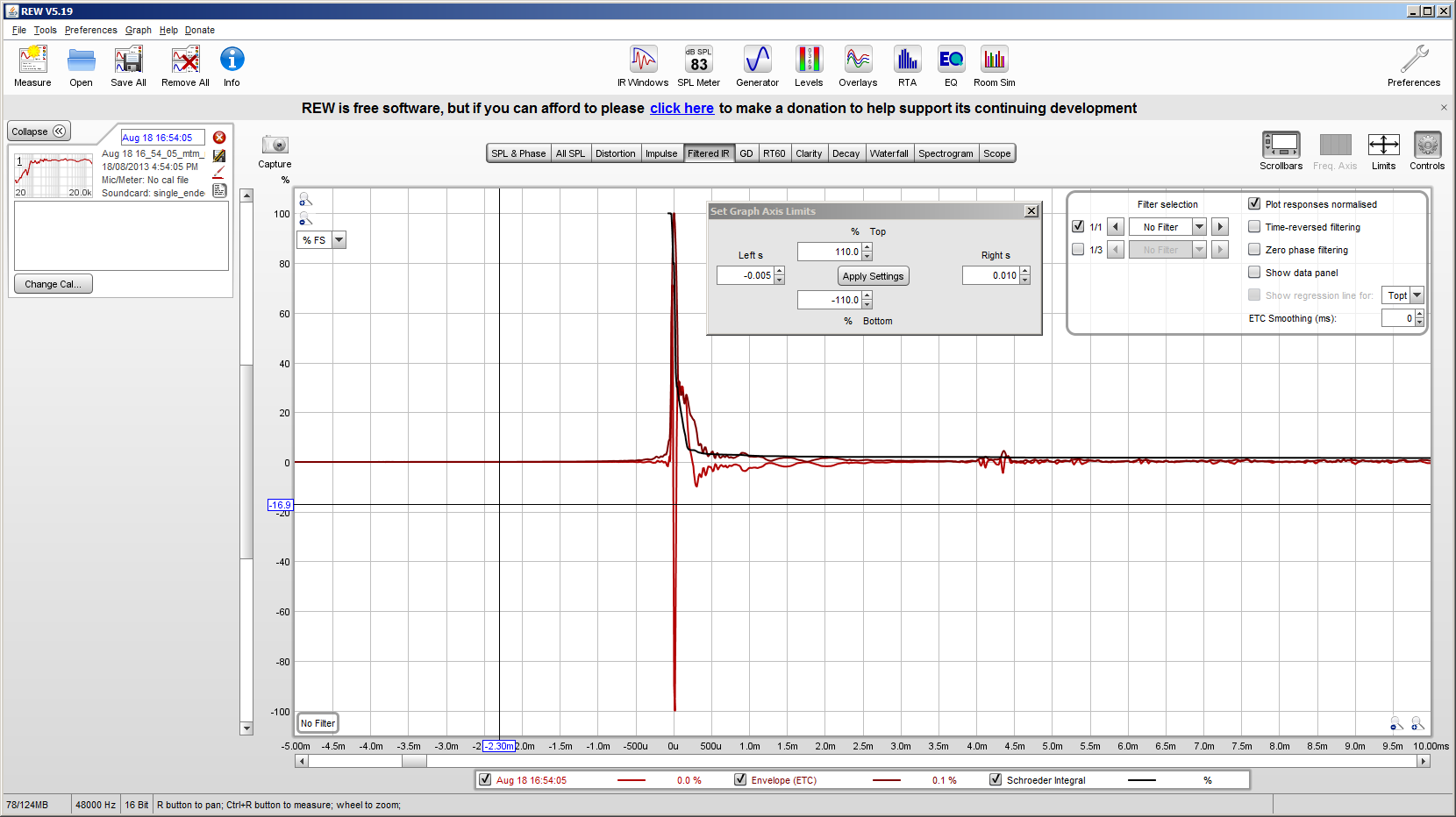

OK attached are some exanples for REW.
To see your impulse clearly go to the Filtered IR tab and change the settings as per below: Note you need to change the %db to %fs on the left side of the graph.
attachment.php
You can see here that the first reflection is at around 4ms Note that this measurement was taken outside. You will struggle to get reflection free up to this time if measuring in a typical room.
Once you know where your reflection is happening, go back to the SPL tab and click on the IR Windows Icon once that is open put in your ms value for where your first reflection is, in my case I chose 4ms. Your curve should now be gated. as per below.
attachment.php
Note that no smoothing has been applied to this. It is just the effect of the gating.
Tony.
