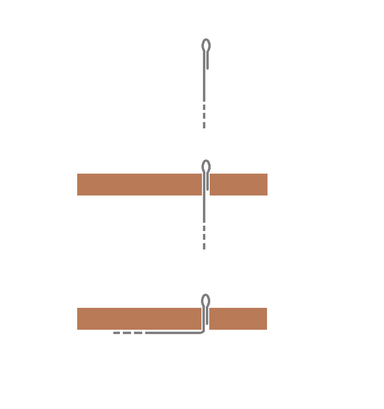

Hey guys, I'm new to speaker building and am doing Paul Carmody's Hitmakers as my first project, and just wanted to post a picture of the crossover before i glue it to make sure that everything is set up properly.

Nobody can judge whether it is correct or not because (1) your photo doesn't show where the speakers and amp connect to the network, (2) your photo doesn't show what values of capacitance, inductance and resistance are connected where, , and (3) the connections and the components(s) at the top of the photo are not visible.
There are some photo-editing programs that would allow you to add component values to the photo, but of course you don't necessarily have such a program.
Really, it would be fairly simple for you to decide for yourself by carefully comparing what you have soldered together to the schematic of the cross-over network.
One inductor on its side and the other one upright is correct to reduce interaction between the two fields.

Thanks for the responses, and sorry the picture was so unclear, but picowallspeaker was correct in his interpretation of it.

It looks like your soldering correctly corresponds to the schematic. If it were me, I'd try to make the connections rectangular and keep the wire leads of the components straight, but doing that is not really necessary for it to function correctly.
If you were to use at least a few terminal strips, especially for the connections to the speakers and amp input terminals, in assembling the network, that would help to insure that the connections stay solid. Making a good solder joint with three or more wires twisted together is somewhat difficult and doesn't look great.
