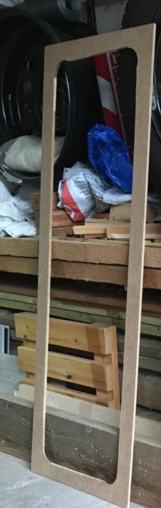

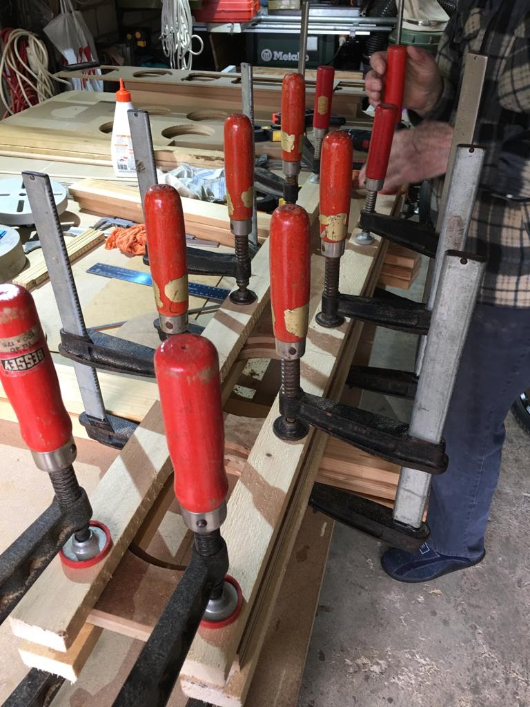

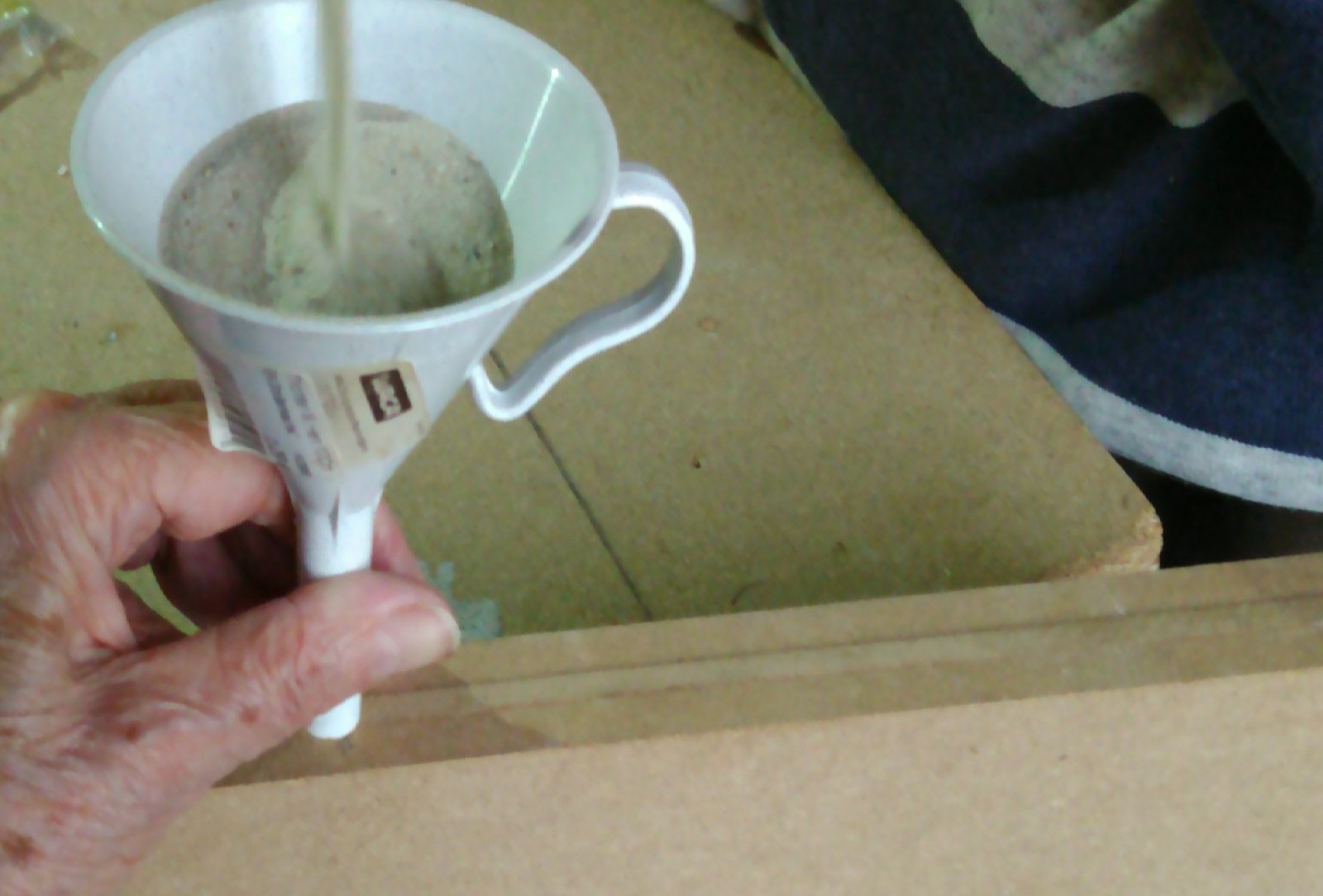

Instead of using bb ply I decided to do a double walled, sand filled enclosure of mdf.
Front and side walls ill be of 10-6-10 mm thickness.
So in total 26mm with a 6mm sand inlay.
here the 6mm frames for the middle layer.
then laminating the 3 layers.
and finally inserting the quartz sand.
top, bottom and back will be simple 22mm mdf

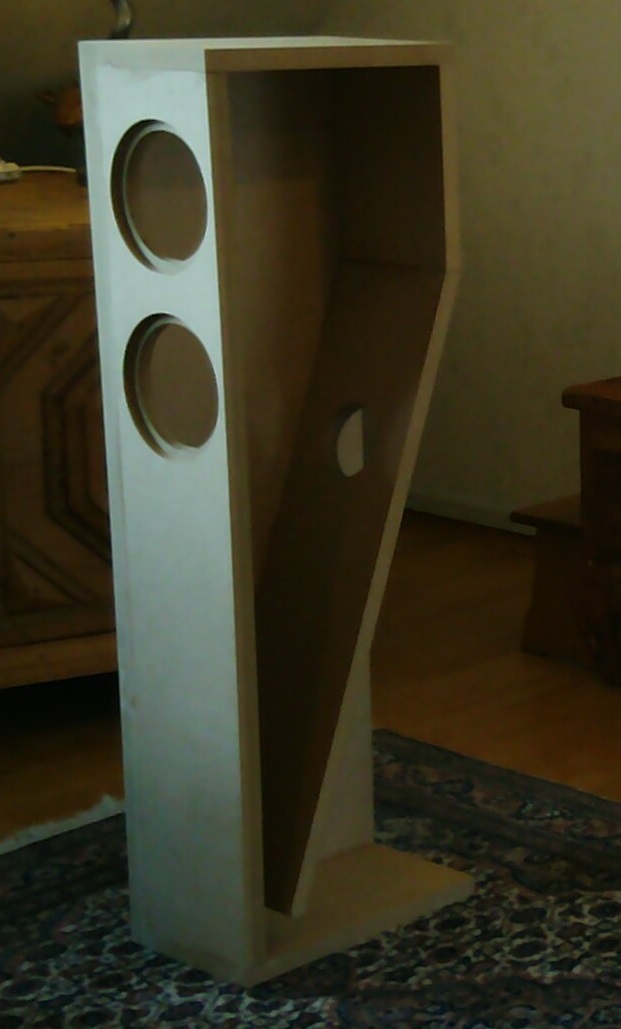

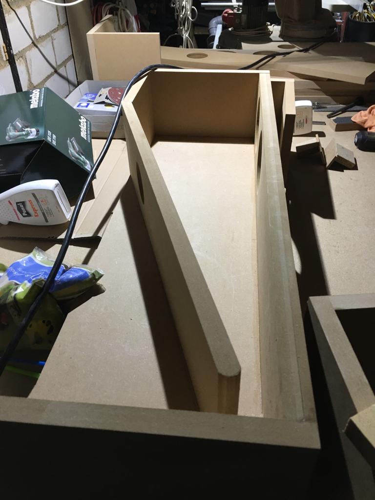

so the heavy part is done.
preparing the double walled parts was a time consuming work.
hope it is worth this effort.

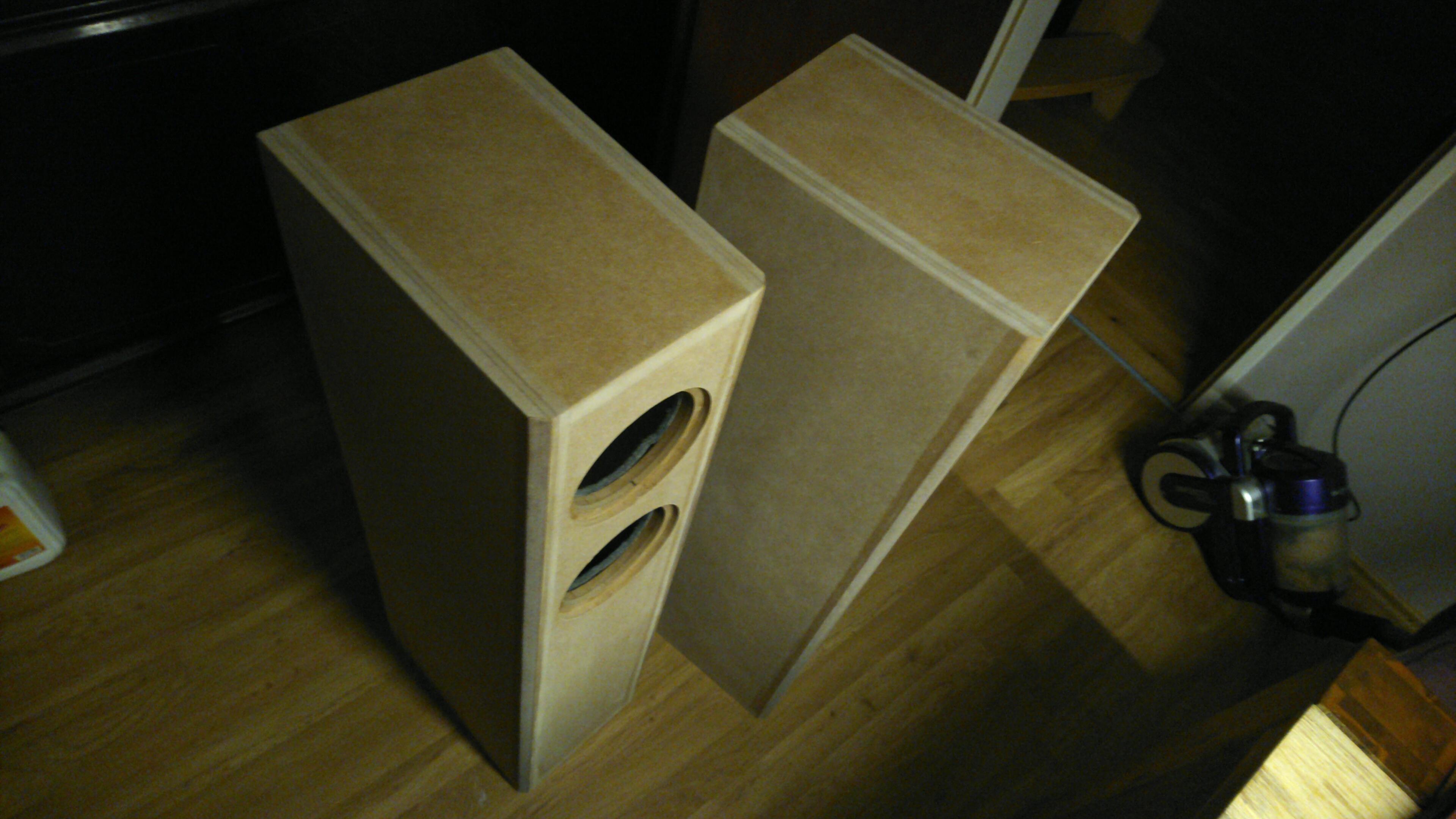

glueing the parts to finally build the cabinet was easy.
only one none 90 degree cut. a little bit fiddling until the right angle is adjusted at the table saw.
almost finished cabinets.
I will attache some bracing though
time to line the inner walls with felt.

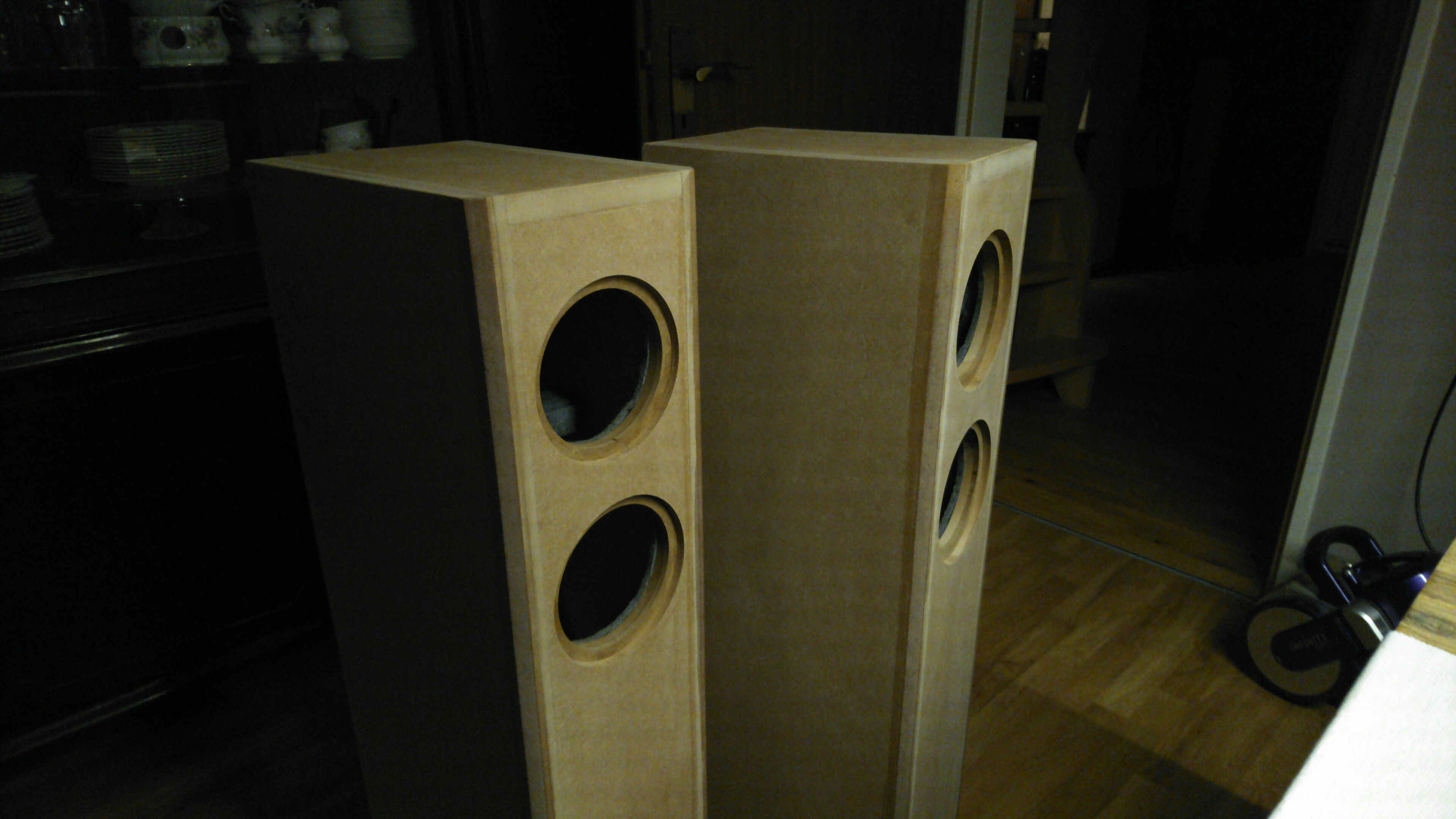

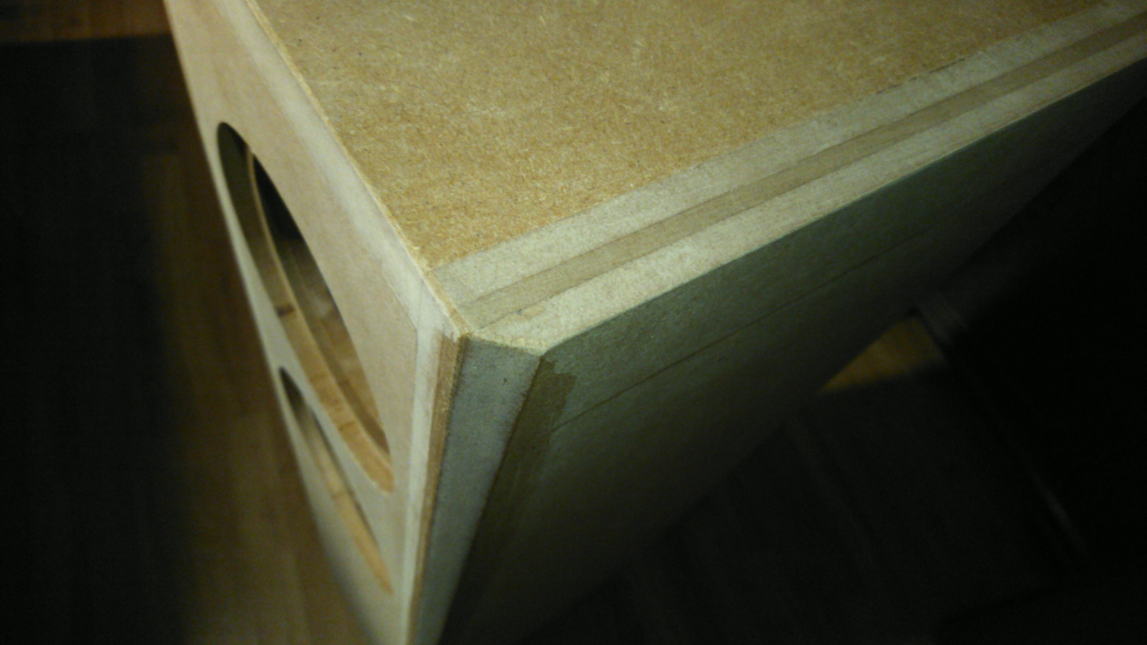

exactly routed cutouts for the drivers.
chamfered corners at the front.
you can see the three layers of the side walls.

You put much effort into the enclosures. Must have some weight 😀
The enclosures look really good.
The cut outs look perfect.
I think this is the most difficult part. The alpair's frames do not allow to large holes.
