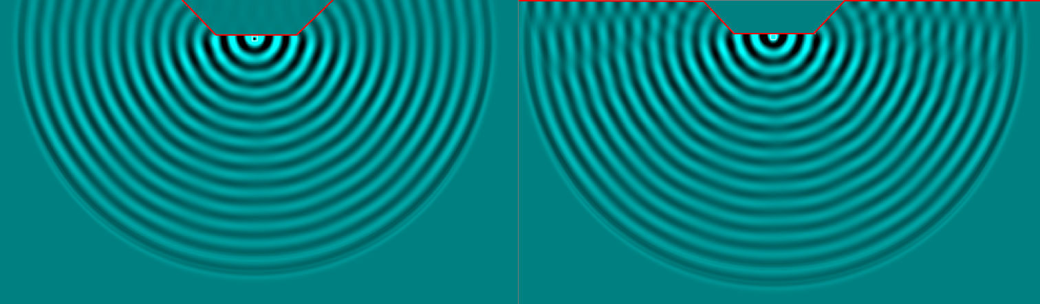

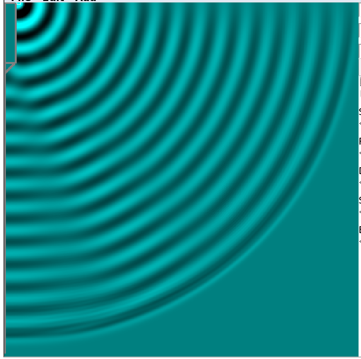

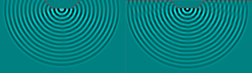

Earlier I was responding to what WBS was beginning to say, and the point was that even though the table makes that shape look good in free space, the result isn't the same with a wall.
The point was that the less the chamfer is required in the first place, the better.. and that the result will not be the same with a wall.

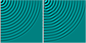

I don't trust the images below to show the full effects, including the time delays and other issues that alter the perceptibility of the differences (also the degree of visibility doesn't necessarily relate to the degree of audibility). Only to show that there is actually a difference. (This example was randomly chosen.)
In addition, the front wall is considered by some to be the worst surface to have sound reflected from it, ie early reflections, when it comes to affecting imaging.
True.
In the bass. Wavelengths get long enuff, it does not see the edge at all. The chamfer still gretly reduces edge reradiation at higher frequencies.
The nature of what you are attempting to depict is different as frequency changes. At LF & HF we know what happens. It is in the bafflestep transition range, a chamfer should still smooth that out as the “edge” is not well defined as it would be with an orthoganol edge.
By some. If a reflection is withing a certain time window (i’d have to look up the exact number), the brain just integrates it with the main signal. With the speaker right against the wall that number will be very small.

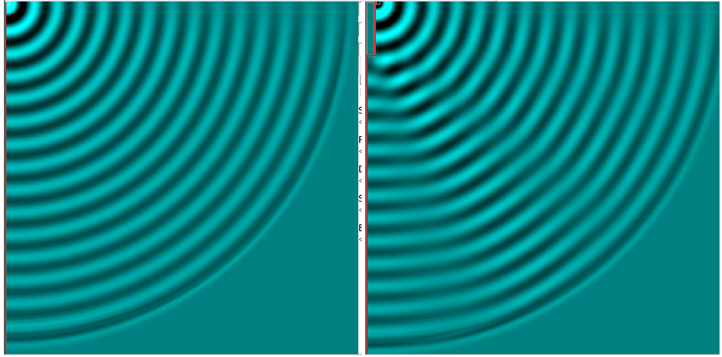

Behaviour depends heavily on frequency being looked at.
At HF we have a 2π space, just as with any other position. And issues with what happens at the edge (edge diffraction). Best would be somesort of increasing radius curve, but a chamfer (or prefereable a 45° side) is much easier and close, particularily if you soften the initial edge).
At low frequencies the waveform does not even see the edge and the wall extends the baffle.
The only area we have to worry about is the stuff inbetween (normally the FBS(-3). Olsons work deals with shapes in 4π space. If we look at the sphere and the semi-sphere we can see that the ripple as one transitions from 2π to 4π space that the flat back edge of the semi-sphere is acting as the edge of the cabinet for some frequencies and we get much larger riipple tha the full sphere. against a wall there is no edge, we sort of have a “mirror” of the semi-sphere and should have little ripple. This supposition would need to be measured in the real world to see if it holds.
Further, we expect that the level of any waveform travelling across the surface of the baffle. Being a 2D space, this will be less than the 6dB in free space, probably close to 3D with every doubling of distance. The wider the baffle, the greater the attenuation leading to a reduction of any issues that occur at the edge.
That, and that as the width increases the affected frequencies drop, suggests that a wider baffle, with a slower transition to the wall, will have less effect.
dave
Lobing is associated with 2 sound sources producing the same frequency from 2 different spots. Here is would be primarily caused by the HF diffraction at the edge. A softened chamfer (45° side in this case) is way better than an orthoganal edge and effectly larger than any round over you can add. As per above an increasing radius would be a slight improvement, but much harder to implement. It would be horizontal lobing not vertical lobing. Further the reduction in level with the distance it would travel to get to the edge of a wide baffle would further diminish any effect.
