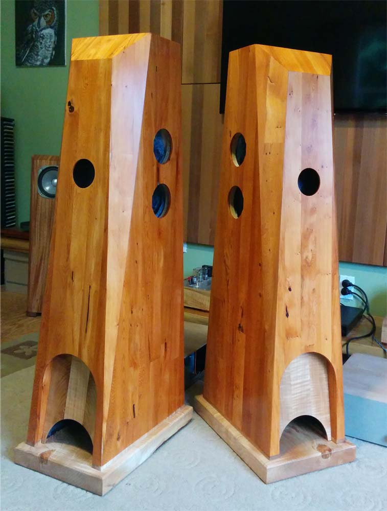

Here with no drivers and freshly clad in very thick yew veneer (which showed up some issues with bracing that we still need to fix). They have since had some rebates & the sharp edges softened.
Can you please elaborate on this very thick veneer - where you can get it, is it a ply or a single layer?
Cut from yew boards by Bernie. It is about ½" thick. In this case scraps left over from other projects.
