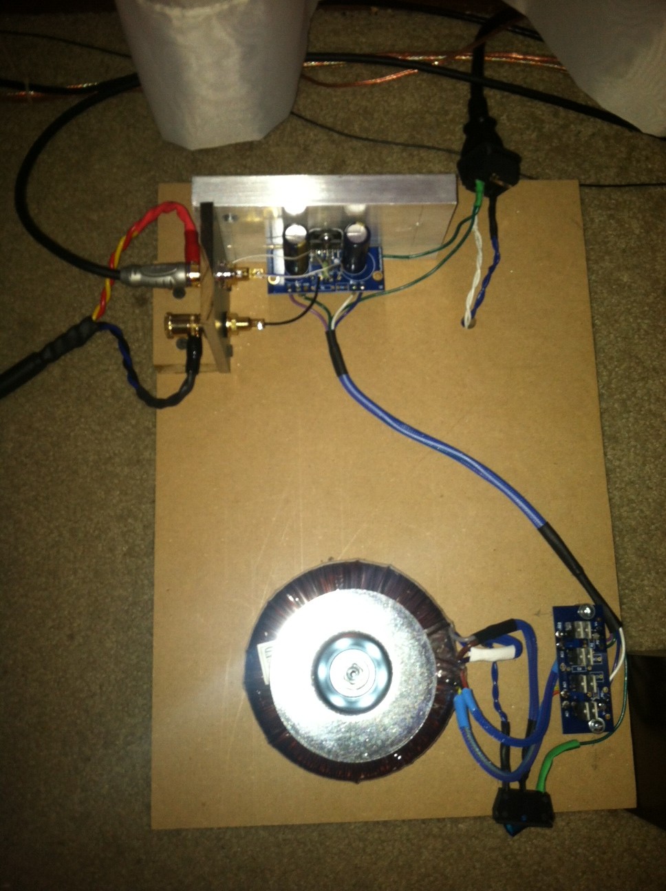

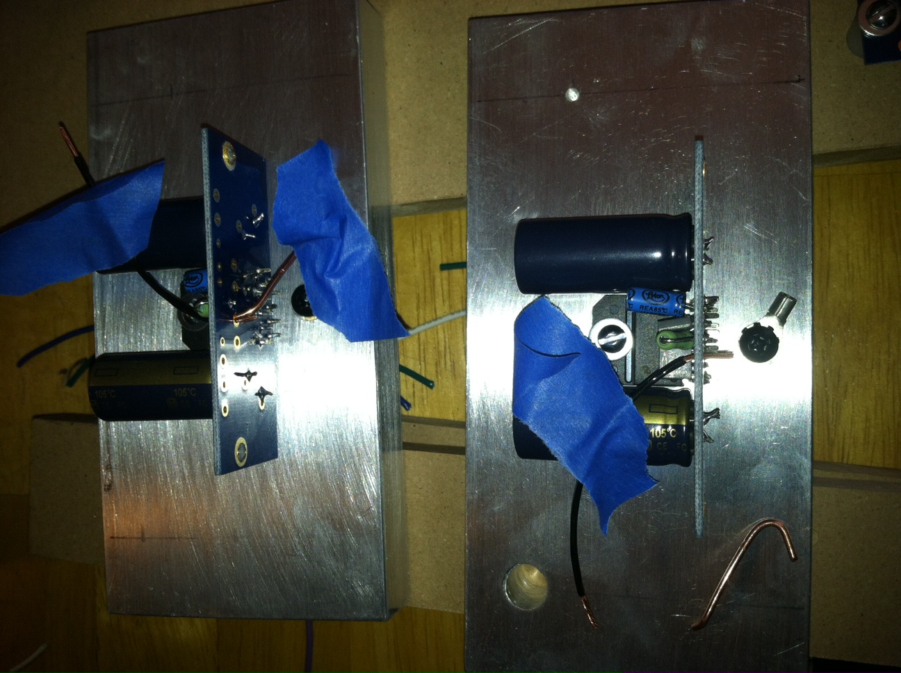

Hi guys,
Tell me if this makes sense. I have a theory of why I have a slight buzz. I don't think it is a ground loop problem, but please correct me if you think I'm wrong.
The theory is that the coupling capacitor that I put at input is a peice of junk, and not doing it's job, and the buzz sound I hear is a little DC coming from my preamp.
I say this because today I discovered that the buzz sound is only present when the RCA cable connects the amp to either my pre-amp or iPod. With the cable unpluged there is no buzz sound at the speaker.
Also, the reason I didn't hear the buzz last night with my "test speaker" is because they aren't efficient enough to play it. They are some very old Sanyo 3-way with 12" woofers that were given to me.
This is the crappy cap: 4.7uF 50V Radial Mini Electrolytic Capacitor 020-1204
One more thing: I think this also explains why the volume of the buzz seems to have decreased, it's because the cap is burning in a little
Here's some photos
Hi guys,

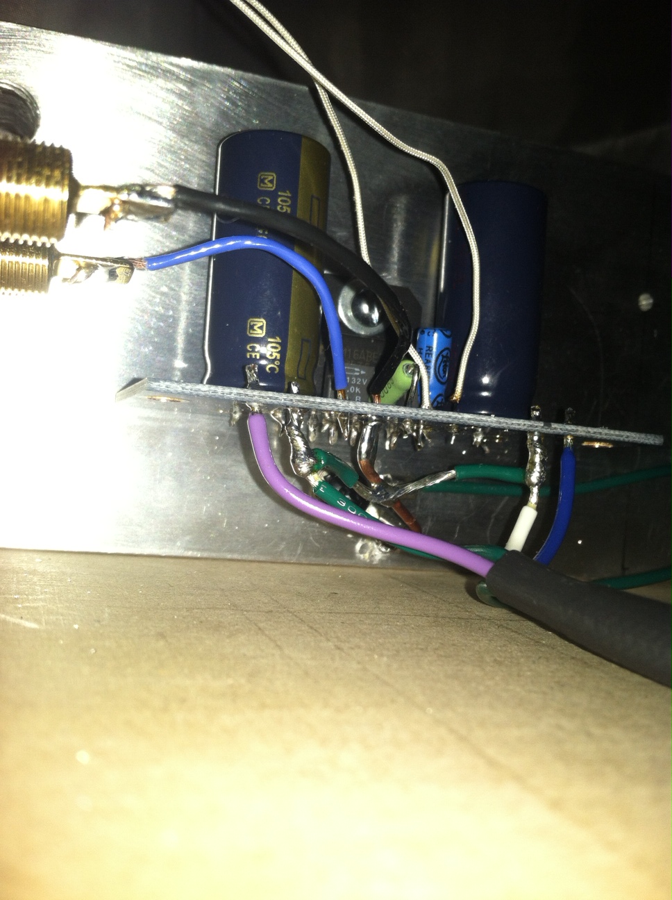

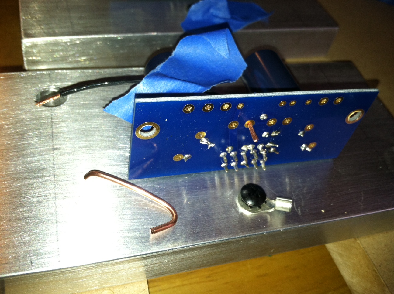

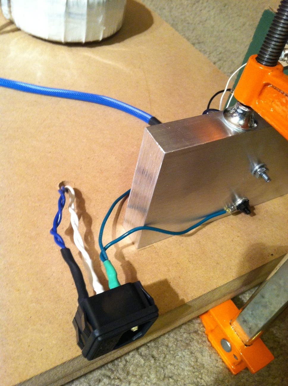

This is what I did to ground the thing. The solid copper wire is soldered to the OG of speaker on underside of board. PG+ / PG- are soldered to that. It is screwed to the chassis. Did I do it right?
You'll see my earth line that goes to chassis. I moved it from the back side of the heat sink, to screw it to the front side with the same screw that holds the end of my star ground wire. No apparent change in sound.
Thanks in advance for any comments. If you would also suggest to change out the input cap, can you tell me which one to get, and where to get it from. I had read to get electrolytic, and later read that I should use polyprop cap.

....This is the crappy cap: 4.7uF 50V Radial Mini Electrolytic Capacitor 020-1204
Not burning in.
The degraded dielectric is very gradually reforming as the AC & DC voltage across the electro is applied.
Instead. remove the electro and reform it properly until it achieves an in spec leakage current. Then put it back to work.
Or, throw the electro as far as you can and use a film cap as your DC blocking capacitor.
post27
I see no twisted pairs.
For every flow current there is an identical return current. That is what defines an electrical circuit.
Twist the flow and return pair to minimise loop area.
This reduces radiated interference. It also attenuates received interference.

Thanks AndrewT
"For every flow current, there is an identical return current"
Does this mean for V+ there should be an identical return PG+ ?
"Twist the flow and return area pair to minimise loop area"
Did I create a loop by having PG+ & PG- connect to BOTH the wire under the board coming from OG Speaker ground on the board AND the PG+ & PG- spots on the board? Is that what a "ground loop" is, when the ground comes through the board in two different places making a circle of the current? If that's it, I feel like a finally understand.
To ID wires in post 27, Purple and Blue are V+ and V-. White and Green and PG+ and PG-. So I should un-solder the White and Green from the board, and solder them only to the copper wire under the board, bringing the ground to ONE place, making the return current more identical to the flow current????
p.s. Does the sound of DC coming in through input, and the sound of Ground Loop problem sound the same?? I would describe this sound as what a guitar amp sounds like when there is no guitar plugged into the cord. It buzzes until the guitar is pluged in... my buzz isn't that loud, but that's the sound it makes.
Also... do I need to undo my sheethed wires that run from rectifier board to amp board, and twist blue and white together, and twist green and purple, so they will be twisted pairs of wires inside the sheethe??
I feel rather imature that I have blamed my problem on a bad capacitor. I only hear the buzz when a source is connected to the amp. (Without source connected there is no buzz in the speaker, does that have anything to do with wether or not we are talking about a ground problem here?)
I just know that ground problems seem to be common especially among us first time builders. I have tried a few different ways of grounding now. Results always the same.
Any suggestions appreciated. My thought is to try to rebuild the cord between amp board and powersupply board. (Does that seem like a good place to start?)
Also I feel that there should be some sort of testing that I should do, but I don't know what. I have a multimeter, but have only learned to measure DC offset at psu, and speakers. Shouldn't I be able to "proove" if I in fact have a ground problem, bad cap, etc. Again any suggestions appreciated.
-AlexQS

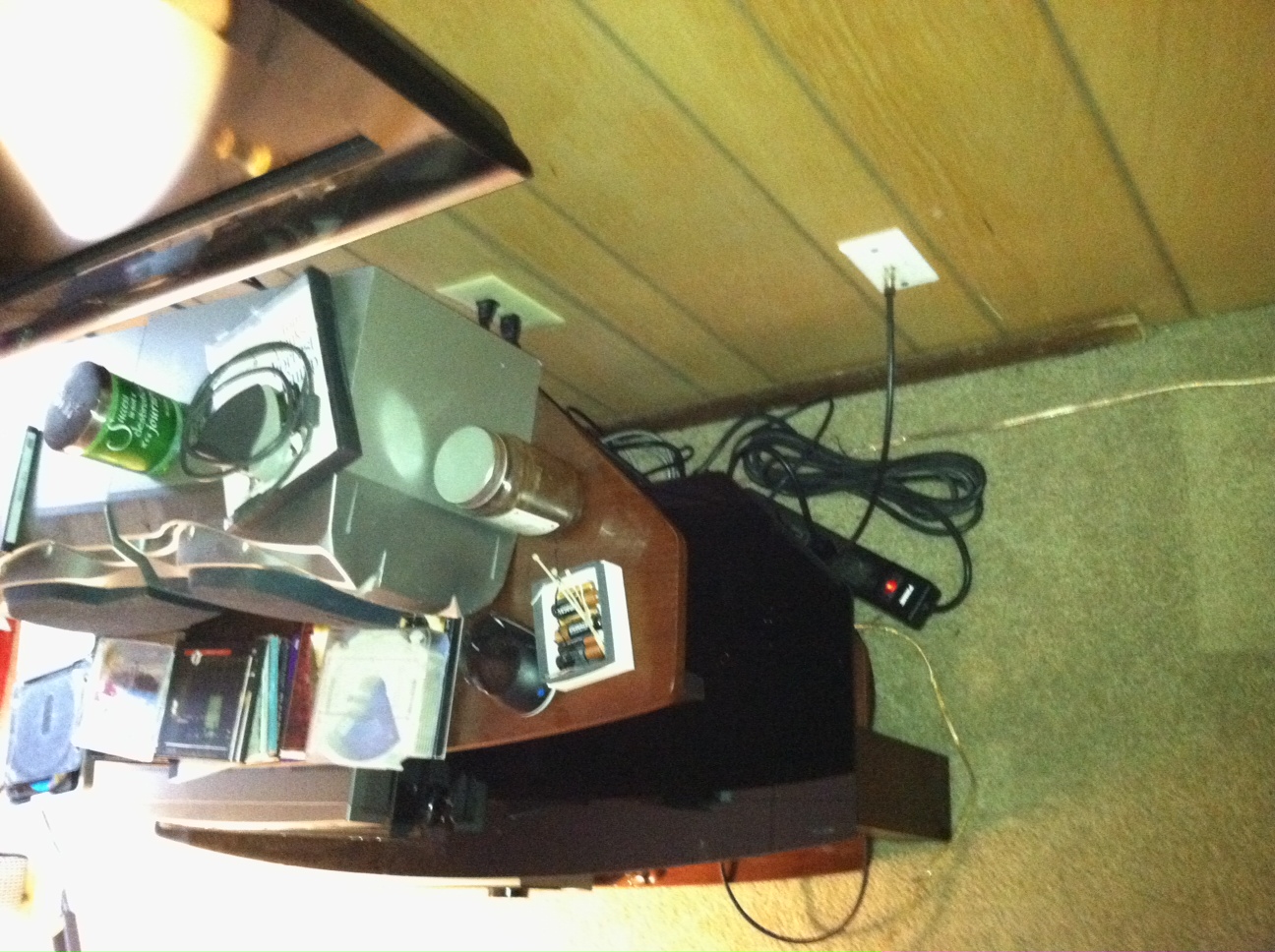

This may be way off the mark, but check your environment for big noise sources. I have a pair of BrianGt mono-blocks that are completely silent everywhere except in the room that has a dimable halogen lamp. I can hear the buzz change in both amount and frequency as I turn the rheostat. The amps have a thin metal cover and the wires between the PS and amps boards are less than an inch long. A Hafler stereo amp with a much thicker enclosure in the same location doesn't respond to the lamp - despite the fact that there are many wires as long as 8" inside the Hafler.
WOW! Excellent suggestion bcmbob.

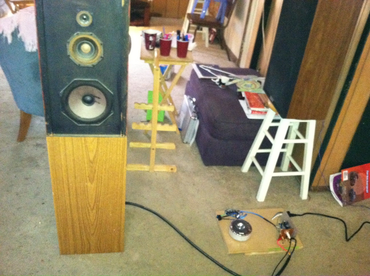

When I first started using a test-speaker and iPod there was no buzz. When I moved the amp to the front of the room by the real front speakers, I began to have problems, so used an extention cord to see if it was the wall outlet. No change.
Just now I moved the amp back to that physical location of the test speaker, plugged in with the iPod again, no buzz. OMG YAY!!!!!😛
Went and got my big speaker, dragged it over there, no buzz. Even better!!!
Apparently it is the physical location of the amp, because when it was up-front even the iPod source would make it buzz.
I think it's time to clean up the spaghetti garbage I have going on behind my entertainment center. I'll move the components 1 by one to the location where it is operating without a buzz. Hopefully I can figure out which component causes problems.
A shocking revelation to me. Perhaps a proper case would be in order (ya think?!) I truely hope the problem is not placing the amp in the vacinity of my receiver... if that's it then I have no pre-amp anymore

I know you guys like pictures, at least I do.
With speaker and amp in the middle of the room here (away from other electronics) the amp is dead quiet with my ear right next to the speaker.
With the amp and speaker on the floor right next to my TV Stand I have the problems.
I'm getting that cleaned up now!
By the way. I know it's not to difficult to beat my old amp, but this things blows it's doors off! These speakers were built by my Dad in the 1970's. Transmission-Line speakers aren't known for being efficient, and I thought that they might be a heavy load for LM3875 to perform at it's potential. I only have 10uF on each rail of power-supply, and the bass is so solid! Not overbearing, not boomy, still nice balance with mid & trebble,.... but the floor shakes now, and I don't have to turn up the volume as much to feel it! It would vibrate a little before, but this is a SOLID VIBRATION!! Solid is the word I'll use to describe the bass performance. -So happy!!
