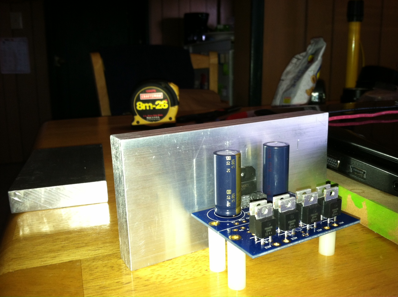

It seems that things are starting to come together here. Transformers arriving on Thursday hopefully. I chose two 330VA 25v + 25v 😀

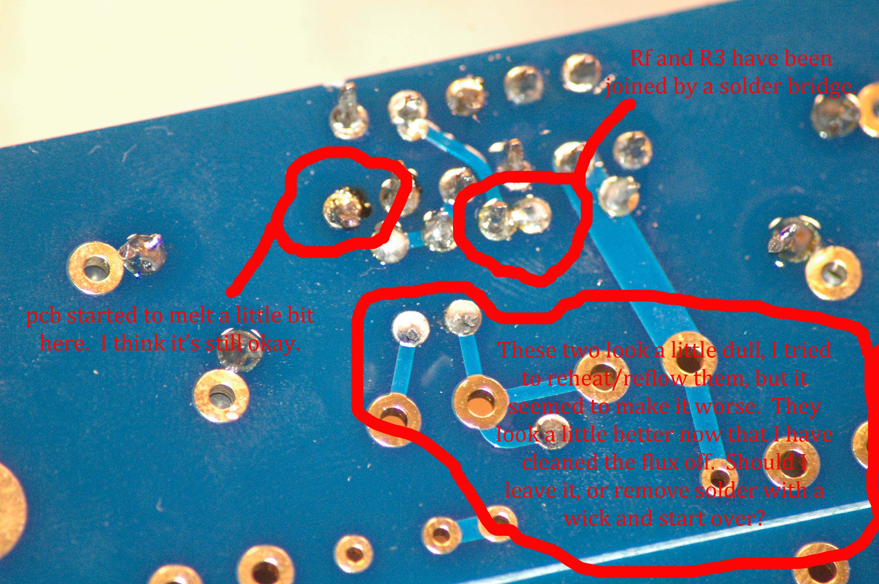

I practiced soldering with a radio-shack kit. After a little practice things were begining to look good.

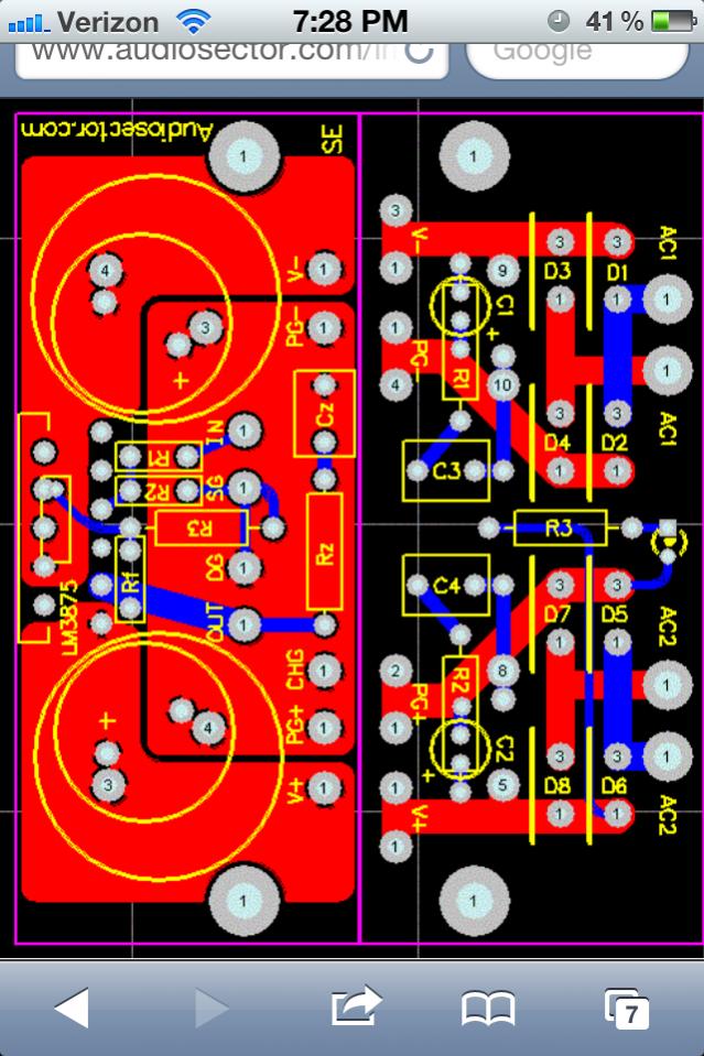

Then on the LM3875, my first couple of joints didn't turn out so well. They just look a little gritty and dull. It is difficult to photograph shiny things, but the others look mirror-chrome-like shiny, so that's good
I tried to reheat/reflow the two that look dull, it seemed to make it worse, so I stopped messing with it. They look a little better now that I have scrubbed off the rosin stuff, not too gritty anymore, but not as shiny as the rest. Should I remove the solder with a wick, and then start over?
There is one place that I have created a solder bridge, but I think that that part of Rf and R3 on the board are connected anyway, right?
Board around pin 11 on chip started to melt, but I don't think too bad. I don't think there is much I can do about it now.

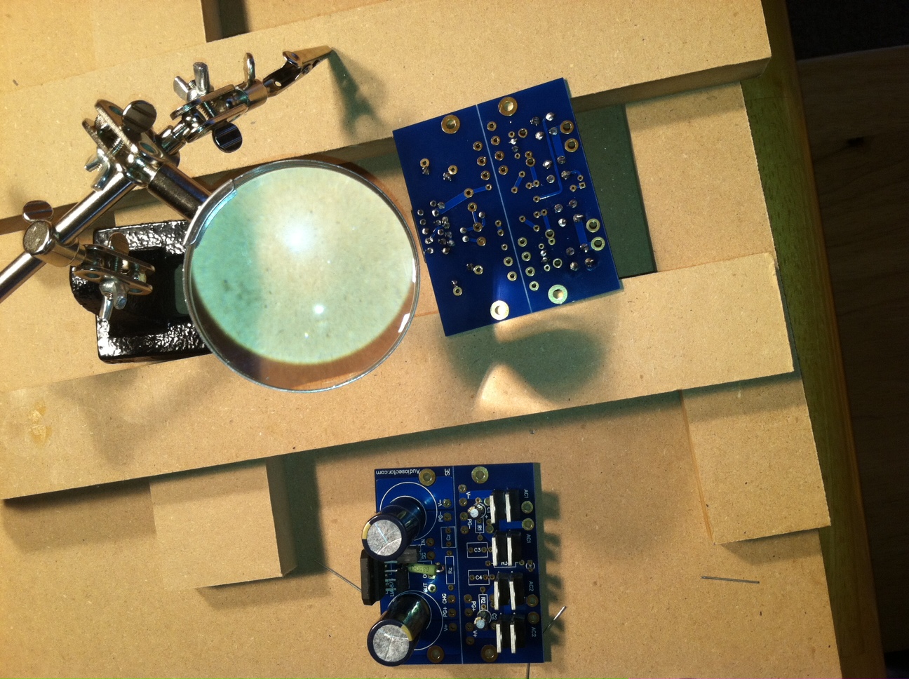

So here is a macro 1:2 photo. Be nice (and honest), it's a close up, and my first try after practicing with only a couple dozen or so LED's and resistors from Radio Shack.
p.s. I highly reccomend this little magnifying glass thing. My eyes are getting old, and this thing was only $4. Not highest quality, the arms are hard to lock into a position, but I only use the glass part anyway.

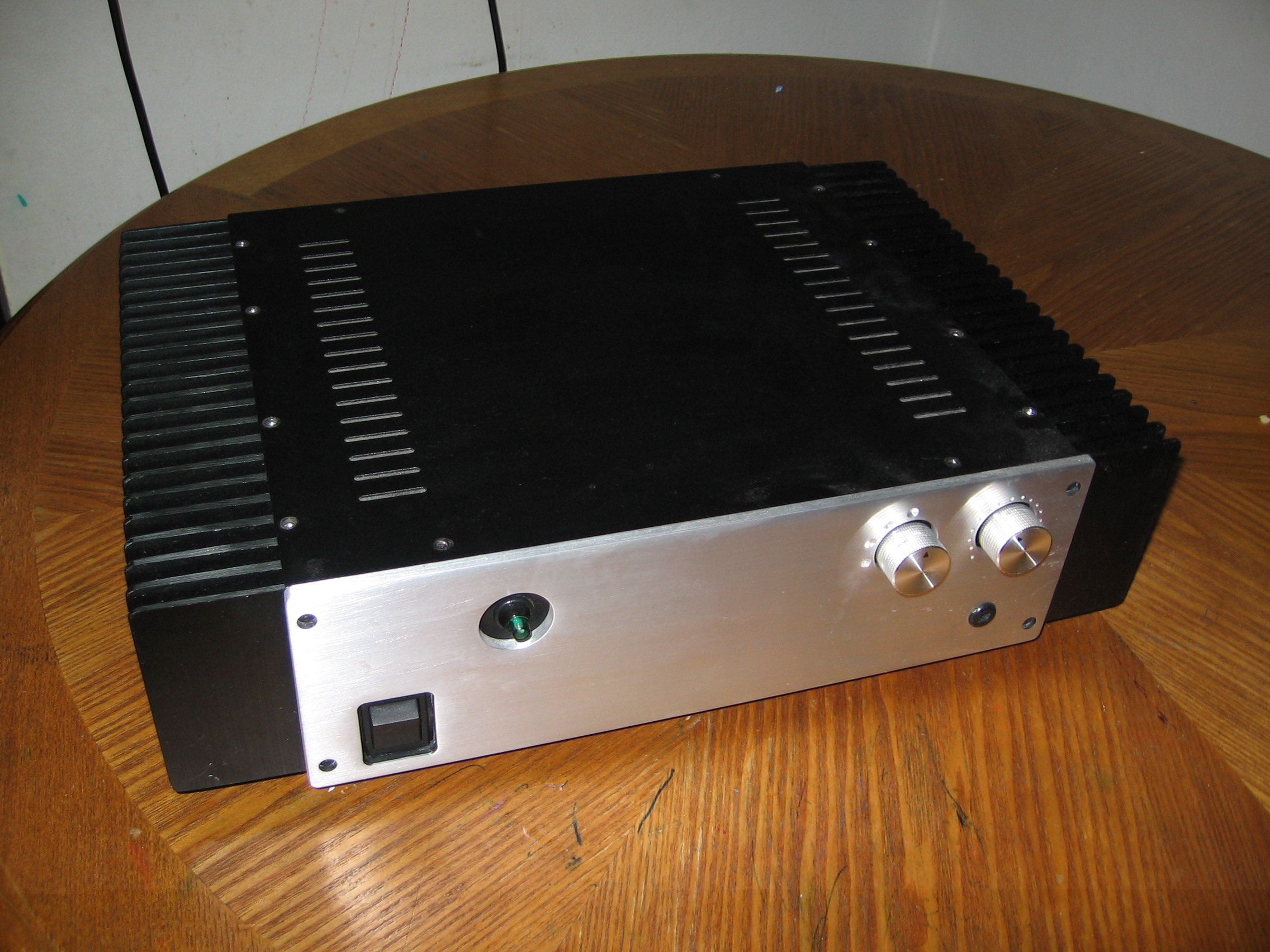

What kind of solder are you using? Any pics of the enclosure?
I also practiced with radioshack parts. Great idea!
No pics of enclosure yet.
AlexQS
Yes they appear to be connected on the board. (And from memory)
The burn around pin 11 looks like it might be just burnt rosin flux, which is a little more stubborn to clean. That's what it "looks" like from here.
The rest look good, I would visually recheck the rest and not subject the chip to anymore heat unless needed.

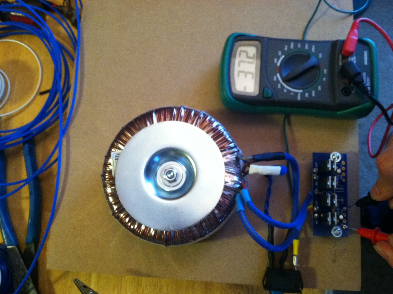

Wow, you really have chosen overkill with those transformers. That's fine and won't do any harm, but you are going to get about 44V on each rail from them. That is at, if not beyond, the limit of what a 3875 can take. Up on the limit is not a good place to be anyway, but it's worse in your case because it's hardly going to fall by much under load.
I would suggest that you have to lose some voltage somewhere. Two easy ways, both of which are nominal improvements, are to have two bridges - one for each half of the supply and possibly split the reservoir caps with a resistor. Otherwise I would suggest a regulated supply or at least a cap multiplier that can knock off a few volts and give you the proper voltage. The voltage you need will depend on the load of your loudspeakers but I would suspect that 37V is probably the sort of region you would need to be looking at for a general design with a 3875.
I doubt that the 3875 will blow on 88V unloaded (its absolute limit is supposed to be 84V) but you will need a proper sized heatsink to keep it out of trouble and stop its protection kicking in.
The other thing you could do is to "unwind" a few turns on the transformer. This is not to actually unwind them, but to wind reverse turns on each side so you get a lower voltage. To gauge how many turns just wind 20 turns around it, anywhere, and read off the voltage you get. Then, in the right direction, take a tap off the output, and backwind the unneeded turns.

@ Christian -I was hoping to be right around 37volts per rail, I read somewhere that is ideal. I don't know how to calculate it, but I think I should be close to that. I know many people go for a 300VA 22v + 22v. I am hoping to get a little more detail depth in the sound stage by being at a higher voltage. Mind you that I would never connect anything less than an 8 Ohm speaker.

25v times 1.4 = 35v, not 44
He's right on the money.

Apologies. I am absolutely wrong. I have two 300VA transformers here and thought they were both the same voltage (at 25V) and the supply I built was giving me +/- 44V. In fact that one is a 30V transformer (which I feel sure I never ordered).
Since one can never quite predict how these things turn out, forward V drops and losses etc. so never quite x root 2, I didn't bother to even do the mental arithmetic and just posted from experience.
So you will be fine. But get yourself a decent soldering iron. I use a Solomon ceramic station which is about £40 but they come under all sorts or names and one without a station can be had for about $12. Makes all the difference.

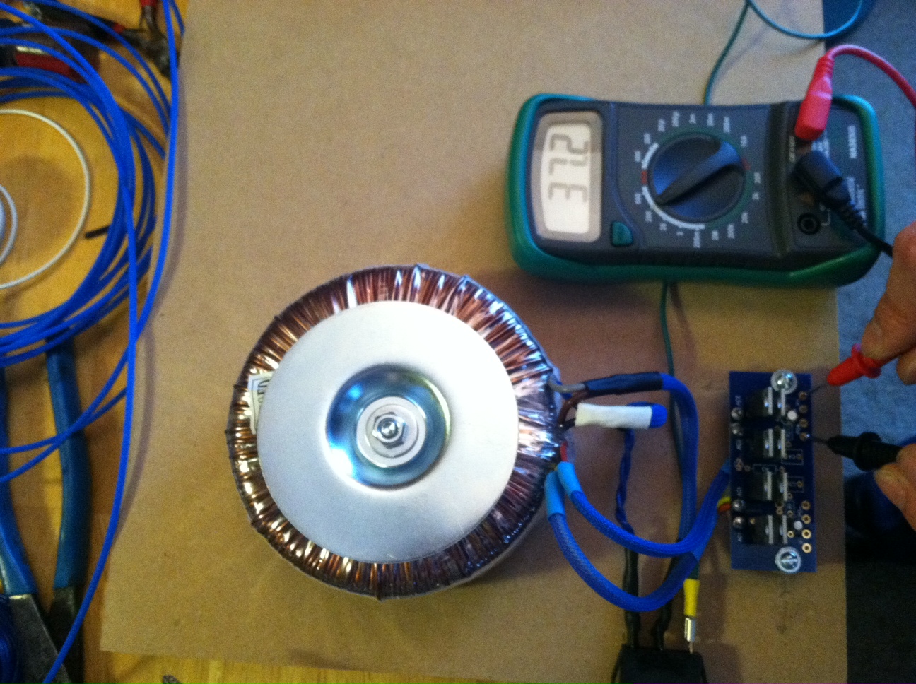

One working power supply
This is progressing slower than I thought. And my cool idea for chassis will come later, just a peice of wood to get this thing working first.
I think this is perfect! I had read somewhere that 37 volts is ideal; and that was my goal. Also I'm glad that V+ and V- are the same; I almost expected them to measure differently, but I believe they are the same because I omitted the diode from P.Daniels power-supply pcb. (???)
I used my start-up-test-lightbulb in series with live mains that I made. It did not light up at all.
At first I was not getting any reading with voltage meeter, I began to feel upset, then I realized I had forgoten to install the fuse in the IEC powerjack. 🙂
Yay it works!!!😀
