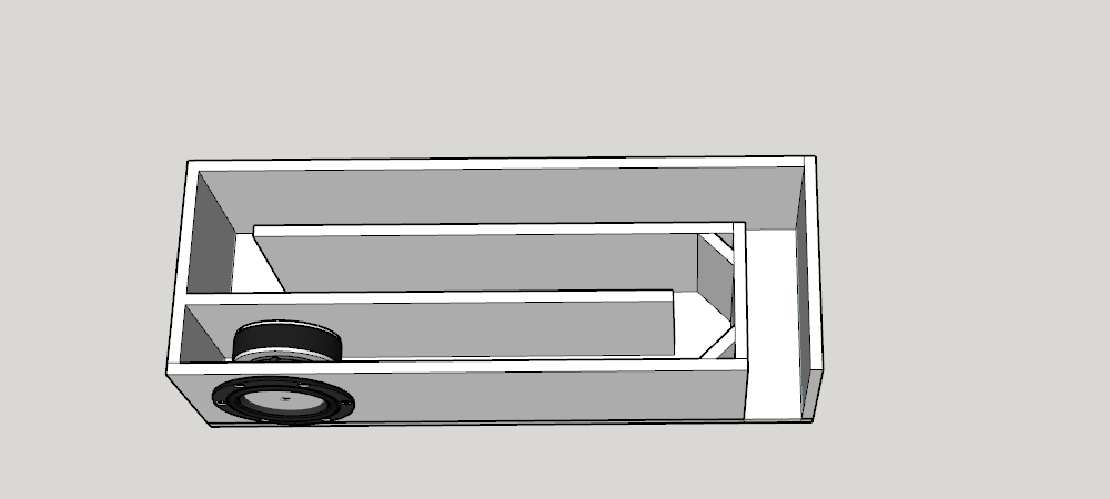

The Highs and Mids Enclosure is modelled after a Folded Voight Tube
with the Highs having a seperate airspace.
Will be building 2 of these long term.
The Lows are housed in a T-Line Box

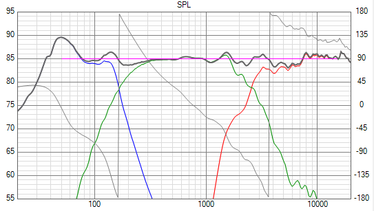

I designed my Crossover(s) in Vituix with guidance from KirbyMeetsAudio's Video
Here's a photo of the overall frequency response + Diagram/Blueprint

I got the Mids/Highs Folded Voight Tube:
Sub T-line Enclosure:
SPL Graph with all Drivers active:

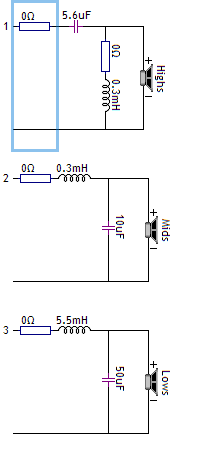

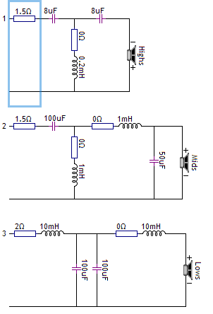

And the Crossover Schematic:

Handful of initial thoughts in no particular order...
(I'm pretty ignorant on TL's and Voight pipes so I'm not qualified to make any comment at all about them, these are pretty much just generic crossover design points only...)

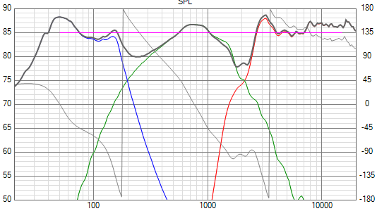

You have no highpass for the mids - that will likely result in overdriving them and at least increasing distortion if not burning them out as you're effectively exposing them to the full bass content of the signal.
Your bass/mid crossover is very low - I know that that Dayton LF does recommend a low XO, but it results in the mid doing a lot of work (even with a highpass added) and requires very large component values - these are likely to be very big and expensive.
Taking those together, you may realise why it's quite common to use an active crossover and biamp if you definitely need to cross that low.
You appear (though I'm not sure what software you modelled the crossover in) to have included no DC Resistance for the inductors - that won't be the case in reality and should be modelled using realistic values before going further. This is especially relevant if you do go ahead with a passive low/mid crossover that low as the low pass inductor for the woofer will have the highest DCR.
Can't tell if you've included the effects of baffle step loss & diffraction in your models or not - looking at how the mid stays flat through its lower range I suspect not. In fact, it looks like you've used the basic FRD from PE/Dayton for the modelling - that means you may not be accounting for any effect the mid enclosure has on its response either. (Unless the Voight pipe guarantees that there is no effect at all on the response, as I said above I admit I'm ignorant on that?)
Also can't tell if you've generated those component values accounting for the impedance of the drivers or not?

And yeah I'm not too sure on the science on the folded Voight tube, there was a calculator somewhere that I plugged the Mids Sd and Fs into and it spat out the dimensions I needed.
The T-line is however all my maths (god kill me) so the internal wave from the sub is in phase once it leaves the port so that "should" be all good.

You'll still have to simulate, and the aims will be the same. I have a suggestion for your sim. Can you set targets? Your drivers are staying in, out of band and interfering with the others. I assume this is of concern as you must have crossed them out for a reason.

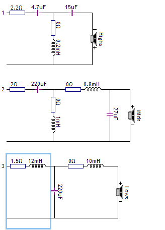

ok so I redesigned the crossover after Davids input and this is what I got at the moment.
This setup is much more expensive mainly cause the 100uF Caps are like $40usd each but fingers crossed you guys can help me be more cost effective.
what I took into consideration during the design:
Highs Effective Range is 2,500-20,000hz
Crosses with Mids at 2,200hz
100% low fade out at 1100hz
High pass filter
Mids Effective Range is 65-5,500hz
Crosses with Lows at 200hz
100% low fade out at 72hz
100% high fade out at 5800hz
High & Low pass filters
Lows Effective Range is 30-200hz
100% High fade out at 450hz

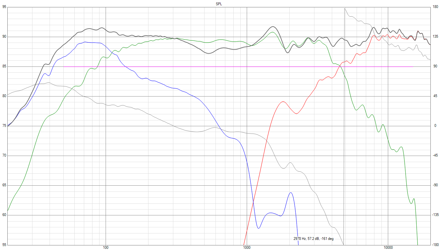

Here's the revised SPL graph (does the dip at 2,000hz where the mids/high cross matter too much?)
and the revised Crossover (needs tweaking to be more cost effective)
Overall with this revision all drivers are within or very close to their usable frequency according to their spec sheets.
May be worth downloading Boxsim 2.0, this has an optimise function that does a half decent job of calculating the values once you get halfway there I.e. an initial starting point that is close.
Also worth checking the mid polarity, from the spl and those dips it looks like either the crossover points are too far apart on the roll offs or you have the mid at the wrong polarity.
I’m no expert but may be worth swapping the mid and tweeter polarities to get the crossover points adding not cancelling, only 4 options so worth checking which works best. Also iirc at the crossover points each driver should be at 6db down, yours look more like 10db which may be a reason for the dips, and I think you will hear dips that big, a dip of 3dB halves the energy getting to your ear so is very much perceptible.
Ok so here's where I'm up to,
I smoothed out the SPL Graph to get rid of the dips and made sure the crossover points are approx 6db down as Ugg10 mentioned.

Anyway here's the current SPL Graph and Crossover:

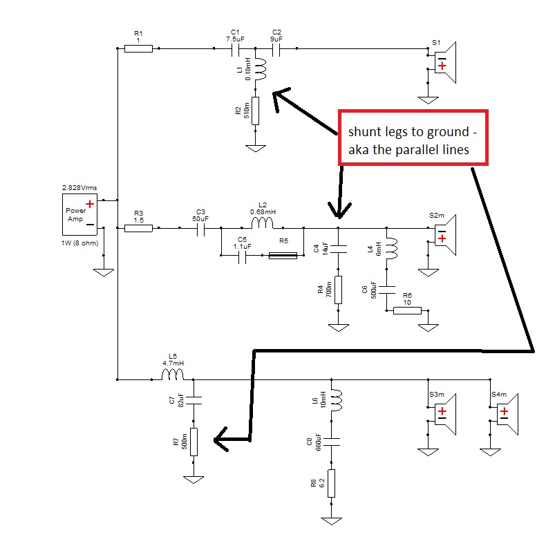

In your xo sims:
- you may be able to get away with just 2nd order electric on the woofer
- you must look at the individual driver phase not the overall system phase and then try to get good alignment between them in the 2 xo regions
- also try some resistors in the shunt to ground leg to both shape the knee of the rolloff and to manipulate individual driver phase. Not always necessary but it can be extremely helpful and costs you pretty much nothing.

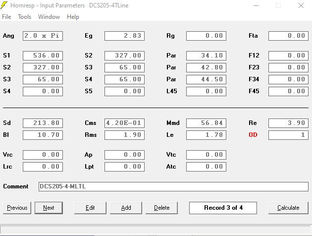

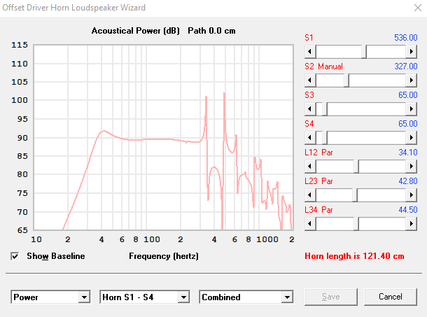

I'm redoing all the enclosures since a couple of you guys mentioned that I have no simulations on how the drivers would behave in XYZ enclosure and the issue I came up with is there's bugger all programs that Properly simulate TL enclosures soooo I scrapped it. .
I'm Designing the Sub-woofer Enclosure after Brian Steele's Boom Unit which actually uses the same Driver as I chose (wooo I'm Lazy!.. Kinda), I changed some stuff for my one but its about 80% Identical to his.
besides I'm pretty sure he goofed some T/S values when putting it into Hornresp.
Here's the Hornresp Stuff for people who are interested.

A picture might help. See attached (just some random 3-way I had saved).
Note the added resistors in the parallel legs as well. To see their effects, just add them to your modelling efforts and see what they do and whether or not they might be helpful in your situation.
Is the phase fine or does it "seem" fine. Maybe attach a pic with the individual driver phase so we can confirm their adequacy or not.
Still you have not mentioned whether you are including baffle effects and acoustic center info? Again, these are vitally important for accurate simming.
I also noticed the very large resistance on your woofer inductor. Lower that if you can by going with an iron core inductor instead of an air core. Quite a difference in cost and size as well.
