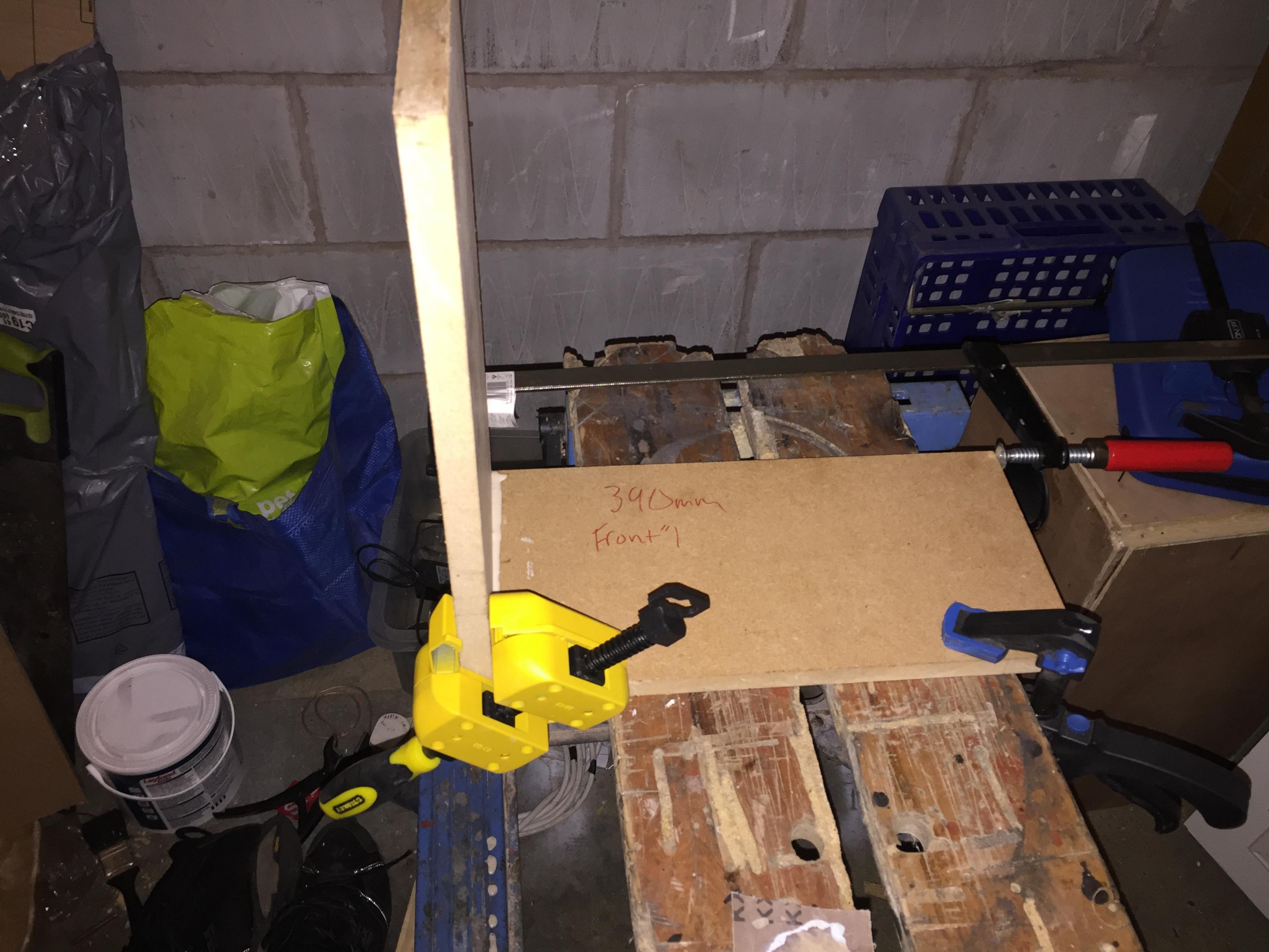

so tonight i am starting to make volvotreter Tangband Double folded tapped horn This is my first (proper) build so any help along the way would be appreciated .
So i got my panels today after waiting 3 long weeks,
and after paying an extortionate amount (i found this out well to late :mad: )
So here i go first panel glued and clamped....
Iv bought a Mivoc 80 plate amp to power the sub . it JUST fits into the back panel with nothing to spare, Will installing this mess with the sound quality ? it is going to take up a fair amount of space in the rear chamber.
Anyways ill keep you guys posted on how its going if anyone is intrested to know. Got a long weekend off work and cant think of a better way to spend it ! :D:D
I have just finished the glueing stage of the cabinet . i put the plate amp in the back and ill have to agree with you on putting it somewhere else , there is barely any room for the air to move past the crossover . how badly do you think it will effect the sound ?. i'm not the best at cutting panels accurately.
Think i'm going to do a test fire just clamping the side panel on to see what it sounds like
