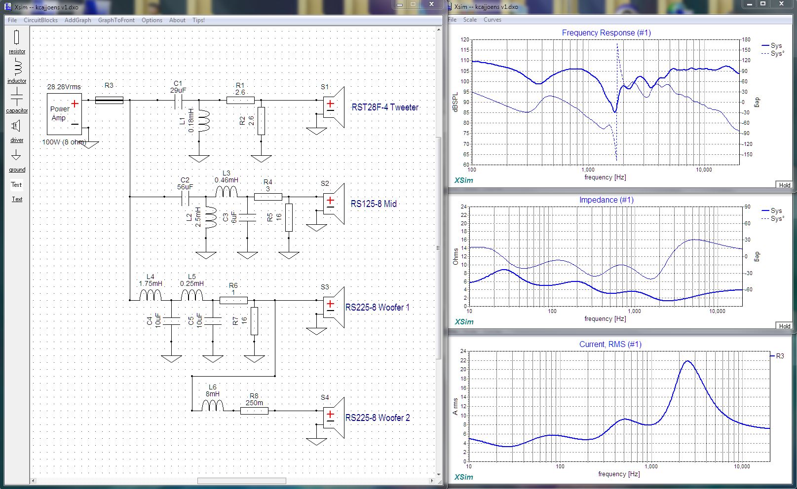

So I've investigated a bit more and changed my speaker selection:
Tweeter: Dayton Audio RST28F-4 1-1/8"
Midrange: Dayton Audio RS125-8 5"
Bass: 2 x Dayton Audio RS225-8 8"
I've also been playing around with VituixCAD and wondered if what I'm doing looks correct.

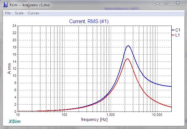

Okay ... transferring your crossover design to XSim I got the result in the thumbnail. Sorry to say, it's not very good.
If you look at the current panel you will see that almost no energy is going to the woofers and in the mid and tweeter ranges it is drawing and exorbitant amount of current... close to 20 amps. I've set the amplifier to 100 watts and at that level we should see no more than 3.5 amps of current at 8 ohms, or 5 amps at 4 ohms or we risk overheating and possibly killing the amplifier.
There is a really handy calculator you can use to find the voltages and currents HERE
I appreciate this is your first attempt and, given that, you didn't do all that bad. For certain I've seen far worse. Your design tells me that you really don't understand the parts or what they do... so, time to learn...
What I suggest is that you install XSim (download the setup.exe file), learn your way round the menus and dialogs a little bit then download and mess with the TestJig.dxo file I've uploaded. Change the capacitor's part values and get a feel for what they do. Then replace the capacitors with coils and get a feel for what they do. These two parts are the basis of all crossover design. Their behaviour never changes, so it's all in the way you use them.
Then look up a few very basic designs starting with a 1st order 2 way. Copy them into XSim using the default drivers (which are dummy loads) play with the parts values and get a sense of what they do and how they work together. Then move up to 2nd order and get a feel for them... and so on.
Trust me.. a 3 1/2 way crossover is a huge design effort. Even with a solid background in electronics, I would find it rather daunting. So it's wise to spend a bit of time learning before doing...

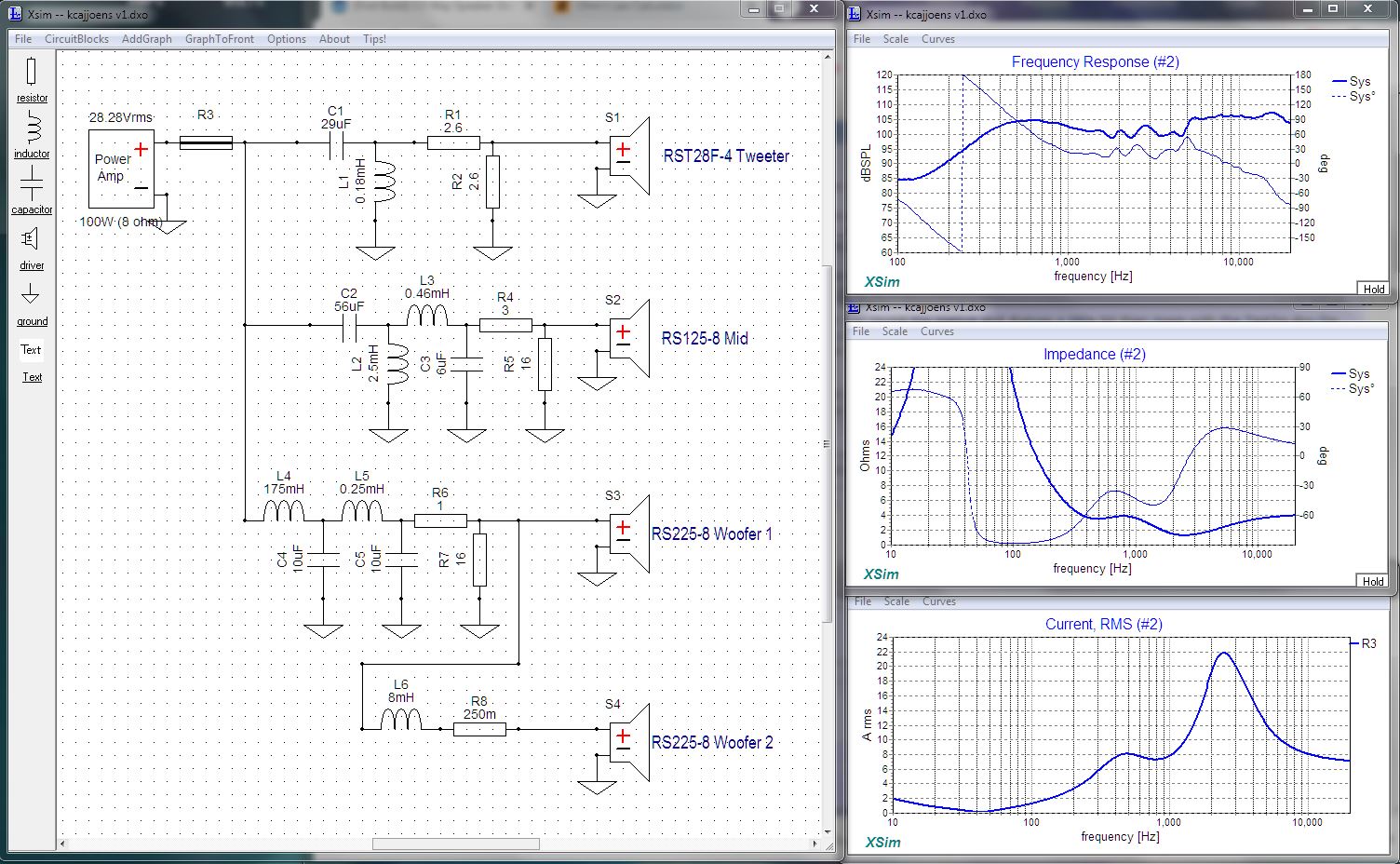

First off, that is a more appropriate choice for the mid. The only concern is that it has enough SPL to match 2 of your woofers in parallel after baffle step loss has been accounted for which I think it does, but just barely. Both drivers' sensitivity are about 87dB so there won't be a lot of wiggle room if you want to raise the SPL of the mids.
Re your xo, it has a couple of problems beyond what Douglas pointed out:
- padding down the woofers is generally a no-no. It's just a total and unnecessary waste of power.
- driver phase needs to be aligned in the 2 xo regions. With a 3-way, it is often necessary to revers the polarity on the mid and/or the tweeter to do so. Changing the electrical order of the filter may also help in this regard too. Frequently, in a set-up like this, the tweeter will need to be 3rd order electrical when the mid and woofers are 2nd order.
- so without doing the sims myself, I'm pretty sure that 4th order on the woofers is totally unnecessary.
- impedance looks like it is way too low, below 2ohm at about 3000Hz. This will be your 1st indication that you've got potential problems for your amplifier. Looking at current consumption will tell you more about that vis-a-vis each component. I also don't see the impedance peak for the woofers. That tells me that there might be something wrong with the zma files you imported.

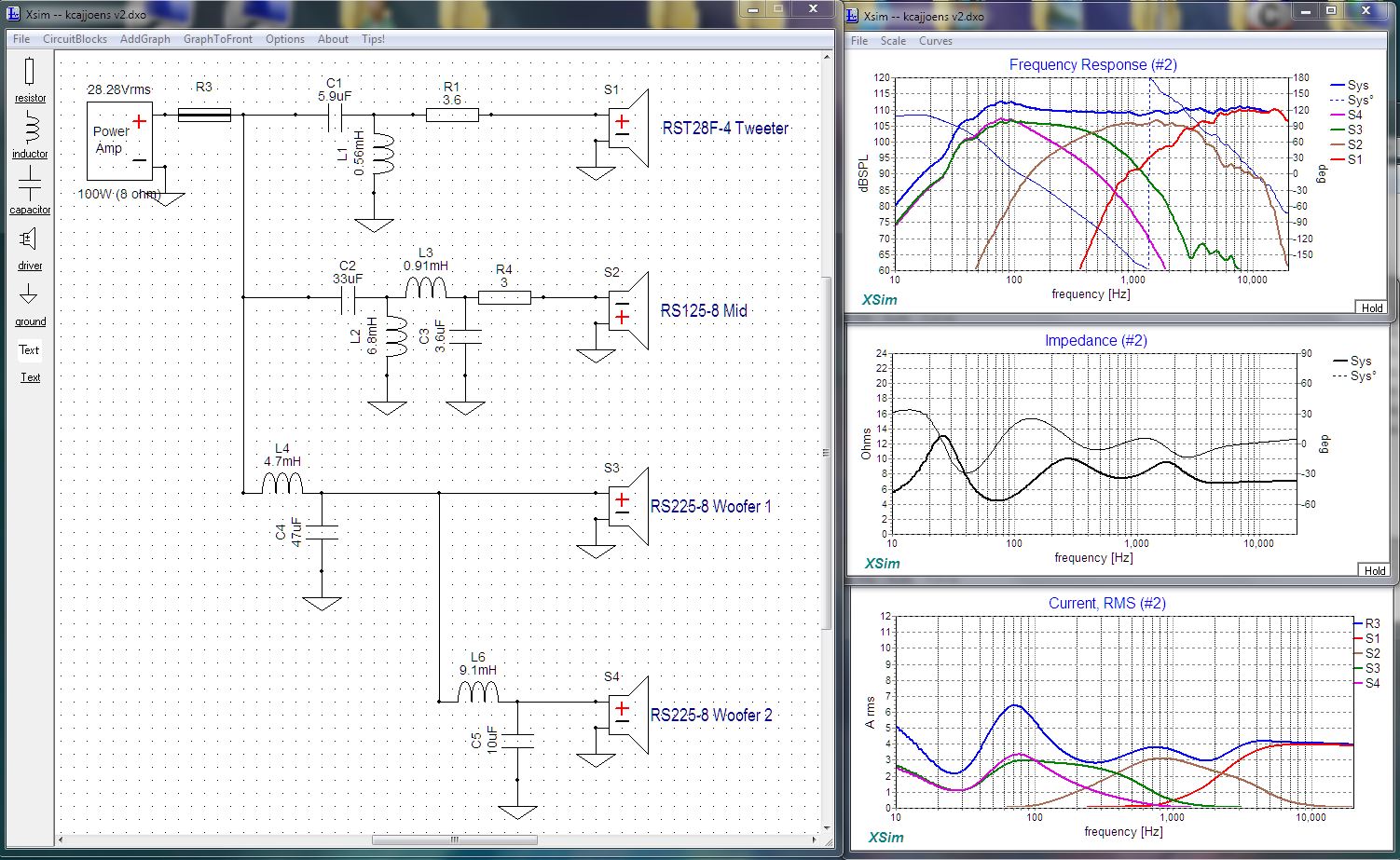

Here are some further suggestions:
- Drop the 3 1/2-way design. It isn't absolutely needed and it will only add more complexity to what is already a complex task for a beginner. Just go with a standard 3-way.
- Start by setting some design goals for the xo. With these well behaved drivers, I would target 300-500Hz and 2000-3000Hz as the xo points and see no reason to use anything but 2nd order acoustic slopes. Note that the order of the acoustic slope doesn't necessarily require the same electrical order. I don't know if VCAD includes target slopes but starting with these is very, very helpful for beginners. Use LR2 if you can find them.
- A couple of the biggest rookie mistakes are failing to include the acoustic centers of the drivers, the y off-set in VCAD I think (you need to include the x and y coordinates as well if you haven't) and then failing to extract minimum phase from your drivers too.
- any xo sim is only as good as the files you are inputting into the program so it may help if you attach your files so we can take a closer look at them or if you explain the process of how you got them. I can't tell if you have included baffle diffraction effects for eg, and I'm pretty sure that you haven't included any box effects. In a 2-way design you can kind of get away without that latter item but in a 3-way, with the woofer xo much closer to its resonance peaks, it can make a bit of a difference.
- I don't know if this should be self evident or not but your target for the summed response should be relatively flat. Plus or minus 3dB is a general standard. Less is even better.
- start your sims with the woofers. Look at about the 200Hz SPL level - that will be your target SPL for your design. It should be pretty close to 87dB. Bring the rest of the woofer response down to that level, shaped to match an LR2 target curve at about 400Hz and then continue moving up the driver chain from there. Try to match the driver phase in the xo regions as well.
- at a minimum, if you tell us your front baffle dimensions and positions of the drivers, we can do up our own sims to check out the validity of what you are doing. Also, sealed or vented?
In the V2 workup I just posted I was targeting 500 and 2500 ... seemed like the most sensible points. I'll let you run with it from there...
I did not enter them in the V2 ... I know they're important, but don't have the measurements.

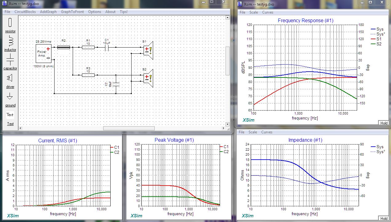

What I'm missing here is why the tweeter is drawing all the power?
Every part you connect in shunt mode ... to ground... is going to waste some power. So the big trick is to always let the first series part in any chain (C1 in this case) do as much of the work as you can. Any shunt parts should be used only for fine tuning.
The thumbnail shows the problem ... C1 was way too big, L1 way too small so most of the power coming through C1 was being shunted to ground by L1 and never getting to the tweeter...
Is that still the case despite the error in your original xsim file?
Laughably, once I corrected the error it got worse...
Also, how do I get the graph showing power RMS, I can't seem to find it?
In the main window, click on "add graph" in the menu, then more... there are several very useful graphs hidden there... including the RMS current one.
Now let me explain that the current graph is basically messed up. It only resolves down to 1 amp steps. So the only way to get readings that are meaningful from it is to jack up the amplifier power with the Tune dialog. I typically use 100 watts. Now this has nothing to do with your amplifier or your drivers, it's just to get more "scale" on the extra windows.
I also add that extra resistor, which is shorted, right at the amplifier's output simply as a measuring tool to see the total current being drawn.
