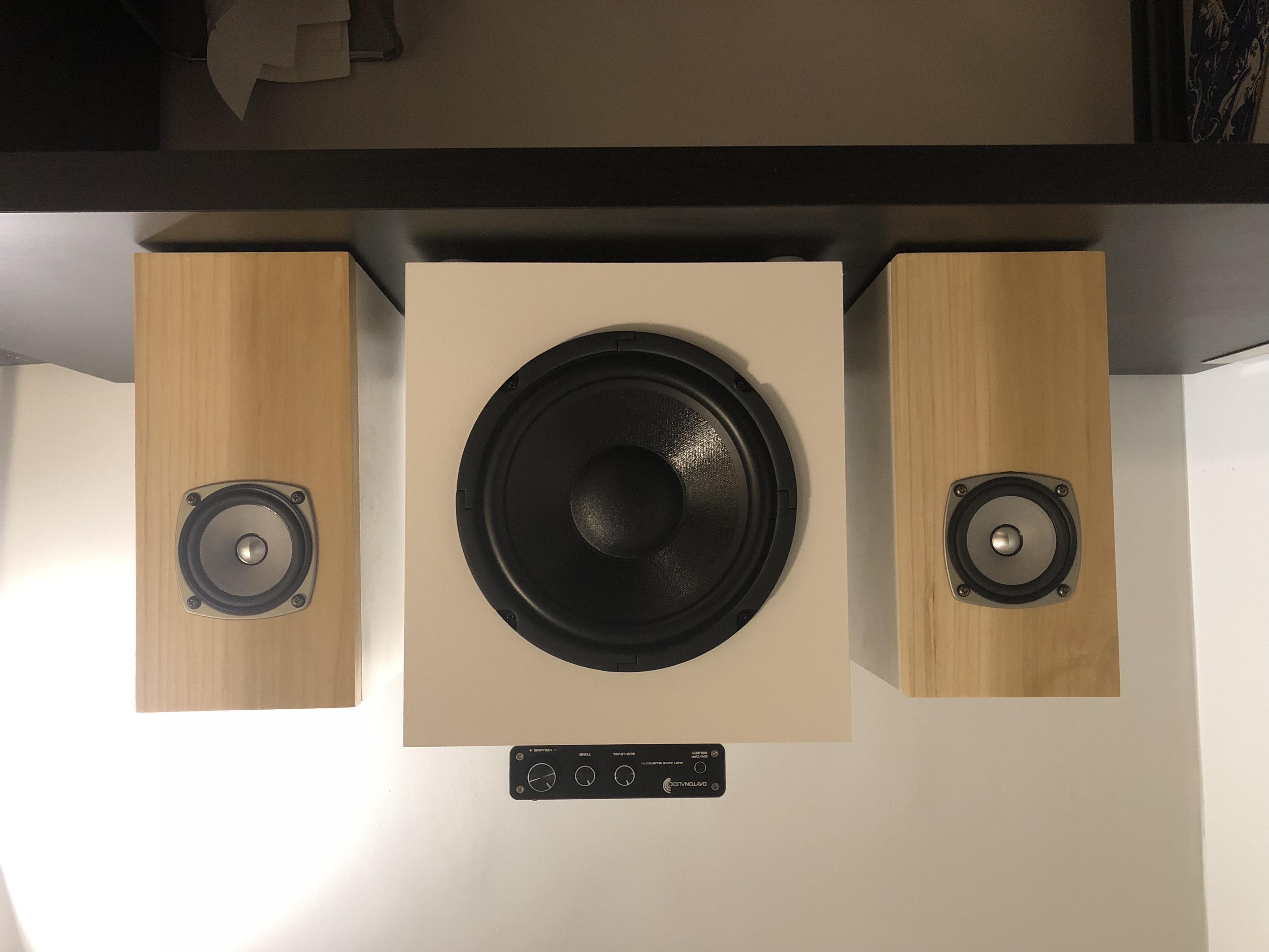

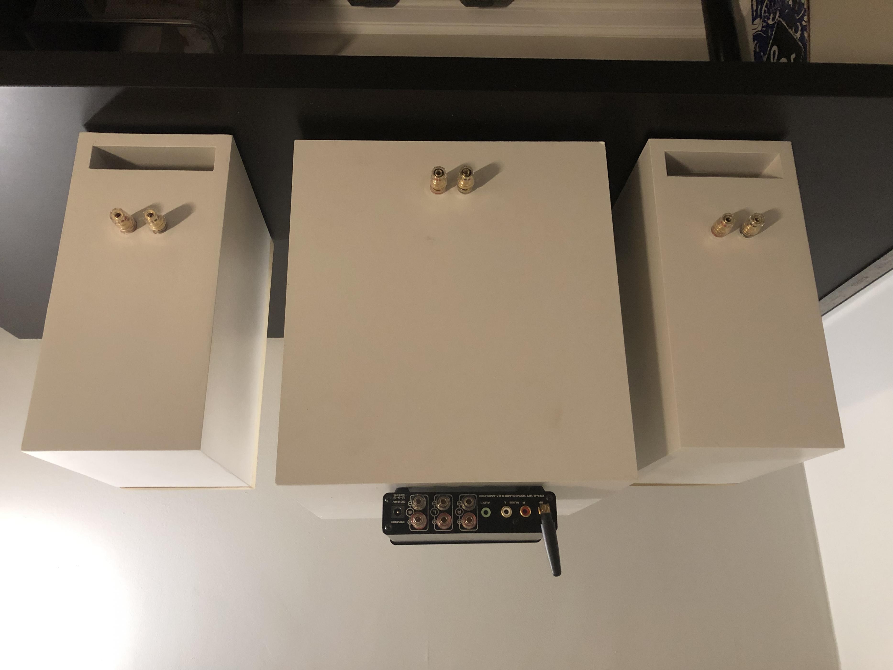

Thanks for the advice on the Dayton DC200 8”. I went with a sealed enclosure to keep a small footprint. Went with the Dayton suggested 0.46 cu ft. It’s passive as I’m using the DTA-2.1BT with powered sub output. Very please and really fills out the bass. Great combo for what I spent building these.
