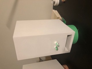

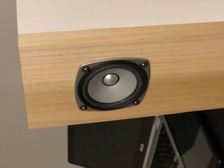

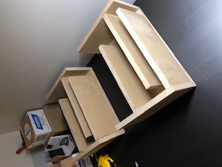

First time post and speaker build. Modified the Lance TL speaker design. Wanted a full wood front. Wow. These sound insanely good. Thank you to the OP for the plans. Some pics below.

Thank you. Curious to find plans for a small 8” passive sub for use with these. Looking at using with the Dayton DTA-2.1BT which has a passive sub output. Not looking to shake the house but a little more tight bass would be great with these.
Beautiful. But why did you make a TL because the only purpose of a TL is to get bass? Perhaps there's another driver better for your goals.Curious to find plans for a small 8” passive sub for use with these... which has a passive sub output. Not looking to shake the house but a little more tight bass would be great with these.
B.
Good point. They do have bass. But, greedy me wanted to see more. Don’t get me wrong they sound great. 🙂
...because the only purpose of a TL is to get bass?
The answer to that question is no.
dave
Since when?
People tend to build these smaller 3" driver boxes for computer desktop use due to the smaller footprint. More bass requires a larger driver in a bigger box with a larger footprint. The newer 11MS should be close to ideal if you can tolerate a larger box. A Classic Golden Ratio cabinet should be a good choice assuming it exists. This driver is very new and available only in some areas. This will of course change.
