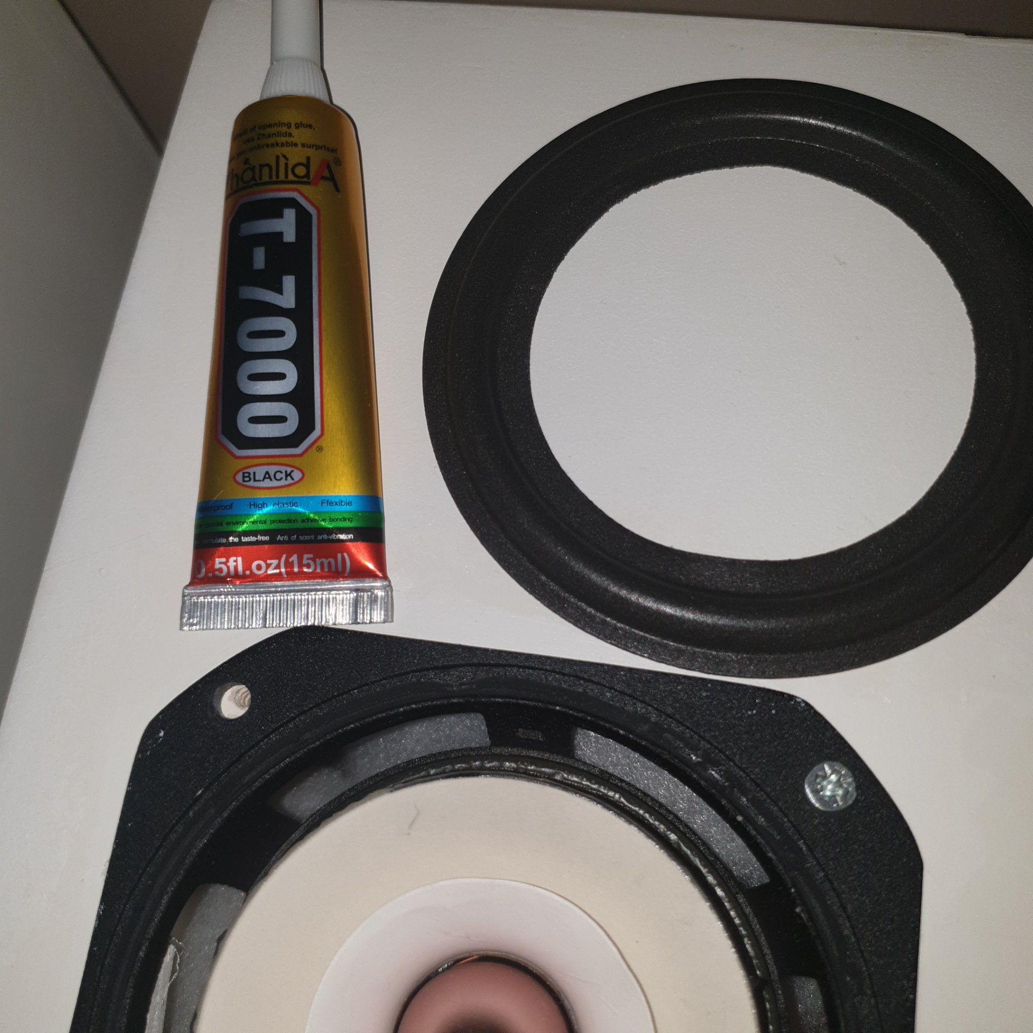

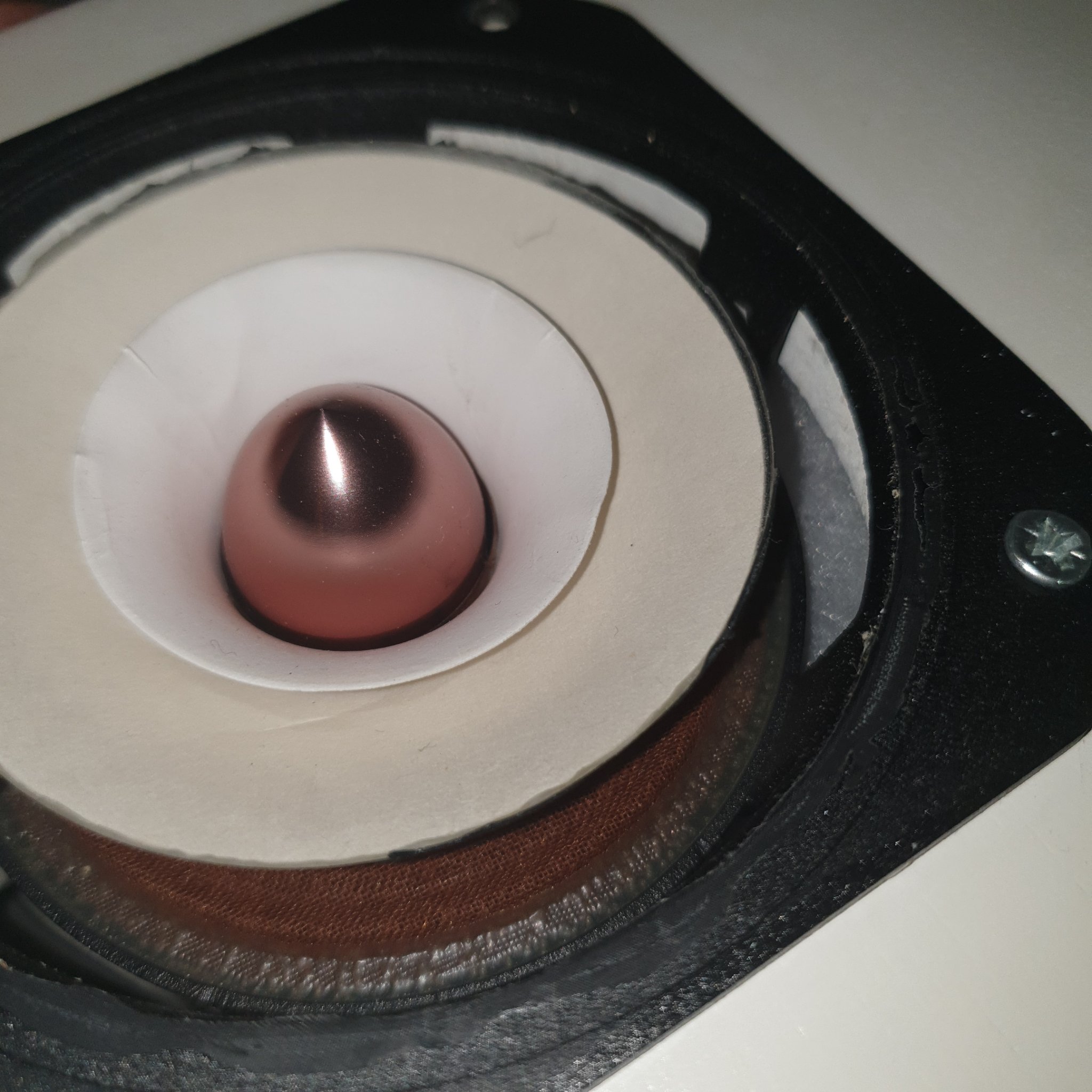

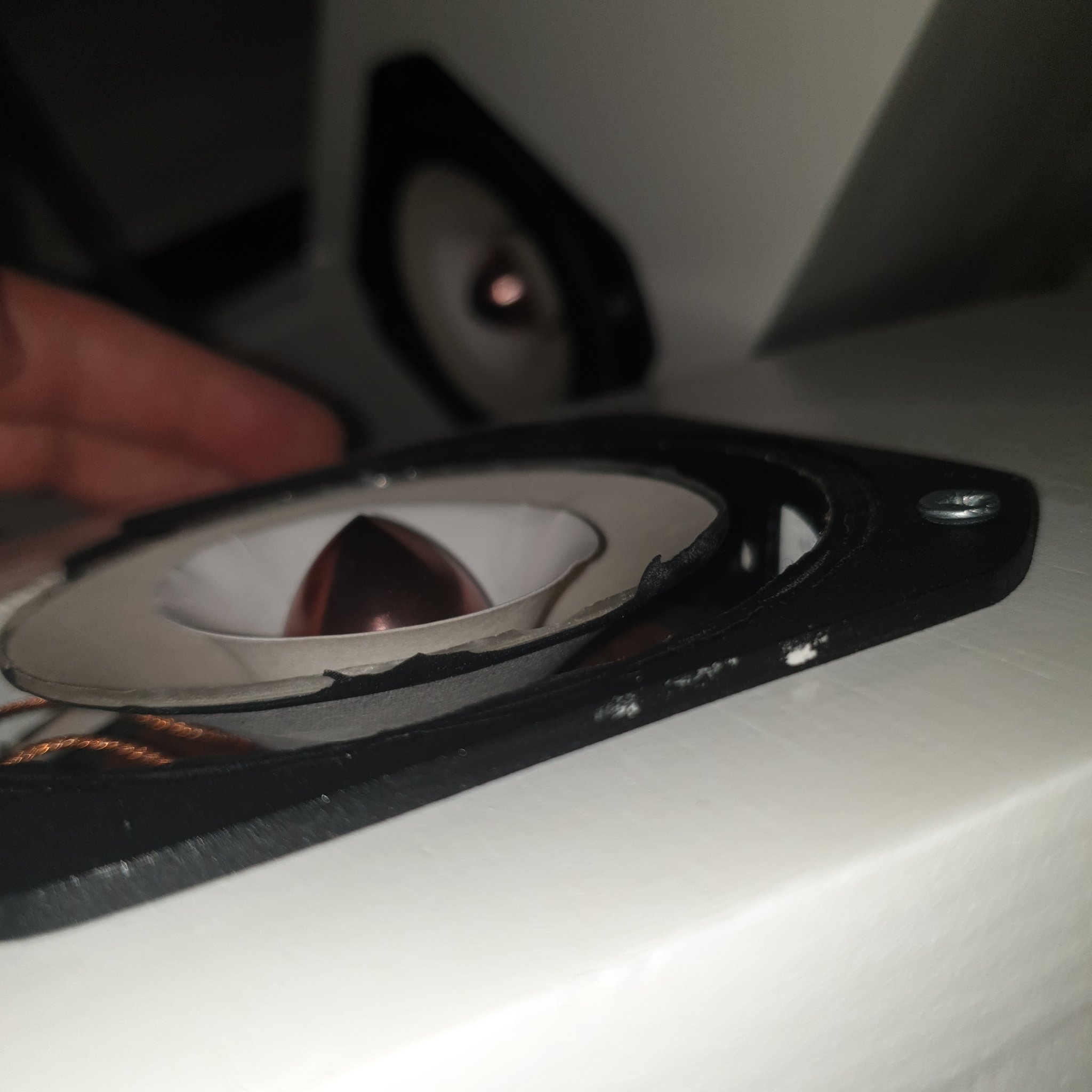

Hello! It is my firs attempt too. I bought another 4 inch full range speakers from China but I think old ones sounded better so I decided to foam them. I could find polyurethane edges instead of original rubber ones in my country. There is residuals in the back of the cone and I should clean them but it seems residual rubber is a bit strong. So should I use alcohol or acethone and box cutter knife? I don't want to damage the cone.

Hi Umut... is there residue on the back of the cone because the surround was stuck on the back of the cone rather than in front? If so, in my experience it's very difficult to remove without damaging the cone.
I repaired a pair of Denon woofers (nothing special) that had the same (left over surround rubber on the back) and I ended up attaching the surround to the front of the cone. They work really well. The suspension (spider) was strong enough so the surround didn't bias the cone even when attached to the other side of the cone.
