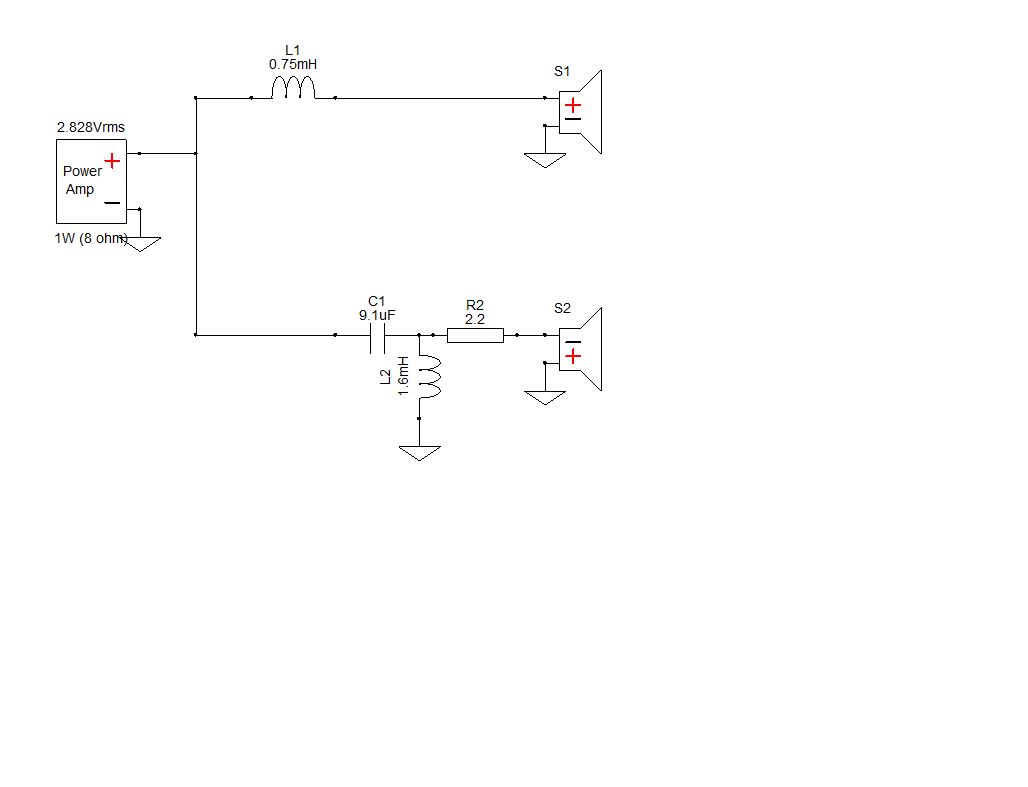

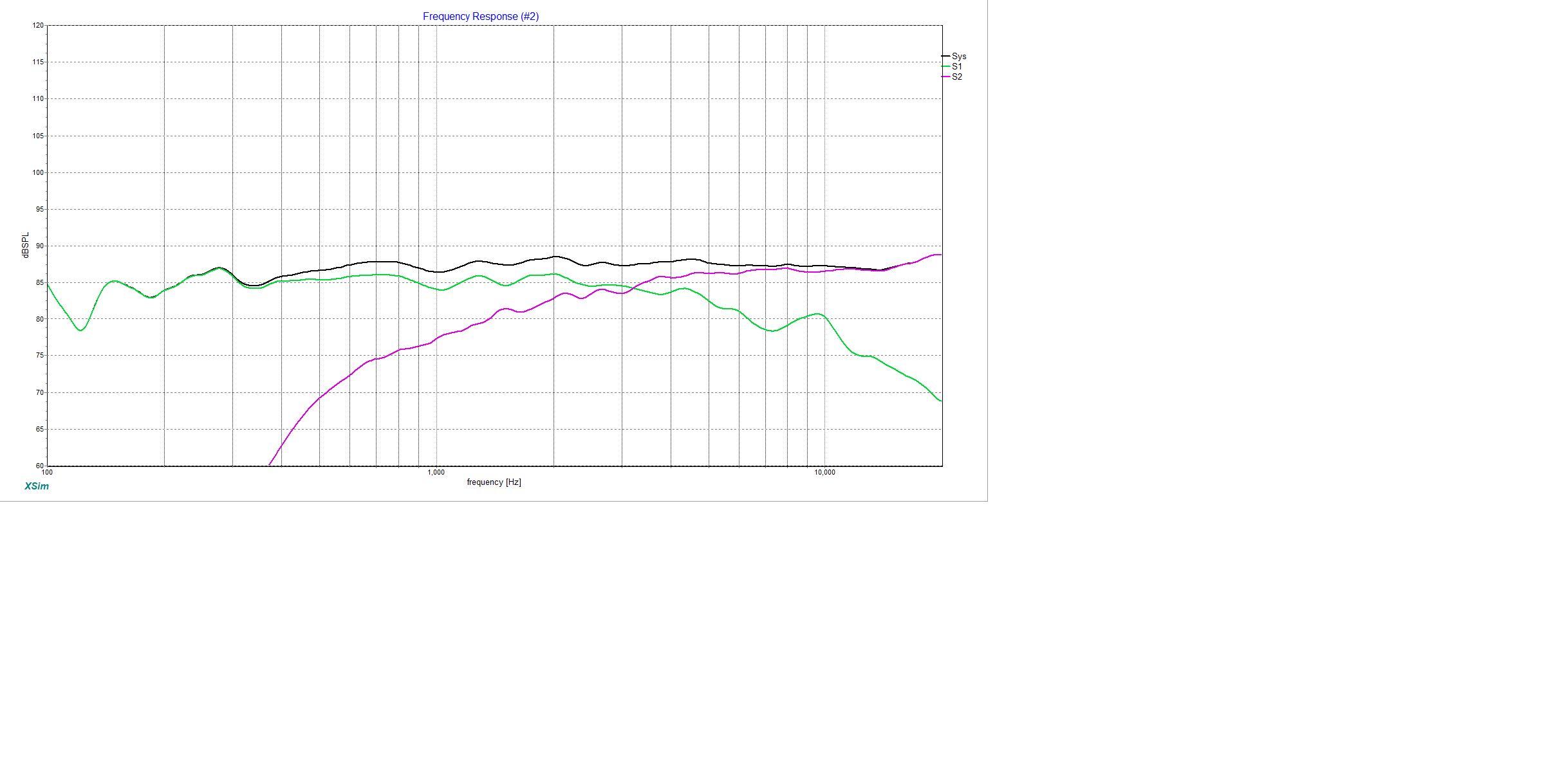

This looks better than before, but it is probably based on bad data again (no phase, incorrect base FR), so it is not a valid simulation.I tweaked the crossover to cross the mid to tweeter to reduce the crossover point from around 6 khz to 3.2 khz.
I don't think so. You have done a good job, but I suggest you to address the faults at the base before doing another simulation. In other words you have to add the baffle effect to the mfg curves (they are all on an infinite baffle), and then in XSim use the phase (there is a button for that called "derived"), and also use an appropriate delay for the mid compared to the tweeter (a value of 0.75" or slightly more should be correct). Also trace the impedance from mfg curves and again in XSim use the derived phase. While not perfect you will be in a ballpark.I Am not good at simulation.
IMHO your choice is based on some debatable assumptions. First, that a first order crossover has some advantage over higher order crossovers. The problem is that in a crossover design the only important slope is the acoustic one you will create, the electrical order is only a technicality. The second problem is that a series crossover works only all together, whereas in a parallel crossover you can tune one driver at a time, and for a novice this can be easier, moreover with a 3 way. And if you want to measure the FR, with a parallel crossover you can easily measure one driver at a time.If i remember correctly Rod said there may be advantage(may be little) of series crossover if considered in case of first order over parallel. Correct me if i am wrong.

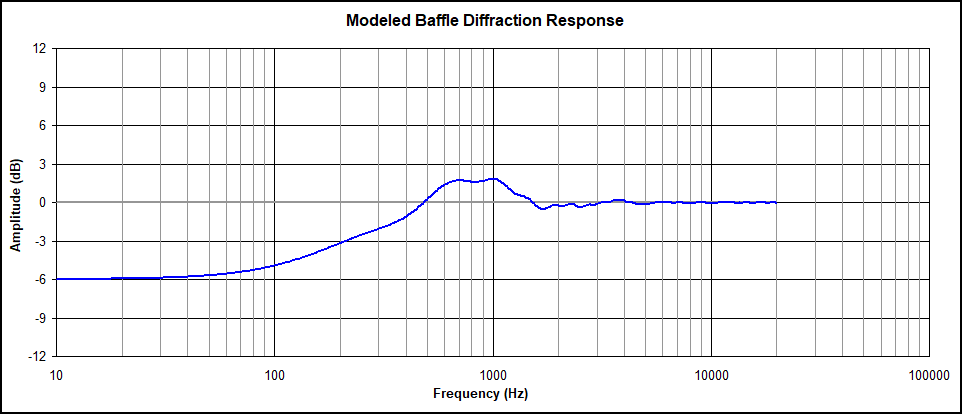

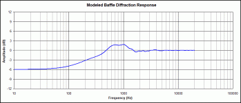

As an example of what a baffle will do to a 8" driver look at the following image. I have simulated a 10"W 36"H baffle with a driver at 8" from top, different values will yield a somewhat different curve. You have to add these values to the mfg curve. Clearly the Amplabs curve you are referring to doesn't exhibit the 6dB loss toward the low frequencies, so it is wrong. How much baffle step you need to compensate depends on the room placement and unless you have a very large room usually is less than the full 6dB loss.

The problem with the baffle step effect is that in the case of a rectangular baffle the transition from 4pi to 2pi is not gradual. If you look at the last figure I posted you can see that in this example there is a large bump of 2dB between 500 and 1500 Hz more or less, something you need to address with every crossover, active or passive. The only way you can go away doing nothing would be in the case of a natural hole in the FR of the driver with a more or less reversed shape of the baffle step bump. For me this worked once, however the Peerless woofer doesn't have this "feature".
So to recap you need to model anyway. The line level crossover you are thinking will not address the baffle step bump, so IMHO is not the best and more effective solution, doubling you amps without fully correcting the diffraction. If you want to follow the active route you need to choose a programmable digital crossover, but for a crossover point between 400 and 500 Hz it doesn't make much sense economically.

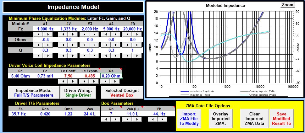

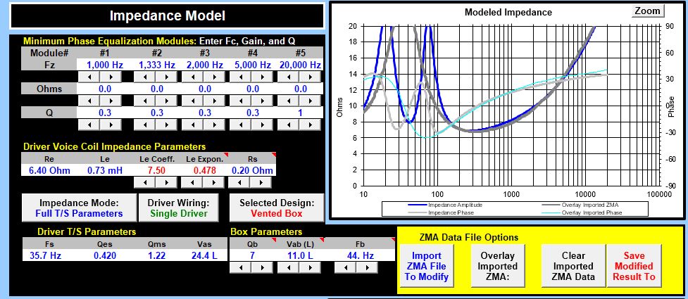

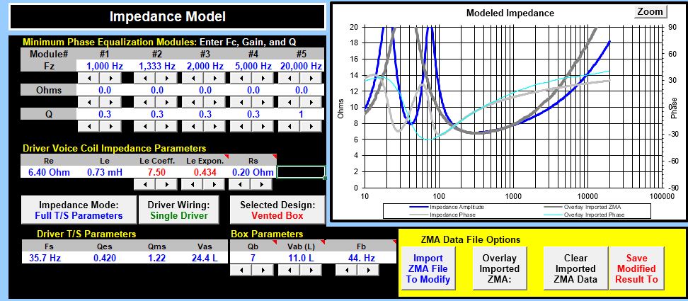

I really like all the work that Paul C has done over the years but his instructions here on impedance sort of miss 1 of the finer details involved.
Pic 1 below shows that yes indeed Response Modeler simulates the driver's impedance in whatever alignment you choose, the blue trace. Unfortunately it also shows that's it's only half correct - the grey trace is the measured impedance of the driver imported from the spec sheet. So when you put the driver into a box, not only are you changing the response in the low frequencies, you are also changing the impedance in the low frequencies too. But in both cases, it's only the LF responses that are changing. So the simulated impedance response (blue) is correct in the LF's but incorrect in the HF's. Or to put it another way, the infinite baffle spec sheet impedance (grey) is correct in the HF's but incorrect in the LF's once you put it into a box.*
What to do? In the case of the FR, we splice. In the case of the impedance, we manipulate. Pic 2 shows the effect on the simulated impedance of changing the Le Exponent value. Now we've got much better alignment between the 2 curves above about 200Hz but there is still room for improvement.
Pic 3 finally gives me what I want by using just 1 of the 5 equalization modules also included in this section and by just tweeking the Le Exponent a tiny bit more. Now your simulated impedance curve is both correct below 200Hz and above it. Save the modified result and you are good to go.
One other comment on Paul's impedance instructional: Sure it's a good idea to include xo series resistance in the box modeling because it will indeed alter the response just a little bit, but think about it, if you include it here in the impedance as well, then when you use that file in your xo sim and then add in the series xo components with their resistance values included, you are effectively adding that resistance value to the driver's impedance twice. So I include it when I save the modeled box FR but I don't include it when I save the modified box impedance curve.
* For a little more detailed explanation, hover your cursor over the little red triangle in the Le Expon. cell and/or have a closer look in the User Guide tab.
