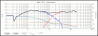

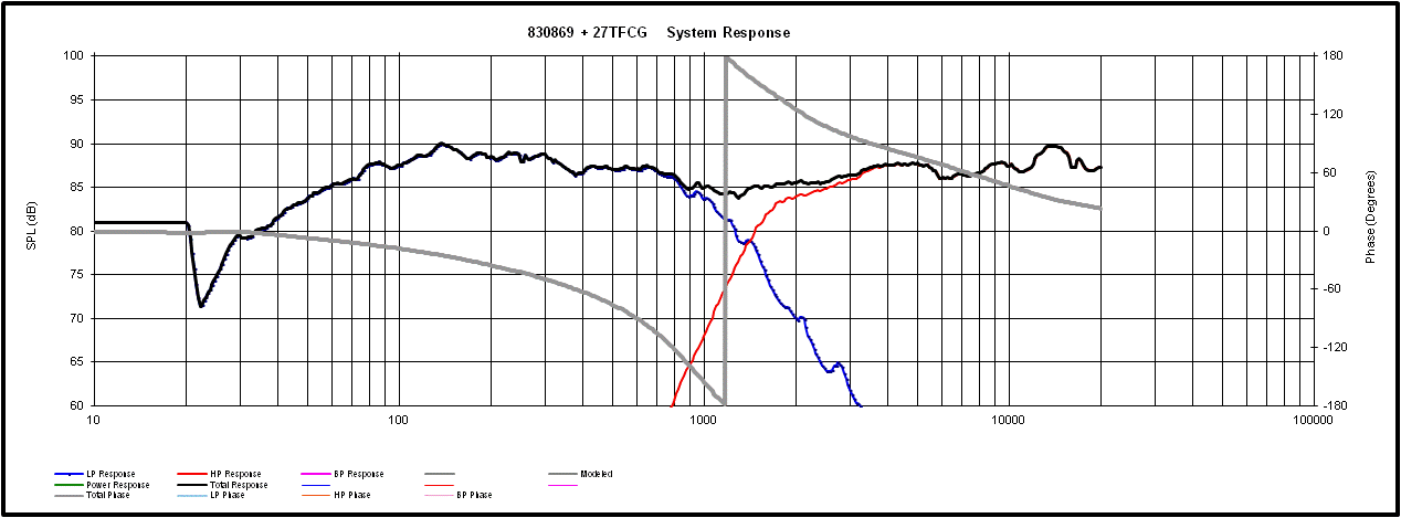

Next: some preliminary work on the crossover. While I haven't yet been able to take my own frequency response measurements, I've made FRDs of the peerless datasheet and zaph's Seas/waveguide combination to use for preliminary experimentation. While my tweeter is not the same as Zaph's, the frequency response should be very close, so I think it's safe to use that data until I make my own. The best, and simplest, result I've managed to get so far requires only 3 components: a 1.8mH coil and 10uF cap on the woofer, and a 3.3uF cap on the tweeter. The result is a smooth transition around 1.6k with a deep, symmetrical reverse null and 2db of built-in BSC. I've tried all sorts of configurations including mixtures of 3rd- and 4th-order slopes, zobels, notch filters and BSC circuits, but nothing else has worked this well on paper. One thing that baffles me is that I have not been able to get any more BSC than 2db, even with fairly aggressive BSC filters. But my room is pretty small so I hope 2db will end up being enough. One last note: according to the baffle diffraction and room boundary simulator, the cabinet I'm building will produce a slight ~1db bump around 700-1.5K that corresponds precisely with the dip in FR.
That's all I've got so far! Any feedback would be appreciated, and I'll be sure to post updates as they come.

You should take measurement of the midbass in your cabinet and the tweeter too. Measure outdoors on solid ground from 5-6 fet diatance with the real cabinet to get precice effects of baffle and floor effects.
Simulations are fine for preliminary outlines of the design, but just that. Real life is different and sometimes it hels you, sometimes not.
I like Zaph's designs a lot, you should get a really fine speaker!

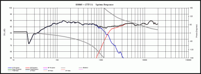

Good advice: 4uF on the tweeter and 2.2mH/15uF on the woofer controls the woofer breakup considerably more.

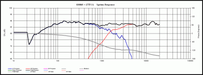

On the other hand, here's a simulation with 24db slopes. Again very good phase alignment, reverse null, etc, but this crossover requires 9 components instead of 3. Is it worth it? Only if the breakup on the woofer is really obvious, I suppose.

Just to get you heading in the right direction, chazdrumzalot...
You'll never get anything good with a 1.8mH coil and a 10uF capacitor on the 8" bass. 8" bass peaks badly in the midrange if you overdo the shunt capacitor, it's just how they are.
These drivers need a Zobel type capacitor shunt to get some serious rolloff. Say 7.5R and 6uF along with a suitable bafflestep coil around 2mH. I'd add a tank around 6-7kHz across the coil to dip the breakup too. In fact Troels does exactly that here:

Partly, I suppose, but the difficulties are mainly to do with the major cone resonance around 3.5kHz with an 8" driver which is uncomfortably close to crossover point.^is it due to above average voice coil inductance?
Most 8" drivers also have a natural steep frequency response rolloff around 24dB per octave which doesn't give you much scope with filtering or time alignment.
Using a recessed horn tweeter might help a lot here. I'd trust Troels' design as a start.

In the second simulation I posted, I used a 2.2mH coil and a 15uF cap to get the woofer breakup ~14-15db below the total output. Assuming this is not enough, what minimum suppression should I be aiming for?
...Which leads to my next question:by "overdoing" the shunt capacitor are you saying that 10uF is TOO large? If that's the case, I think I already know how you'll feel about the 2.2mH/15uF option.
I initially started my crossover simulations with a zobel (the same as IG81 recommended, or by using PCD's suggested values) and baffle step and everything, and this morning I went back to that. But I have not yet found a way to incorporate the zobel such that I get a good FR, good phase, AND any additional breakup control compared to 2.2mH/15uF. To get anything that looks good I have to resort to a single series coil in conjunction with the zobel (and then phase is bad anyway). This may all be due to the fact that I'm not yet using my own in-box measurements, and perhaps once I get started with those I'll see (or hear) what you're describing.
If serious rolloff is the goal, maybe I should put more attention toward the 24db crossover, despite the higher complexity and cost.
