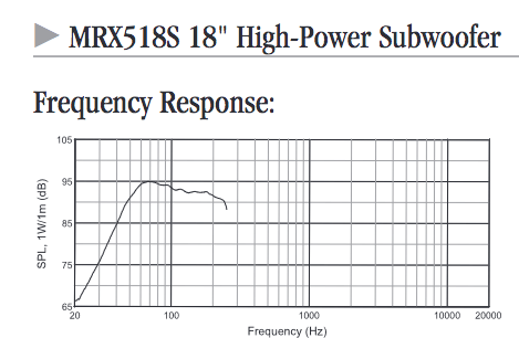

The JBL MRX518S rolls off below 60Hz, -10 dB at 40Hz, -20dB at 30Hz.4. Even after all that, are we likely to get better results from a MUCH smaller, but properly designed and/or built 15" or maybe even 18" sub? I'd like to go passive, so something like a JBL MRX or EV (I come from the pro audio world, so not too familiar with equivalent home stereo boxes)
With the volume you have available, you can get a response that looks similar, but moved down two octaves.

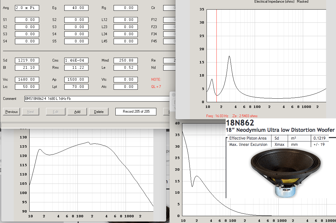

Larger cones are more sensitive, 2x18" roughly +3dB (half the power required) over 2x15".I only have about 800W worth of power to play with, so maybe two 15" drivers, slot-loaded in a "drop in box"? Someone else recommended building a drop-in unit....this might be a good version of that idea? Generally speaking, "better" than a single 18 (for SQ, LF extension, sensitivity).
800 watts is ambiguous, how many volts can your amp(s) produce into what impedance? I used 4 ohm nominal drivers in the simulation below.
Something that goes an octave lower than what we might use for PA 😉I realize it's a big ask, but off the top of your head, what type of design would you choose for this purpose if it were your home?
Push-push to reduce mechanical vibrations. I did not include the plenum (slot) in this simulation, it would add some upper "punch", but the low end wouldn't change much at all. I chose the BMSN862-4 for you because of it's low Fs, low distortion, and relatively lightweight cone is more sensitive than other "PA" subs designed for small enclosures.
With a HP around 14 Hz the pair won't run out of excursion to below 16Hz, super clean.
124dB at 16Hz is pant leg flapping territory, though you probably won't go that loud (unless you want to).

Forgot to include the volume of the large port in the Hornresp simulation in #14, so gross volume was larger than the available space Jdurango mentioned.
Reducing the gross volume to around 1580 liters, nothing changed enough in the simulation to visually notice the difference.
