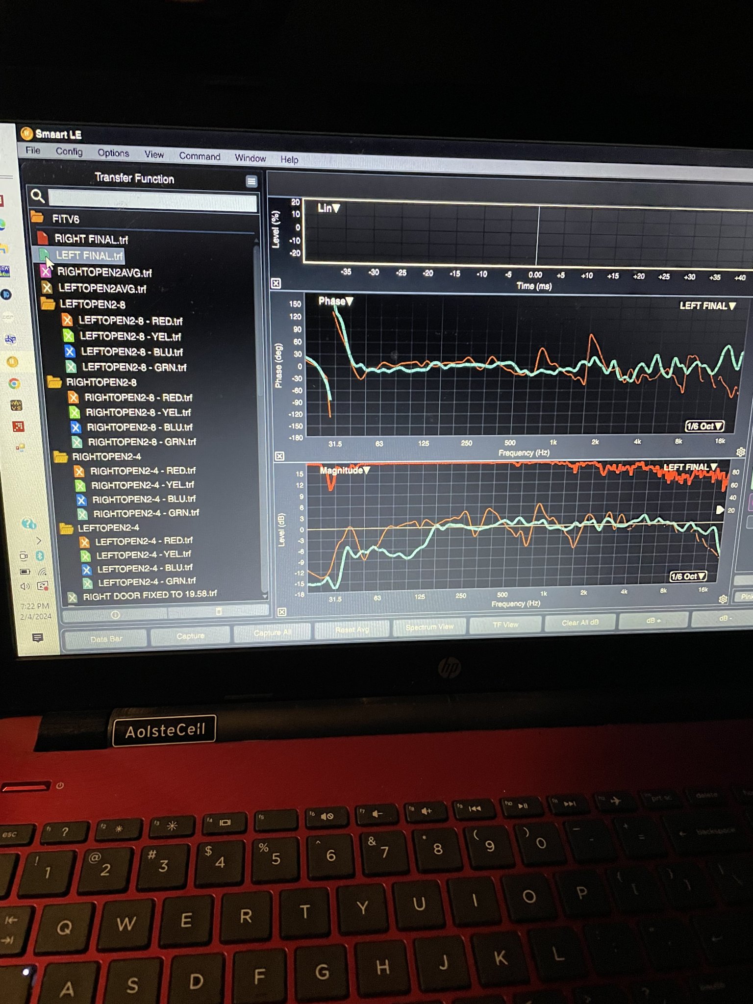

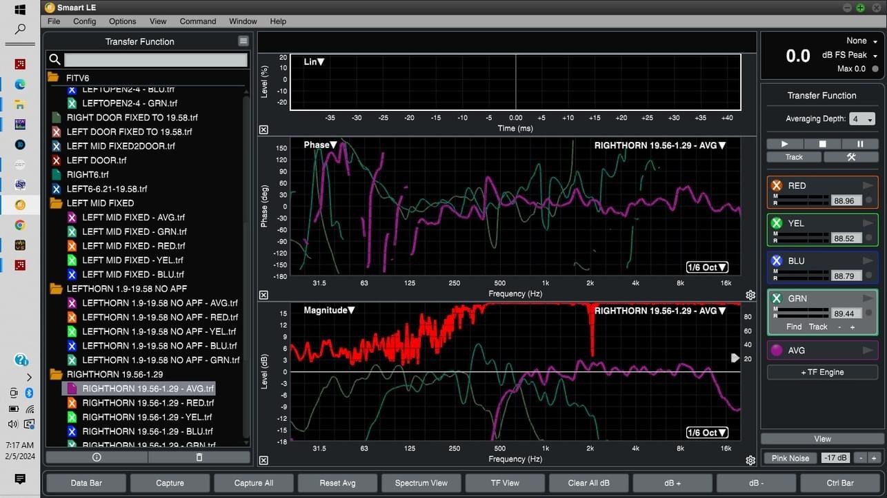

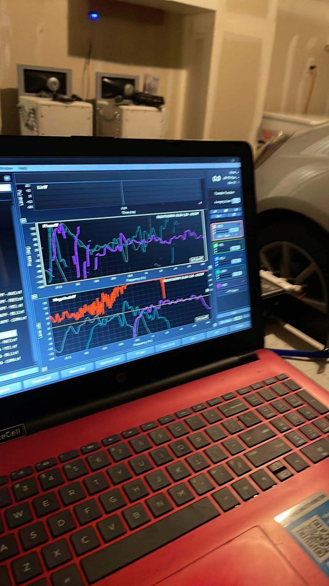

FIR filters on every driver in a 4 way with Smaart data.
So, I made some FIRs for every speaker. I have just finished a tune where I used the time of flight removal , the “find” feature in smaart only on the HF drivers.
Then I aligned each lower frequencies to the time of flight from the Hf.
Before I would do tape measurement distance then use find and then convolve to that.
Now, I used signal delay and off the HF “find” have removed as much phase as possible, then convolve to that…
Both ways yield similar results. Which one is superior? It’s close to tape distances but not quite, I noticed also a can convolve out signal delay, if I used a different delay for the speaker I can convolve the wraps and make it the correct delay… weird
Any insight on this subject is helpful. How exactly does this stuff work
I have unequal path lengths and my room is a metal box and I sit in the corner.
@pos @fluid @wesayso @mark100

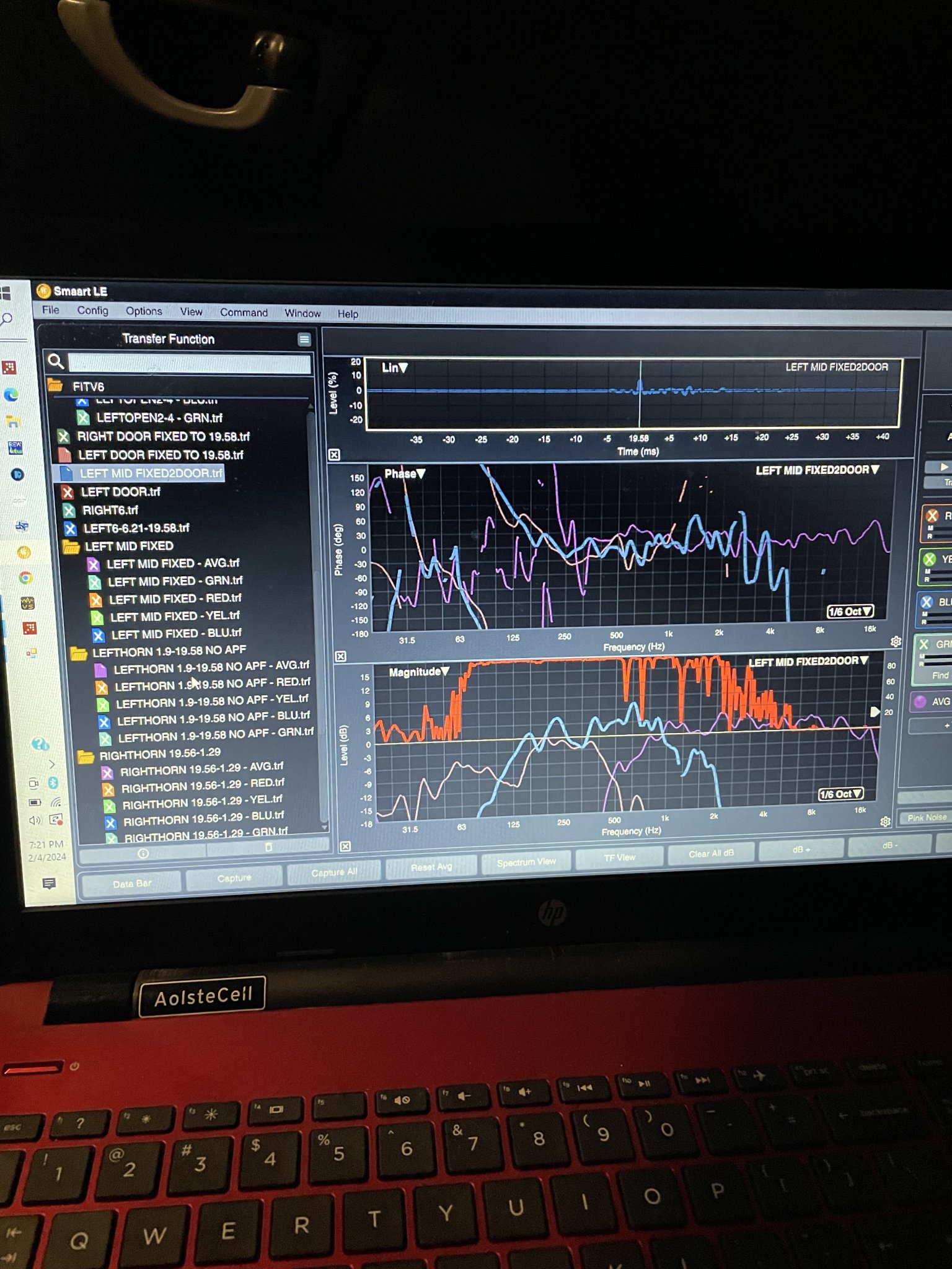

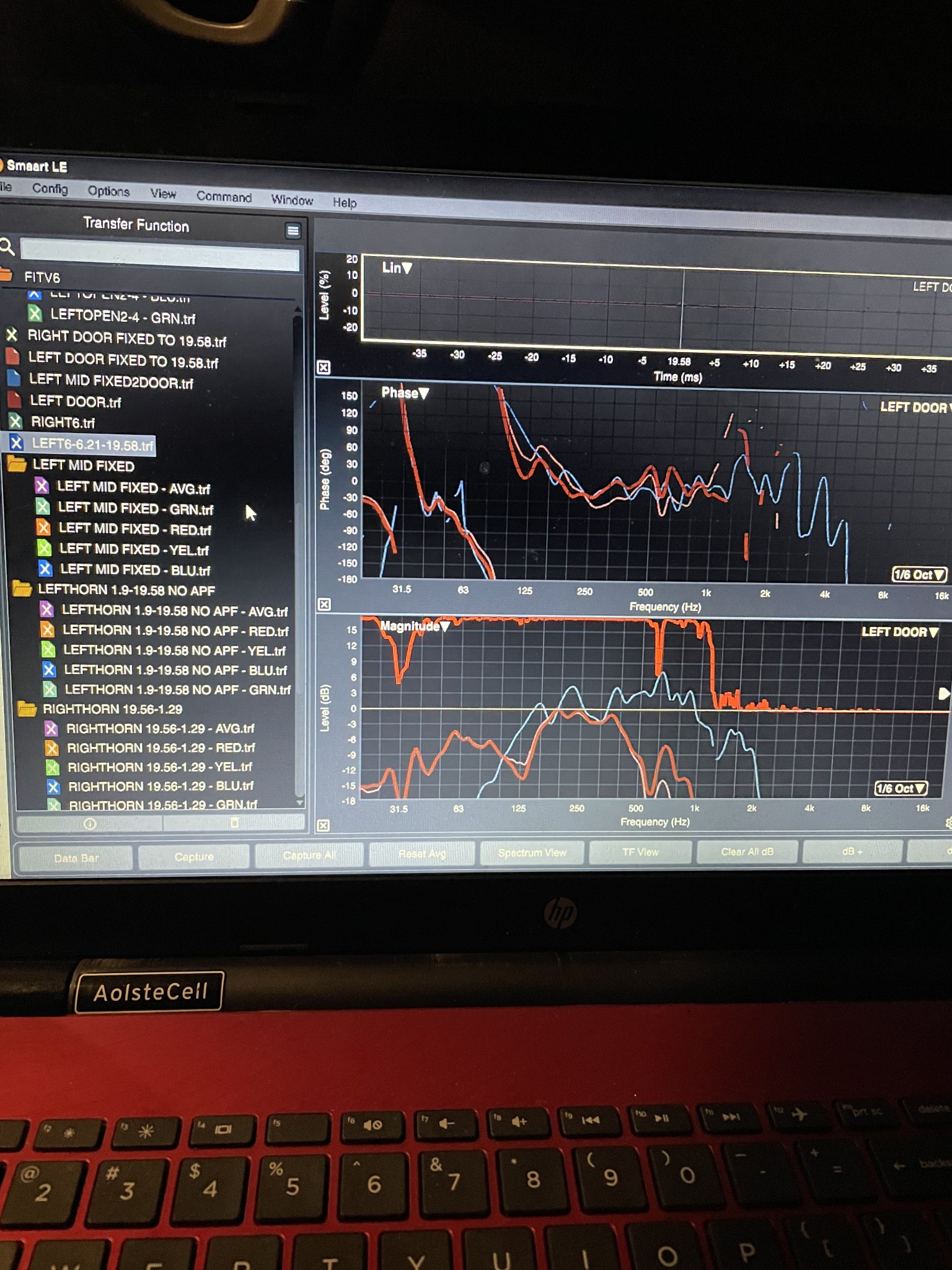

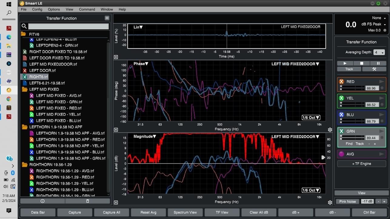

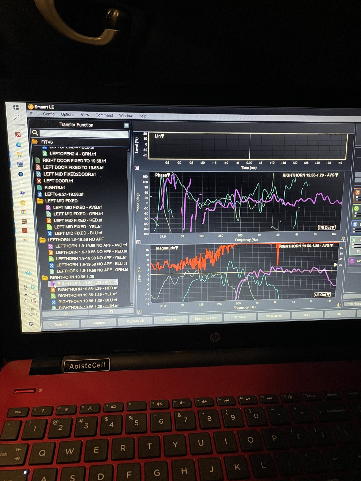

Here’s the horns doors and dash midbass
All aligned to the Hf driver

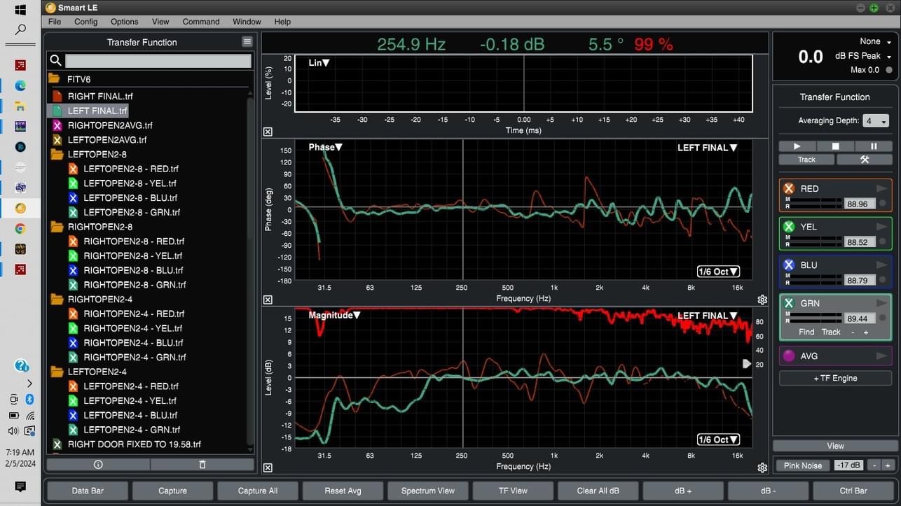

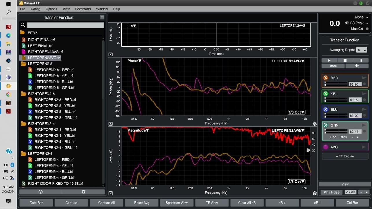

Better pics

So my question
Setting delays
When convolving FIRs , as long as I convolve it to the time of flight settings for the HF driver, do delays matter?
It seems I can convolve out or in signal delay and the delay setting on dsp doesn’t need to make sense with the rest of system
OR, is it more proper and does it make an audible difference if ; I set delays to actual tape distances then convolve out all the extra wraps ? (Of course again using time of flight from HF driver)
Maybe I need someone to explain casualty again to me.
