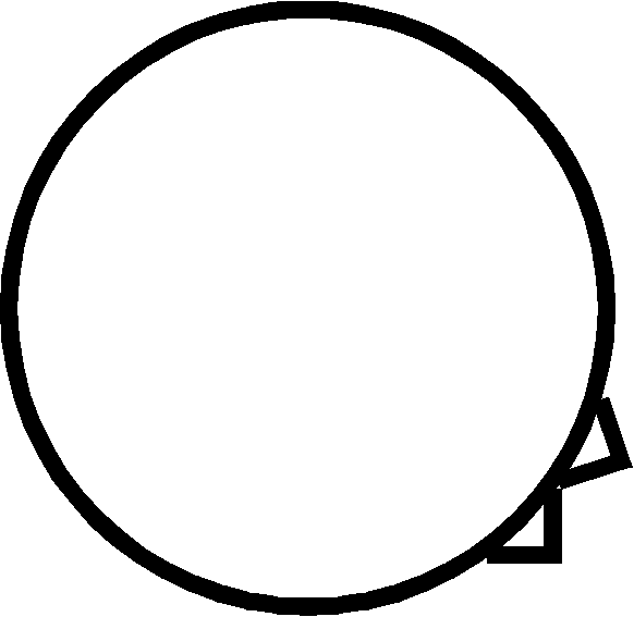

Well im not sure how they do the piano's but this is how i would do it.
Go down to lowes or Home depot or w/e and get either some very thin plywood or some of the artificial cork board that bends so easy.
I reccomend sorking the plywood before forming and perhaps a spritz of water on the cork board. form it around the tube, get some straps like you strap stuff down with in the back of a pickup and strap it up tight. at least one on each and and one in the middle. Let it dry over night or blow dry it.
Now that it is dry glue it on. Wood glue would work buti reccomend epoxy. after the glue has dried sand the seam smooth then used either a wood filler or some sort of automtotive stick-to-anything filler to smooth any imperfections out. sand untill its baby butt's smooth.
Next get some dark grey primer. Wipe it with tack cloth, do a coat of primer and sand it, wiper it with tack cloth, then do another and sand it. then wipe agian with tack cloth.
Get some Jet black automotive (acrylic) paint and do 3 coats of that, sand a little inbetween each coat and wipe with tack cloth between each coat.
Now you should have a very black tube, but its not glossy. get some automtovive (acrylic) clear coat and sand that black finish with high grit paper untill its very very smooth, patching any place that needs so if you sand through. once you are satisfied with your color wipe it down with tack cloth then shoot a coat of clear. 3-4very light coats instead of 1-2 heavy ones. sand any cat eyes or runs you get with 300-500 grit paper. wet sand if nesisary to get cat eyes out. your last coat should be your best. wet sand with 600 then 800 grit and buff it out.
Wax if nessisary
you now have black and glossy finish.

Doesn't sonotube have a waxy coating on it as a release agent for the formed concrete? If so, the adhesive will have to be chosen very carefully.
If not, and you do the laminate layer method, you can probably use 3M Super 99 spray adhesive... easy to apply, effectively no curing time needed, and very strong. The readily available Super 77 will probably also work but it is not a very good permanent adhesive.

What *I* would do...(1) go with the liner spray (2) if you still insist on gloss -> use multiple coats of drywall joint compound (mud) in a sequence like this: mud, rough sand, primer, fine sand....repeat. Basically, the mud will stick to anything, is easy to sand, won't wet the cardboard enough to cause other problems, and will sand to a smooth surface, and it is the smoothness that is the real challenge to making a piano black finish. Remember that you must maintain a thin overall finish thickness because the mud is soft and will ding easily otherwise.
