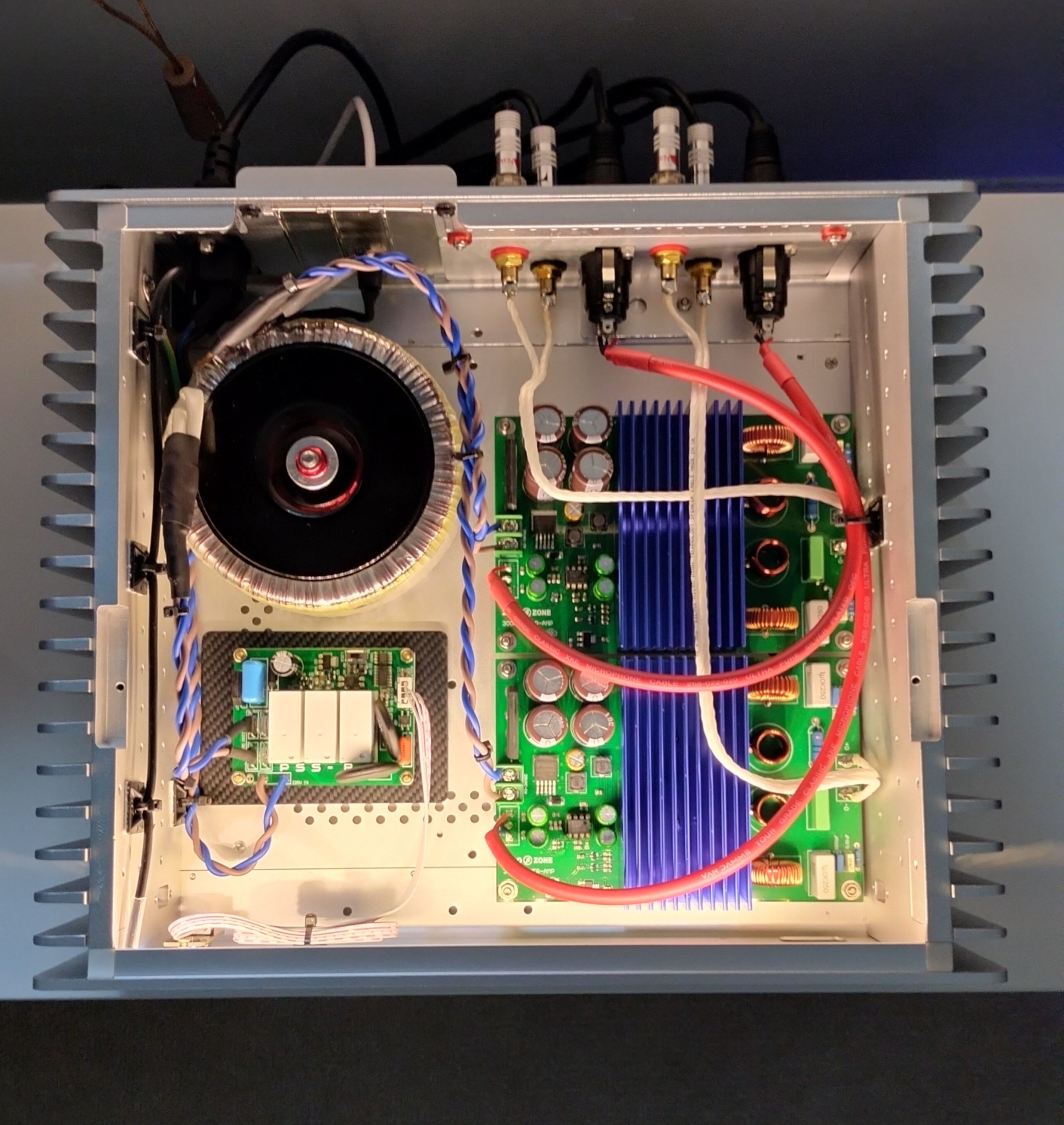

Finished my class D build. Sounds AMAZING
So we have:
300va toroidal with 2x 25v secondary
Soft start board with momentarily switch support
HTPC case, solid aluminium
Dual mono TPA3255 boards - fully balanced. XLR input only.
For context I also have a Musical Fidelity X200r and a Technics A900s. Both well regarded Class A amps costing 2 or 3 times what it cost me to build this.
It blows the Musical Fidelity out of the water, no contest. It's slightly better than the Technics, with a more relaxed sound and better separation.
I was dubious about Class D. Not any more.

@Spiritg That's a lovely build, nicely done. I'm near the end of my first class D build, however not quite to the same standard as yours. I've built several amps over the years, mostly for fun to be honest, however I'm yet to master the craft of making them look great like yours. Although they sound exactly how I want them to, the interiors generally look like dustbins. And the exterior, well, like a smart dustbin. I'm sure my wife sighs every time she looks at them.
So, what's that HTPC case you have there? I'd never thought of using one of those before, and yours has heatsink fins on the sides which would suit another class AB project I have in mind.
Also the soft start module interests me... where did this come from, and how does it work power wise (is there a low voltage transformer winding needed to power it from standby?).
@gcsa - kind words thank you :) case is a streacom, build quality is impressive. Discontinued now I think, mine was an eBay find. Soft start is an eBay job - wolfzone I think is the seller. No low power feed required. It lives inline between the power socket and the transformer.
@ErikdeBest that's the very one(s) although I bought through AliExpress. I went for the balanced version. I wasn't expecting anything special, but all credit to the designers. Sounds fantastic! One thing I wasn't happy with was the brutal heatsink mounting. PCB pinched. I used spacers and thermal pads to fix this.

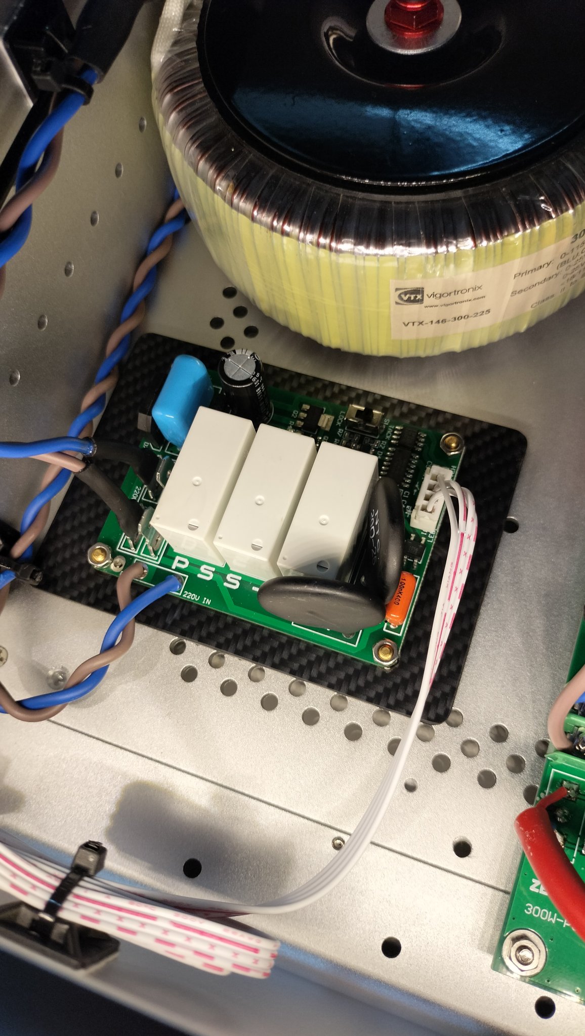

Couple of new pics. Changed speaker wiring from QED profile 72 strand to QED Silver Micro as I had some on hand and found a iffy solder joint on the terminals.
Also added an insulating board under the soft start board (ABS plastic not carbon fibre) just in case!

A very nice build, congratulations! Class D is maturing and it is here to stay which not all DIYers of other topologies will appreciate but ...change is good!
Just don't solder 230V mains wiring to PCBs.
Thank you :)
Kinda had no choice sadly based on the soft start board design. Input is solder only, (dual) outputs are spade compatible. Is the concern here a poorly executed solder joint or is there more to worry about? Pad ripping off?
