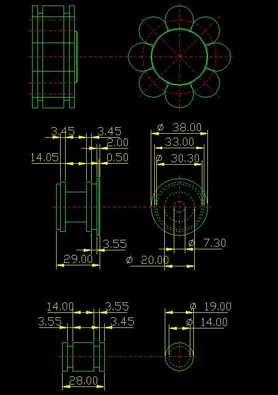

Stabilizer
JerryT, your stabilizer looks like a copy of Thorens own stabilizer. Is it an accurate copy? Do you have any drawings or more pictures that shows more details of it?
svein
svein
Re: Stabilizer
Hi Svein,
I have never held a real Thorens stabilizer in my hands, so i had to guess the measurements, but i think it's pretty accurate. I'll try to convert the autocad drawing to a picture i can post here. Give me some time, then i'll post it here.
Jerry T.
SvErD said:JerryT, your stabilizer looks like a copy of Thorens own stabilizer. Is it an accurate copy? Do you have any drawings or more pictures that shows more details of it?
svein
Hi Svein,
Jerry T.

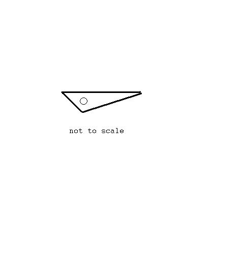

JMO : felt is a poor damper of steel, vinyl floor tiles are better.
Regarding the rib : as outlined it will modify bending modes most.
IMO it should enclose the main bearing to provide torsional
stiffnees as well, that is bending modes across the subchassis.
this sort of shape perhaps (not to scale) ;
🙂 sreten.

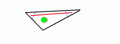

Yes, you are right, I was thinking only about the duo bearing-arm, but the whole also counts.
Thanks for the drawing, with the potted bearing, this could be a great advance. I'll try to investigate how to fix the rod to the subchassis.
thanks for the drawing
What material could be used for the rib? a square extrusion of aluminium (some mm²), and potted with the polyester? because using soldering (but using Fe, not Al) is a bit over the edge, isn't it?
I don't understand very well the drawing, what are the small lines? what are "bent pins"
As I understand it the subchassis is steel so a
piece of threaded steel rod would be best IMO.
Steel pins and needles are used for sewing.
I meant bend them slightly in the middle.
Thats what the blue lines are.
Alternatively you could use some thread (cotton / nylon)
passed through the well (with a needle) glued in place.
The rod is suspended clear of the subchassis near
the top of the well to have maximum effect.
hope that helps, sreten.
