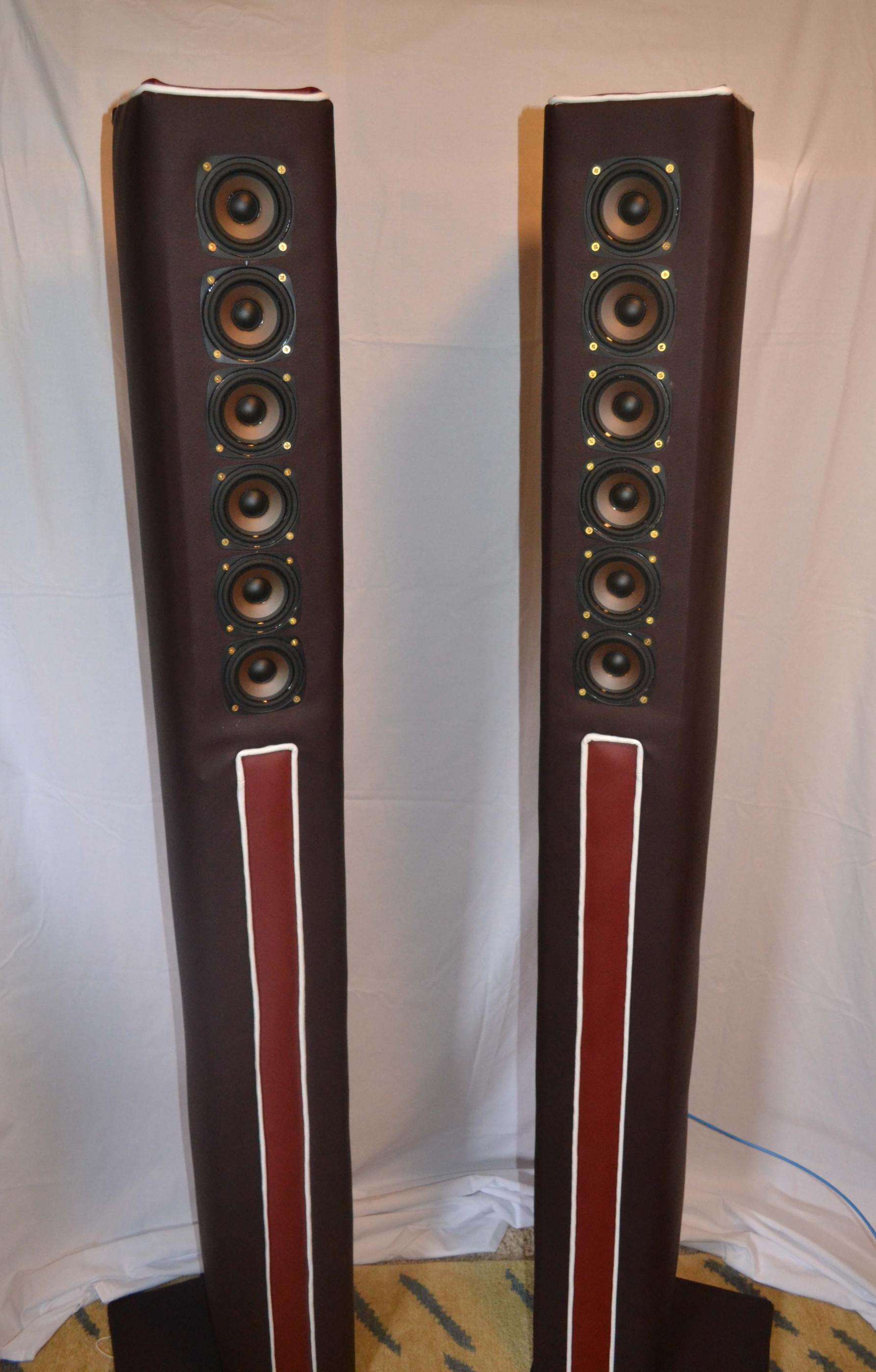

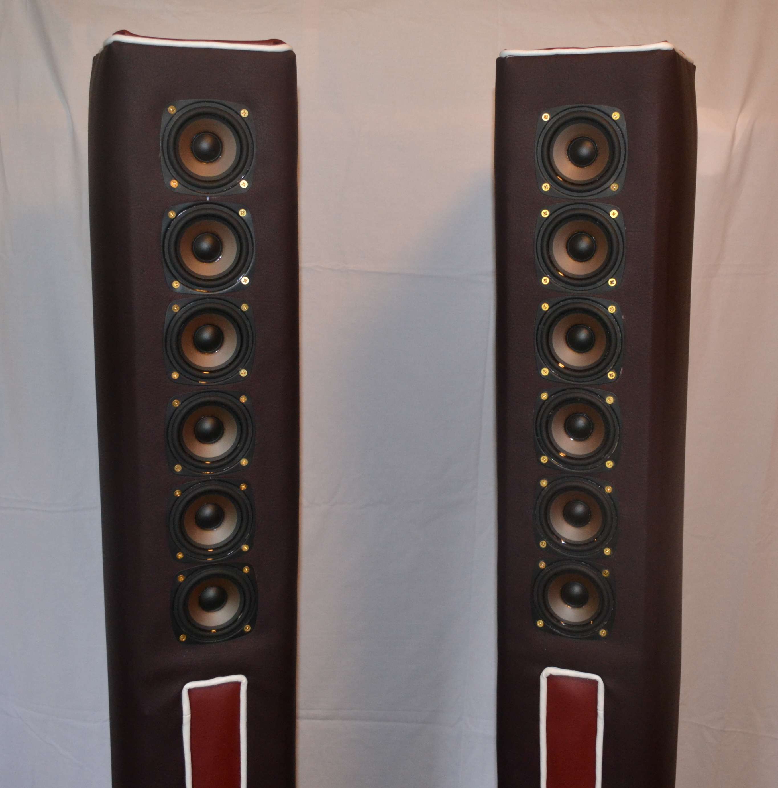

I recently finished my first speaker project and I thought some of you guys might be interested in checking it out as I posted some questions about them during the design and build.
I am very happy with the way they turned out, which is good because I spent around $400 on them (which is a lot for a high schooler..).

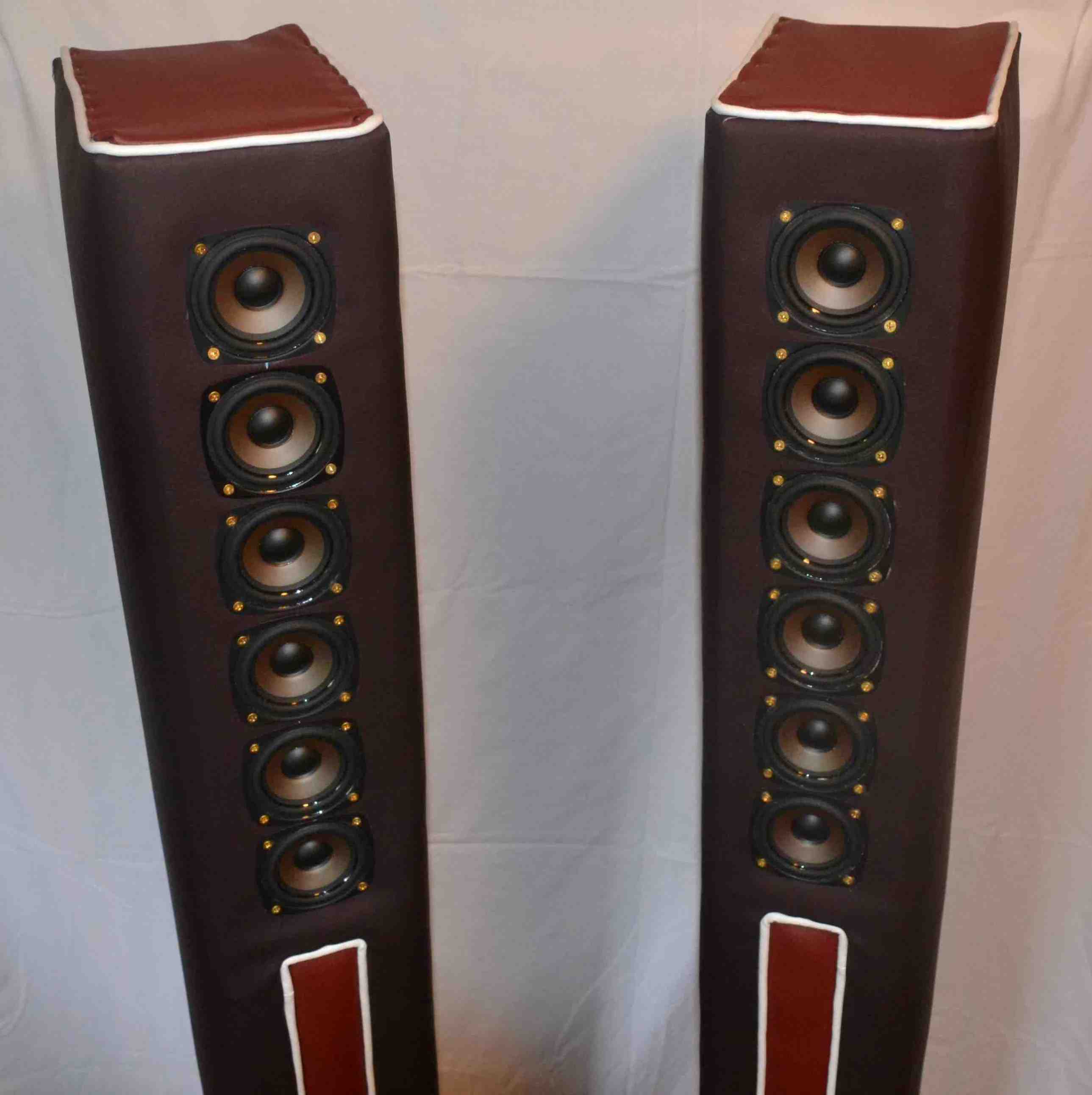

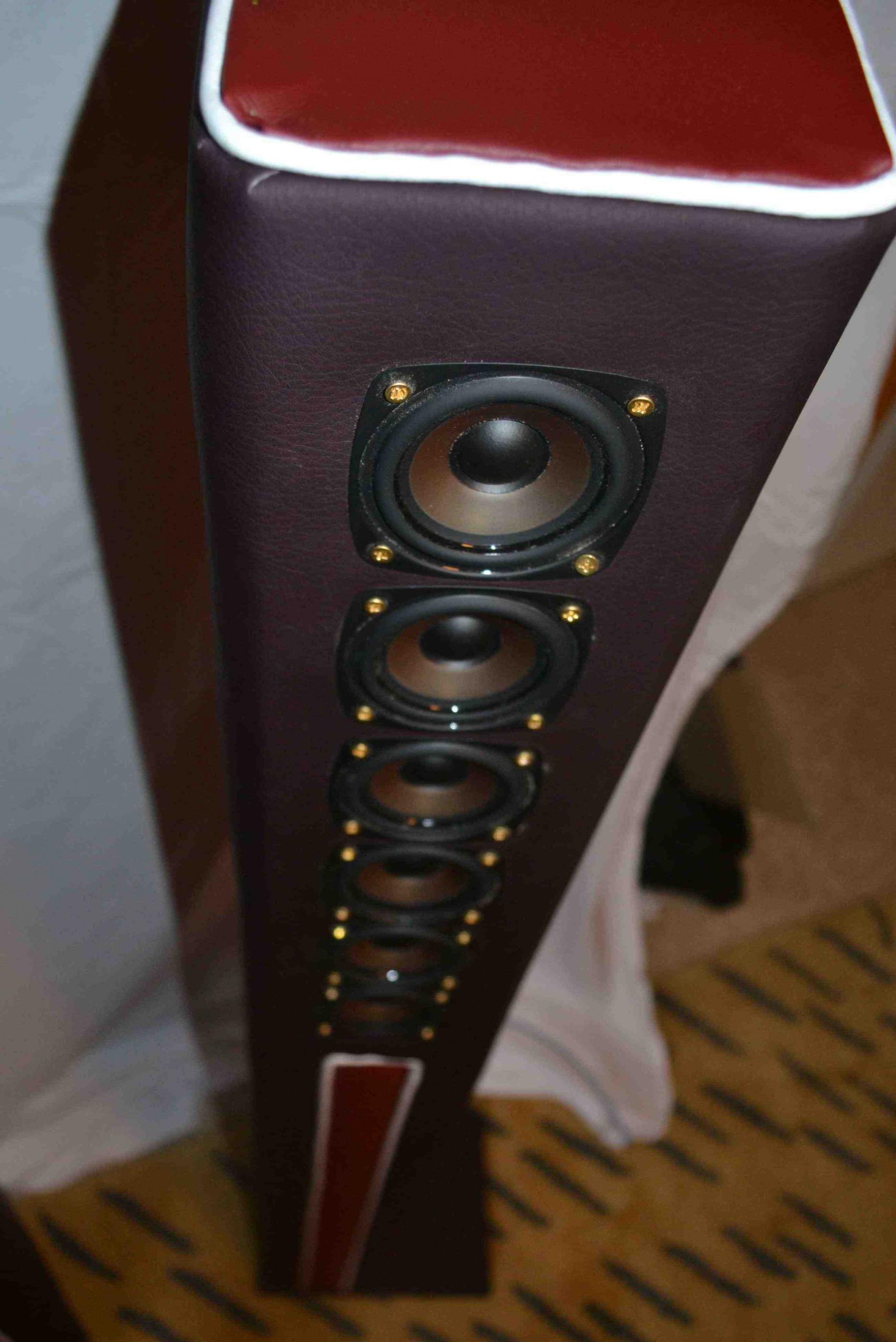

I used the Tang Band W3-881SI which, I think, worked out very well. They were within my budget and sound awesome, they are so much more detailed than my old (store bought) sound system it's incredible.
The box is sealed, around 1 ft^3, which is a bit small for 6 of these drivers but I didn't want to go much bigger and its close enough.

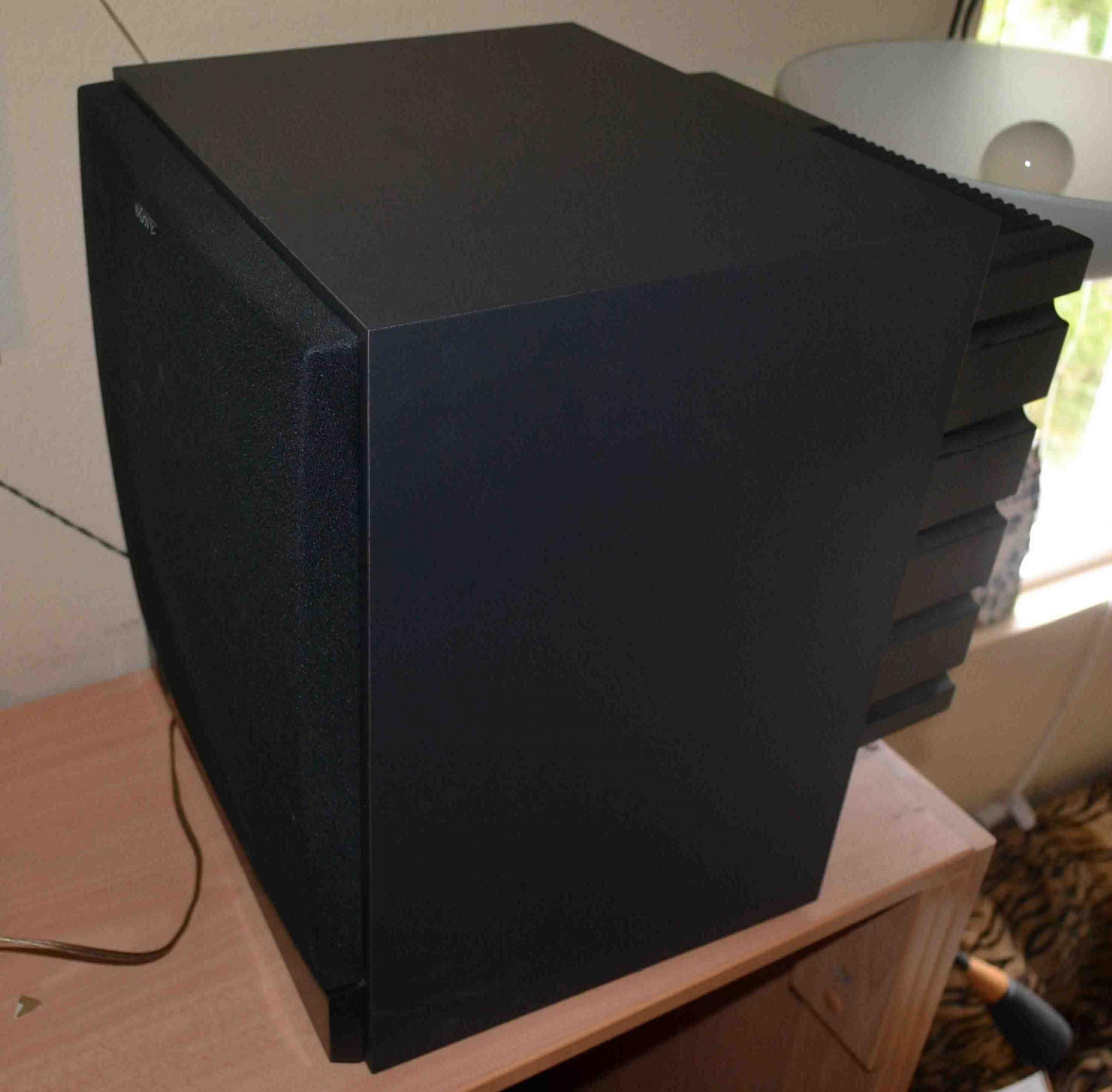

The sub is the Sony SA-WM40 that I did the stuffing modification to (which helped a lot actually) that I got of of Craigslist for $60. I know its not the best sub but its all I can afford for now. Eventually I will replace it but it works for now.

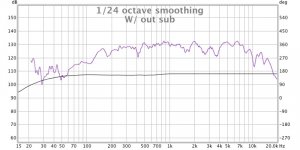

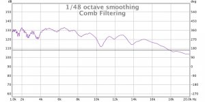

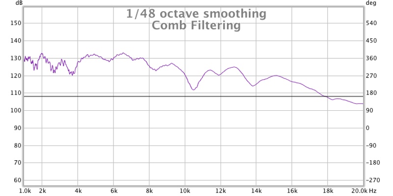

I am using the Lepai Tripath TA2020 to power the two towers and its just about the perfect amount of power. I can easily make it painfully loud but normally I keep it around 12:00 to minimize distortion. I will eventually add two tweeter arrays to minimize comb filtering (see graphs) and I will bi-amp it with the same amp.

The speakers are covered in vinyl that looks quite a lot like leather. Most of it is a really dark brown and the accents are maroon. I have some white piping between the colors which looks really cool. I am really happy how this looks, considering that it was my first time upholstering something it could have been a disaster. They look straight out a 60s diner or something. Not that it matters (because I'm not married...) but the WAF is through the roof, even my mom likes them 😀.

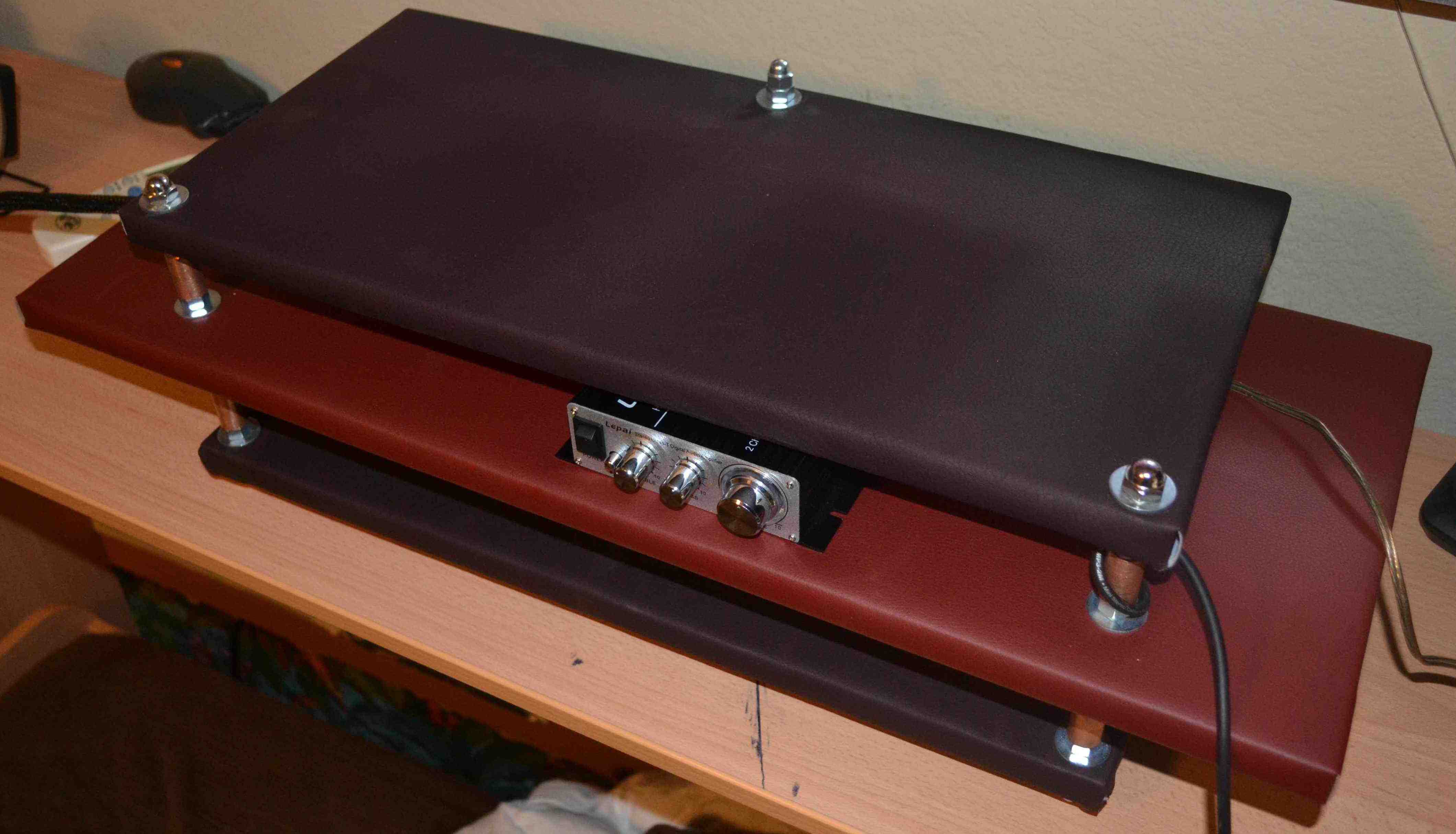

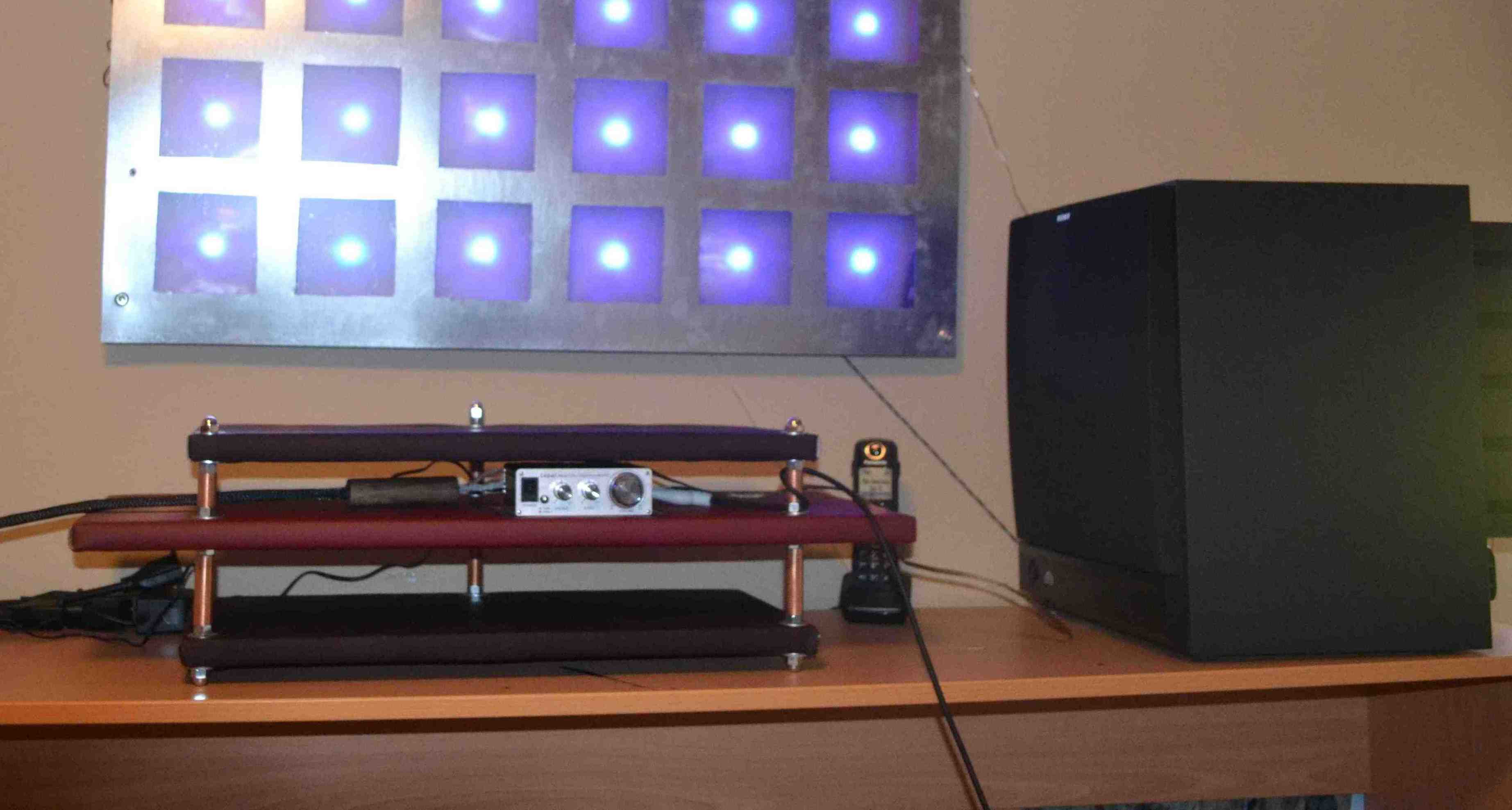

To hold all of my electronics (or future electronics?) I built a really nice looking FleXy stand and upholstered it to match the speakers. The all-thread is covered with some copper tube I sanded which looks really cool. Eventually I will have my amps, crossover and DAC on there but for now it's just an amp (the second one is not wired in to anything yet).

The things sound amazing, simply put. The soundstage is excellent (probably because of the line array-ish-ness), when I'm in the sweet spot its like no other. The upper end is a bit muffled, probably because of the drivers rolloff and also the comb filtering thats going on. This is a minor complaint though, they are still very listenable. I will eventually help this out by adding the tweeter arrays with smaller CTC spacing and actively cross over to them so I'm not to worried about that.

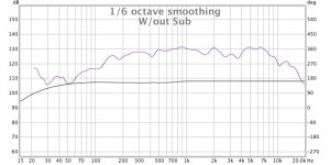

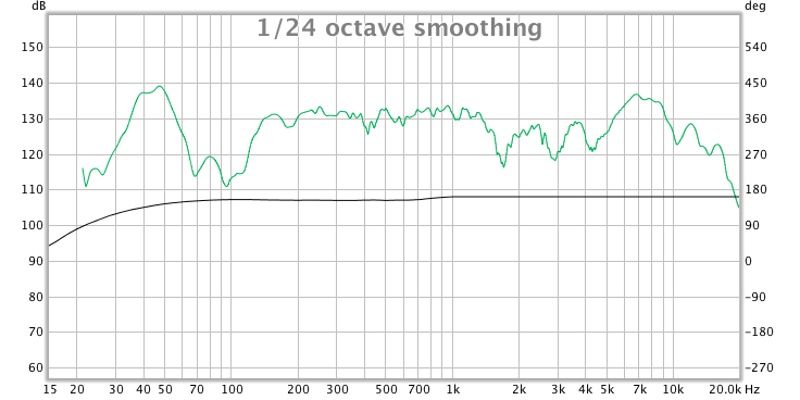

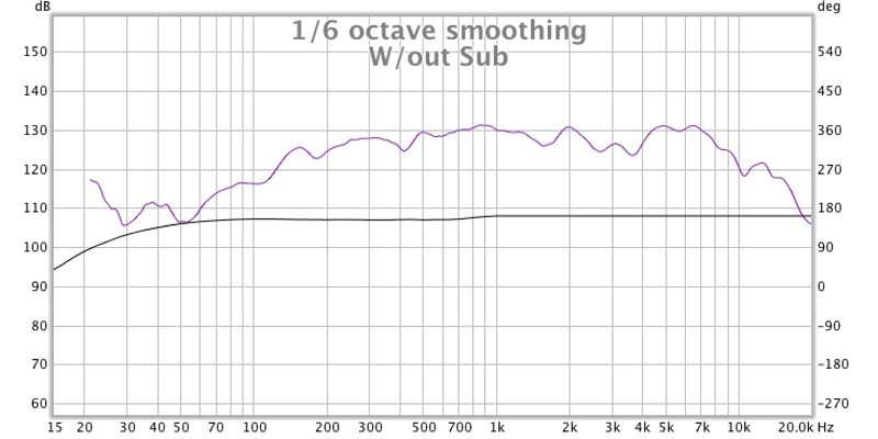

The low end is (expectedly) not as detailed as the midrange just because the sub isn't great. This can be seen in the response graphs as a pretty huge spike. At low levels its not too bad but I will upgrade in the next year or two. In the mean time I'll move it to the floor when I clear a spot and add some spikes which should help it. Before I did the stuffing mod there were some pretty evident upper end (~80hz) resonances but it's a lot better now.

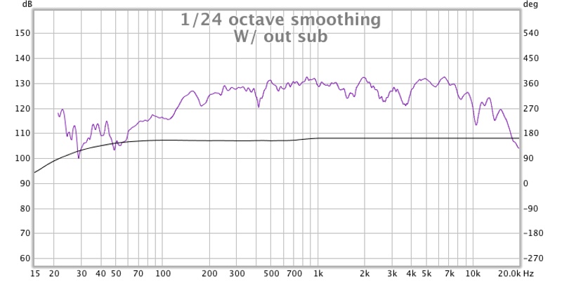

The flattest range is from around 150 to 1000 hz, the tweeter arrays will flatten above that eventually and a better sub will flatten below that

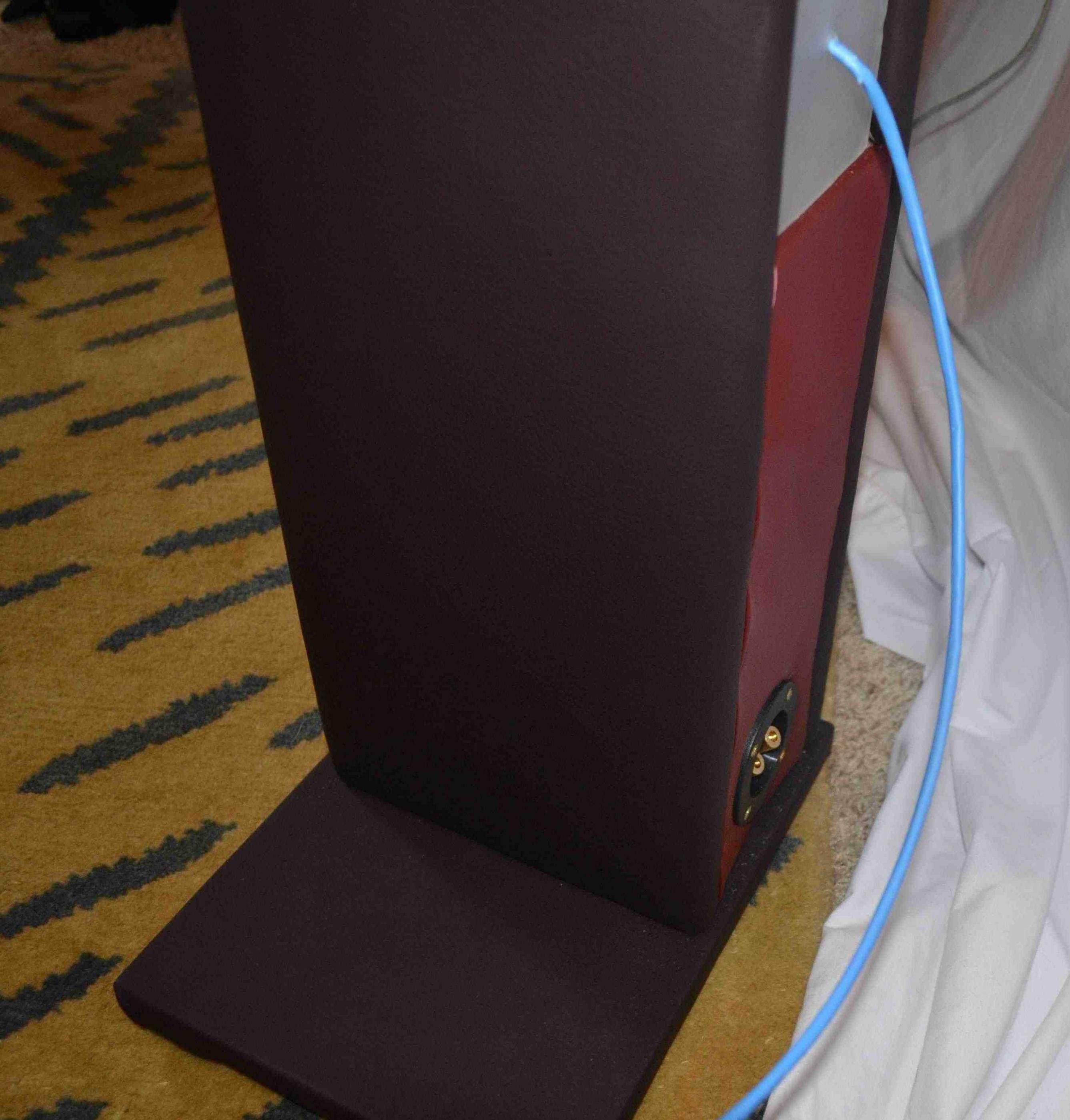

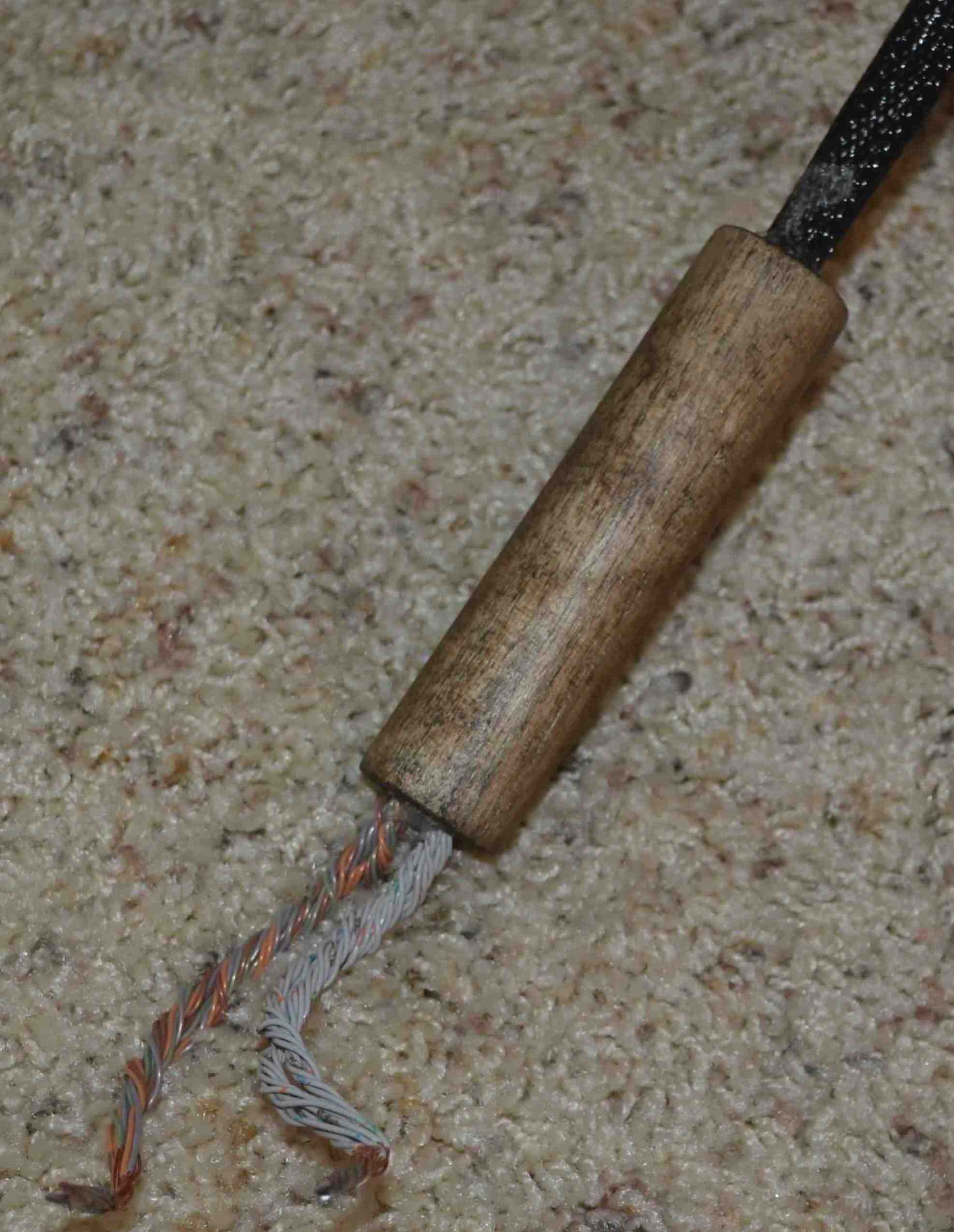

The cable was handmade with a bunch of Cat5e plenum, theres 32 strands total in each, 16 positive, 16 negative. Its covered in Techflex and the ends have a stained wood dowel to make them look good
