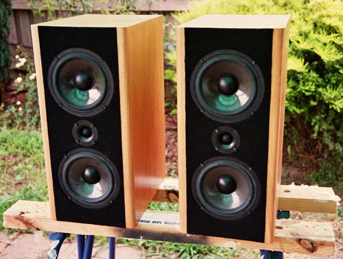

I've finally finished my first attempt at some speakers.
I decided to put together the front pair of the Audax home theatre kit. Partly because I plan to build the rest for a complete set, but mainly because they were a well documented kit, so there was less chance of stuffing it up. 😀
I couldn't resist making a couple of slight mods though. So there is some extra bracing inside the cabinets, and some felt type material on the front baffle. ('cause I think it looks cool!) 😉
Here they are:

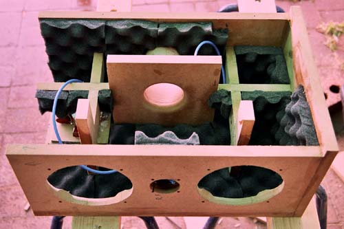

Here is the internal structure.
I added cross braces behind the woofers, and also braced them against the back wall.

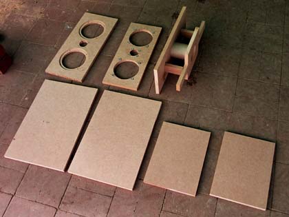

The whole project was certainly a learning experience!
(thou shalt not try to be too smart with measuring panels, just line them up and trim off later!🙄 )

good work bikeman, they look really good, the finish looks really good and damn you did alot of nice bracing, looks very top notch.
If they sound as good as they look you must be a very happy camper.
good stuff bikeman
btw how do they sound?
nice finish
Whats the felt on the front and how was it applied?
Cheers
Thanks!
They sound pretty good to me. Maybe not as deep bass as my old Castle Stirlings, but very detailed. Vocals sound like they're right there. They can play louder than I'm ever going to use.
The "felt" is actually Jaycar "speaker carpet" (cat# CF-2755) and stuck on with spray-on contact glue.
The finish is beech veneer, which comes as an iron on sheet. The joins were a bit of a pain to get right.
Overall, I'm very happy. They came out better than I thought. And my G/F is so happy with how they look, I'm now permitted to do a sub and the rest of the surround kit. 😉
