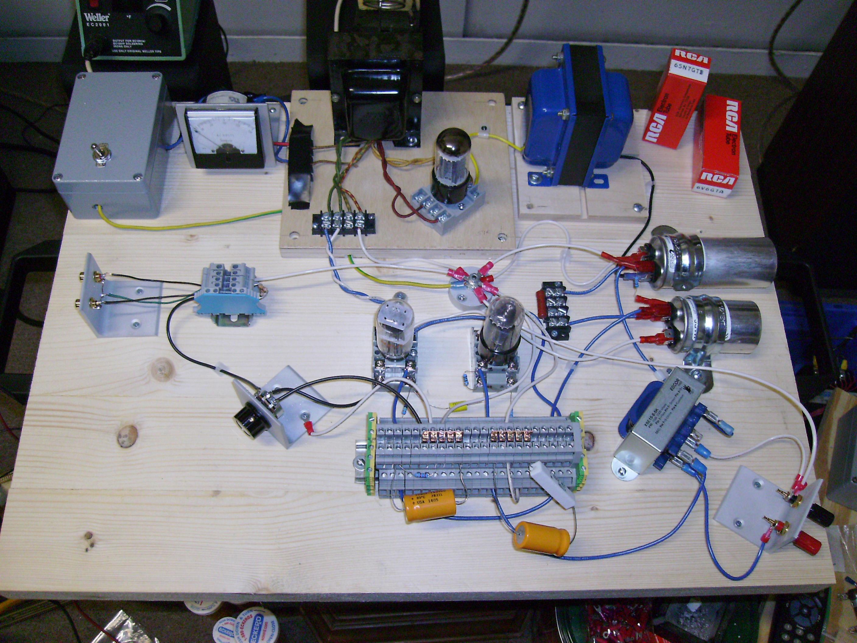

finished breadboard project
Here is a pic of my finished project. Initially I had a slight hum which went away when I connected the filament ct to ground. Also, the gain was a little low because I was using a discman with only .7v output. I changed that with a cd player with 2v rms and it is fine. All of the voltages check out and it sounds pretty good. It is only one channel. I posted awhile back about connecting one channel from a two channel source, and took the advice given, by using two 10K resistors to sum the input to one channel. It works well, so I did not try a different way.
Transformer is an old one out of my Grandmother's old Zenith console push pull amp.
Thanks for the help to those that helped me when I had questions. This was strictly a learning project. I am going to start thinking of a different design for the next project.
Tubes used are 5y3, 6SN7, and 6V6. I used the Sylvania RC charts because they had a 250 volt column for the 6SN7. The 6V6 is set at 250V with 12V bias.

DF96 - I must be lucky because I haven't notice any problems. A friend of mine is an old radio guy and he expressed the same concern. I am sure it is less of a factor with audio, but still a concern. When I started wiring it, I decided it was best just to build it and then debug it. Too many times I over think things, I just wanted to get something built!
