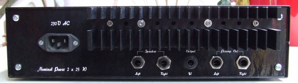

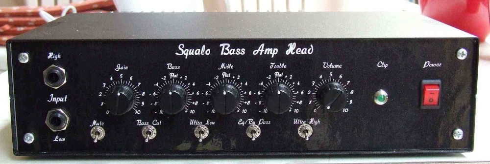

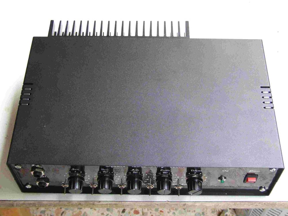

Here are the pictures of my finished bass guitar amp - I build it for my nephew. Some details :
- preamp is from the web page of mister Kreuzer
- power amp is two channel build from OPA549 (2 x 25W at 4ohm for home practice)
- di output (balanced) made around DRV134
- two outputs direct from preamp
The soud is very very good!

Wow looks very professional! Did you silkscreen the lettering on?? It looks like it's a manufactured unit! Cheers! I'm sure it not only sounds awesome but looks awesome too!
Woah the worksmanship on the enclosure's mint! I wish someone had built something like that for me! What cab do you run it through?
@ Test Electrix - the speaker cab are two each one with two 6.5½ FDC Audio woofers (low cost but good sounding) this is for home practice
@ Garp32 - the silk is printed on the paper and then laminated with plastic foil. Laminated paper is then glued with double side adhesive tape on the front and back pannel. The dimension is 320x65 mm.
