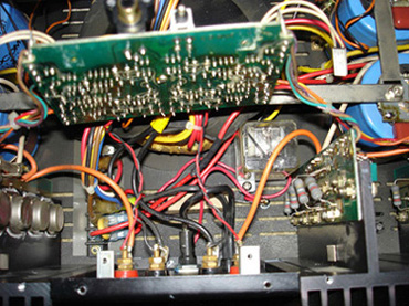

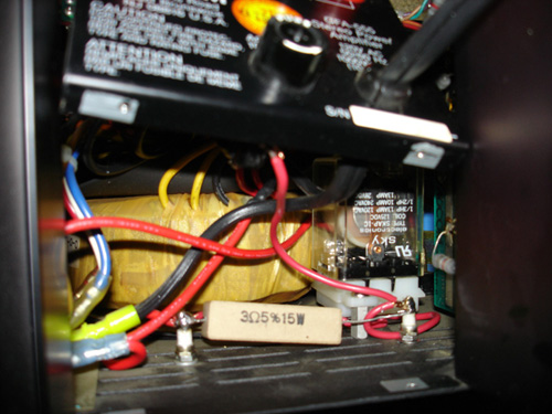

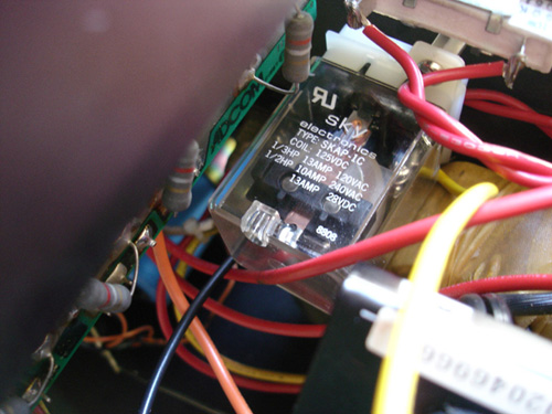

Mod 1 ) Add inrush current limit. This mod is mainly to prevent documented premature failure of the on/off power switch and generally a good thing for larger power amps.
Installed a 3 ohm 15W in series with the Xfrmer primary. Use a 13A NO relay contact to short the resistor when the secondaries come up. The 125 Vdc relay coil senses across both rails of one Amp. Added a 1N4005 free wheel diode on the coil. A 5K resistor drops the +/- 82 V rails to a nominal 120 relay volts.

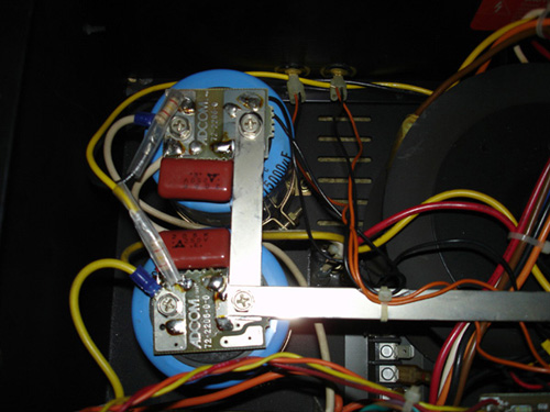

Mod 2 ) Add film bypass caps across each of main caps (15000 uF 100V 4 places).
I added 2.7 uF 250V mylar film. Some people say to add 100-22 uf electro.
