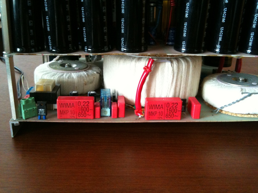

Finish full stabilized 1200W power supply for my new project
Where can I watch one of Your crazy design?🙂🙂🙂
Not that crazy at all compared to yours, mate. No match. :apathic:
A total of 480.000 µF, 240.000 µF per channel. Ungregulated CLC with 2.7 mH inductors.
Trannies are shielded 500 VA per channel. Lytics are Epcos Sikorel, Krummer, Mundorf HC,
Panasonic and a few Kendeils, most of them 100 V 105° LL, some are 125° LL.
Keep in mind it's just an Aleph J (25 W). 😉
I'll have to make some pics of the finished PSU soon.
The advantage of the capacitance after the regulators is that the capacitors supply
the change in current demand from the ClassA amplifier.
Andy, doesn't a Class A amp draw a constant current? 😕

The advantage of the capacitance after the regulators is that the capacitors supply the change in current demand from the ClassA amplifier. The regulators then try to recharge the capacitors back to their DC voltage.
This way the speakers can demand enormous currents that the regulators do not need to pass.
Ummm... this flies in the face of virtually everything ever written about using regulators.
Using series current limiting resistors then allows the caps to "float" freely, mostly down in voltage, but they're not under control. Yeah you can draw extra current with big caps, but then why do you need a regulator at all?
The argument that the regulator makes "perfect" the DC I suppose has some merit, but in practice I'd prefer a choke in that hole over the poor regulator. I'd guess that the output impedance of the supply would be lower with a choke in the hole over the regulator + series current limtiing resistor.
Keep in mind that my Symphony No.1 amplifier first designed and built ~1990 uses about 1/2 Farad in PS capacitance and >4kVA of iron, this for a high bias class AB mosfet amp rated at 180wrms per channel. So, I'm not in disagreement with the idea of big capacitance by any means.
Anyhow, I'd prefer it if the designer answered the questions...
