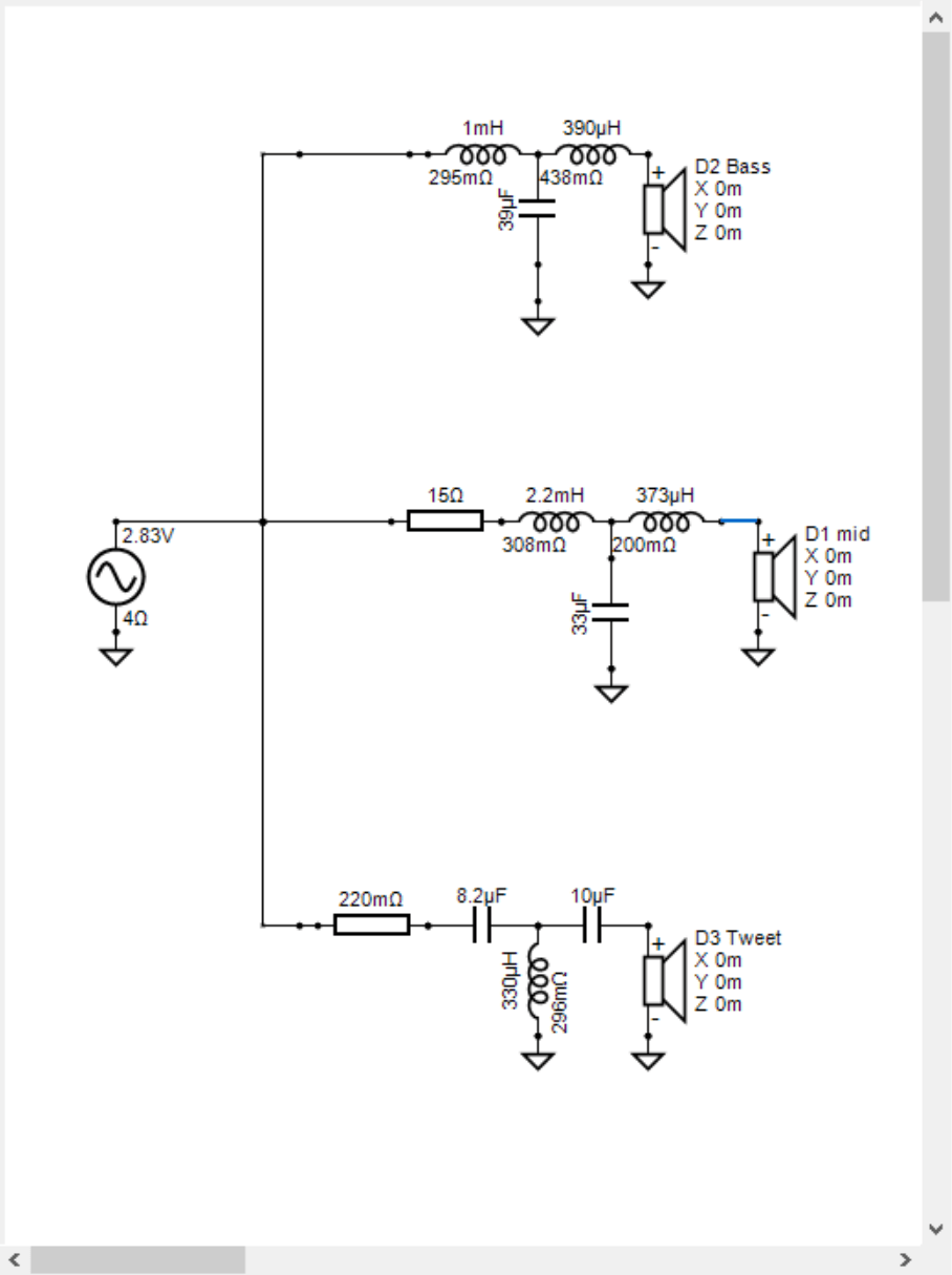

Hello to everyone! I'm really new to the building of loudspeakers and I've decided to build a 3 - way speaker. I picked my drivers from Dayton:
Subwoofer: RSS210HF-4 8" Reference HF Subwoofer 4 Ohm RMS: 280 watts
Mid: PM180-8 6-1/2" Neo Wideband Midbass Driver RMS: 30 watts
Tweeter: ND25FA-4 1" Soft Dome Neodymium Tweeter 4 Ohm RMS 20 watts

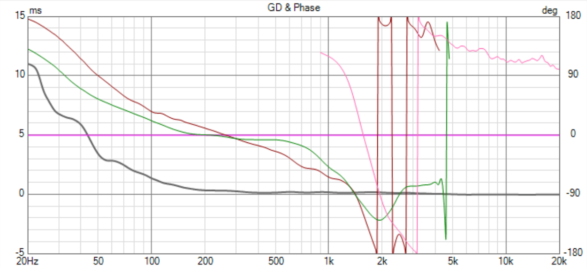

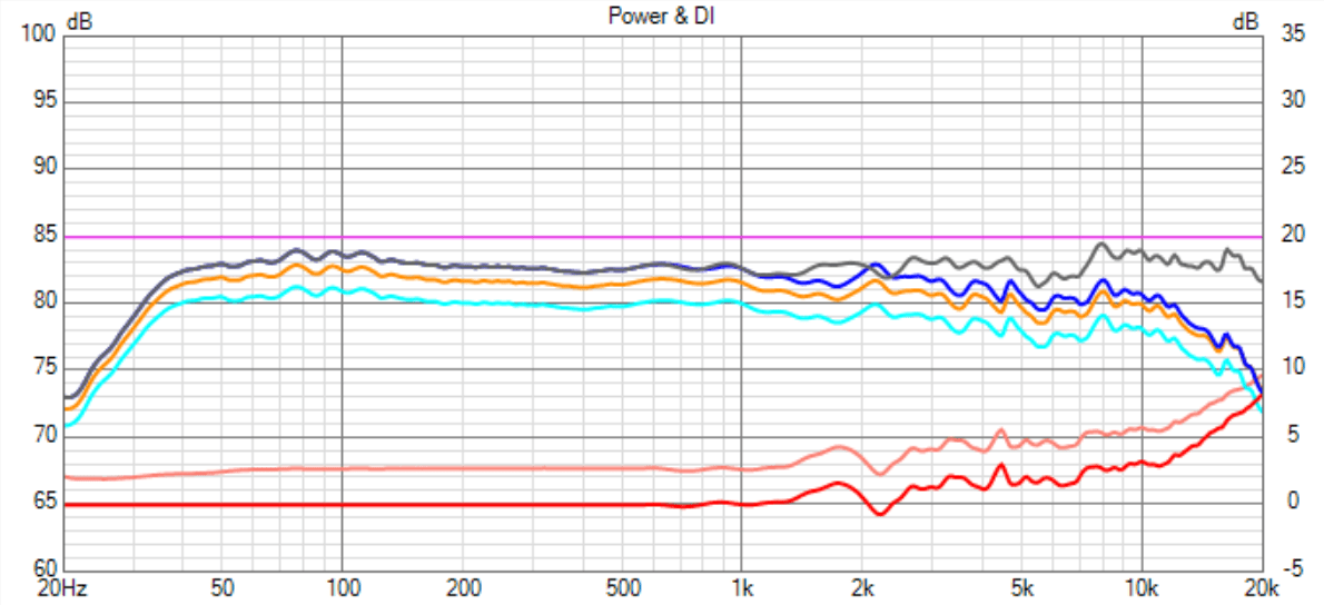

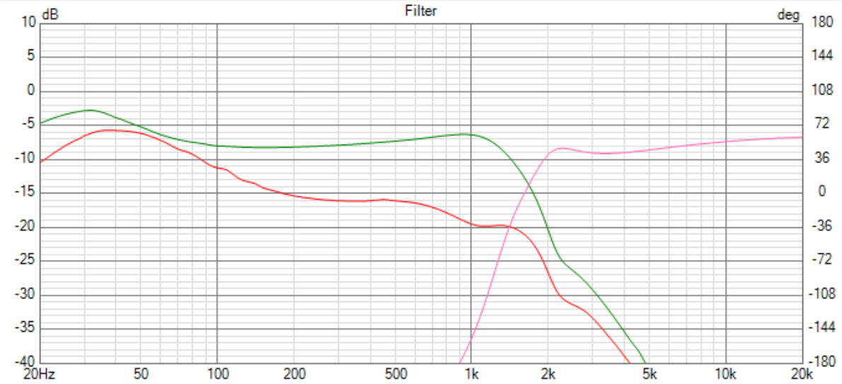

I designed my crossover on vituix and I've attached my design.
My questions are
1. What exact amplifier should I get? I've read so many articles about this and was still unsure: Some say 2 x the subwoofer (which in my case = 560 watts) I am afraid that it might burn my tweeter. I've originally decided to use one amp to power all but if not possible, will two amps affect my crossover? If two amps are a better choice, which ones should I get and how should I connect them together?

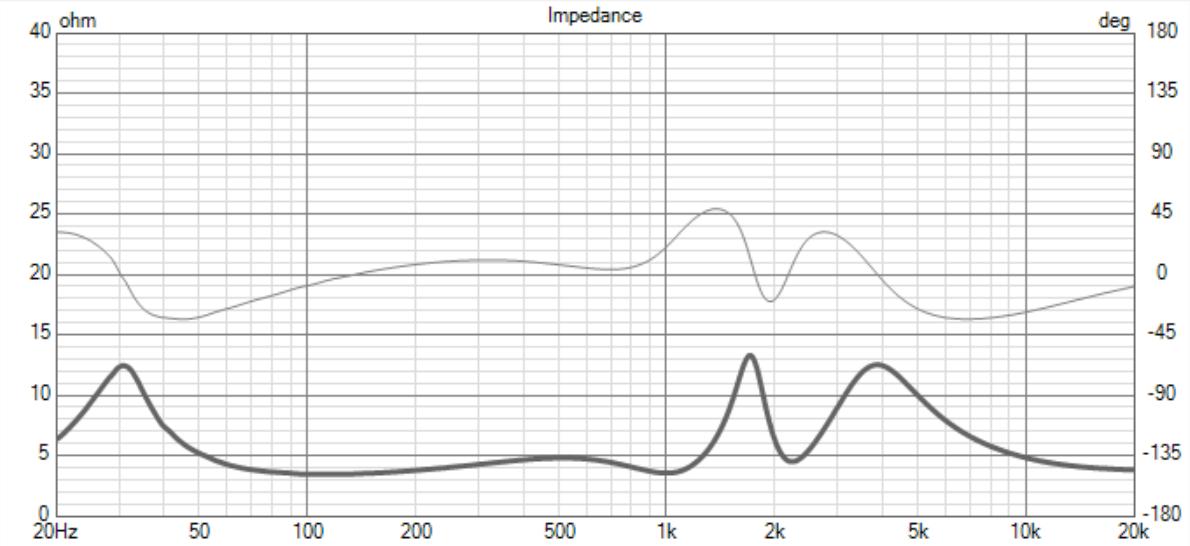

2. I've noticed that the lower end of my impedance dropped to about 3.5 ohms, Is that a bad thing?

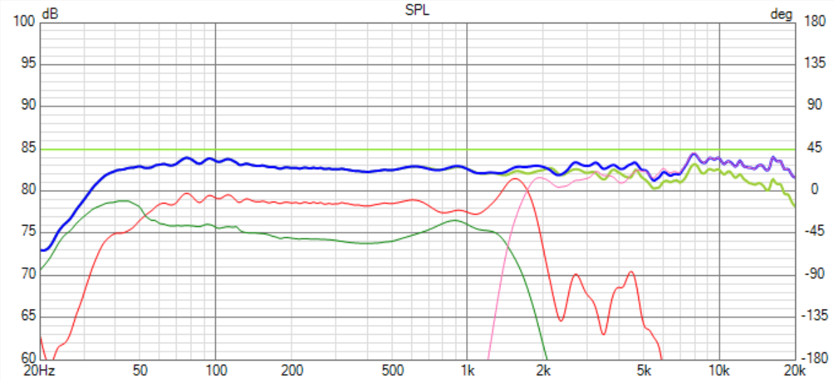

3. Is my SPL curve good enough? IF not please let me know which part needs to be improved!
4. If there's anything ridiculously wrong in the charts please let me know that as well!

This is an unconventional 3 way design. Its more of a 2.5 way. A mid in a 3 way would normally be about 3 to 5 inches in diameter. You have attenuated the mid with a 15 ohm resistor then compensated with the woofer to bring sensitivity back up. The wideband mid-woofer has a rising frequency response which would be difficult to blend with the tweeter. It has higher sensitivity that the tweeter above 1kHz, normally the mid-woofer would be lower sensitivity than the tweeter then you would attenuate the tweeter to match. I would also look up 'baffle step compensation' (bsc) to incorporate into your design.
Thank you for your reply!
I’d like to know is it better for me to switch to a more mid focused driver instead of the 6 1/2 one? Did the SPL curve look weird to you (my humble knowledge only tells me the flatter the better)? What’s more could you give me any advice on the amp that I should use to power the drivers? It’s the part that I’m most confused and concerned. Again, huge thanks 🙂

You can't trust the advertised impedance and response curves, You need to measure the drivers yourself IN SITU.
I use a different tool, but your source impedance is not 4 Ohms. More like half of an ohm.
Are you aware that a 4 Ohm speaker causes much higher distortion in the amplifier, and most AVRs or less expensive amps are not stable into 4 Ohms.
The baffle design, dimensions and driver positions effect the crossover as well as offsets.

Back to original question. With that 3.5 ohm impedance, I'd buy an amp with at least 2 pairs output transistors per channel. Here in US used Peavey PV-4c and M-2600 are not too expensive. Overseas NAD C370 might work. If you want built in speaker protection relay a Peavey CS400 or QSC PLX1202 might be more the ticket.
