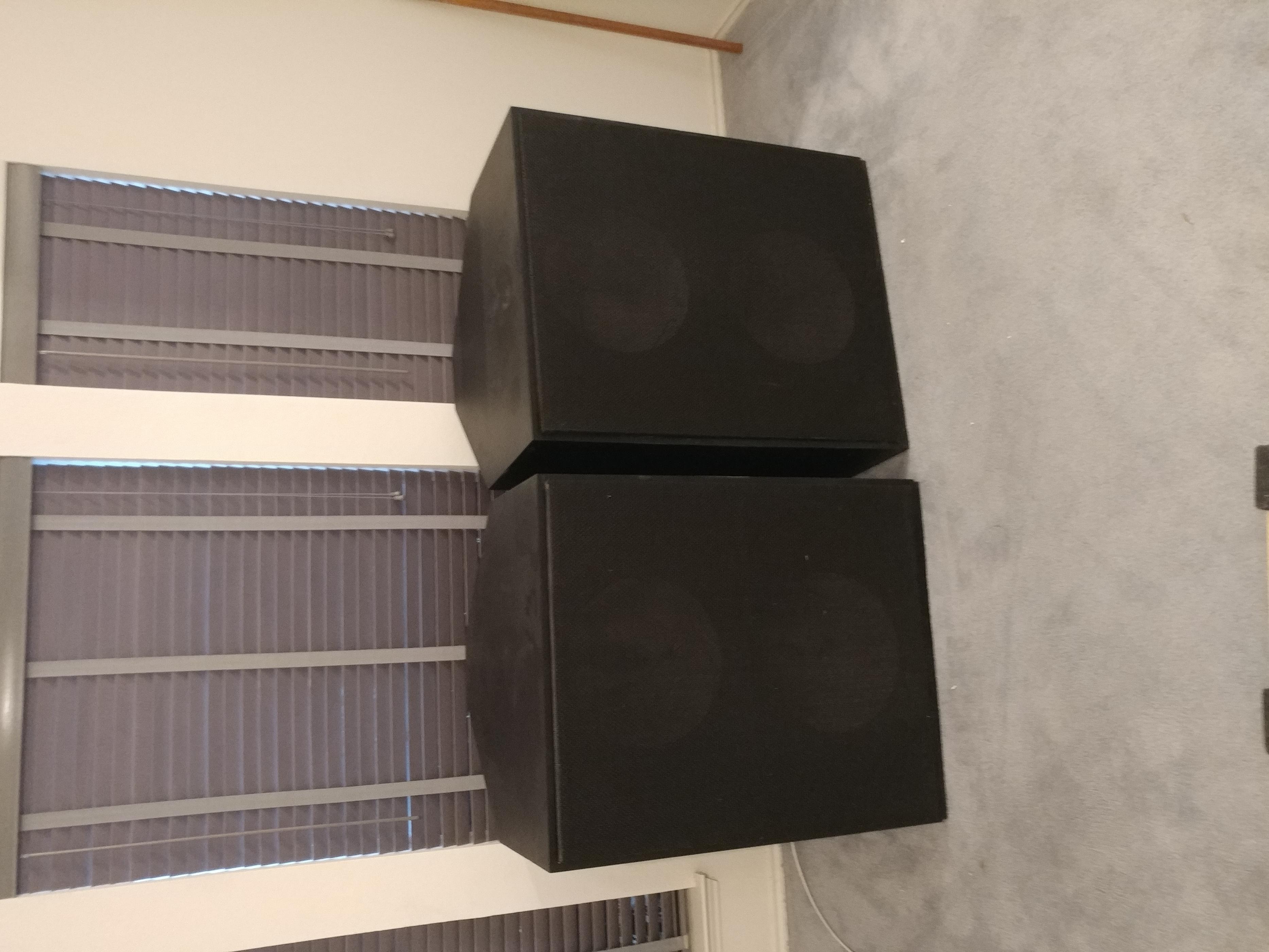

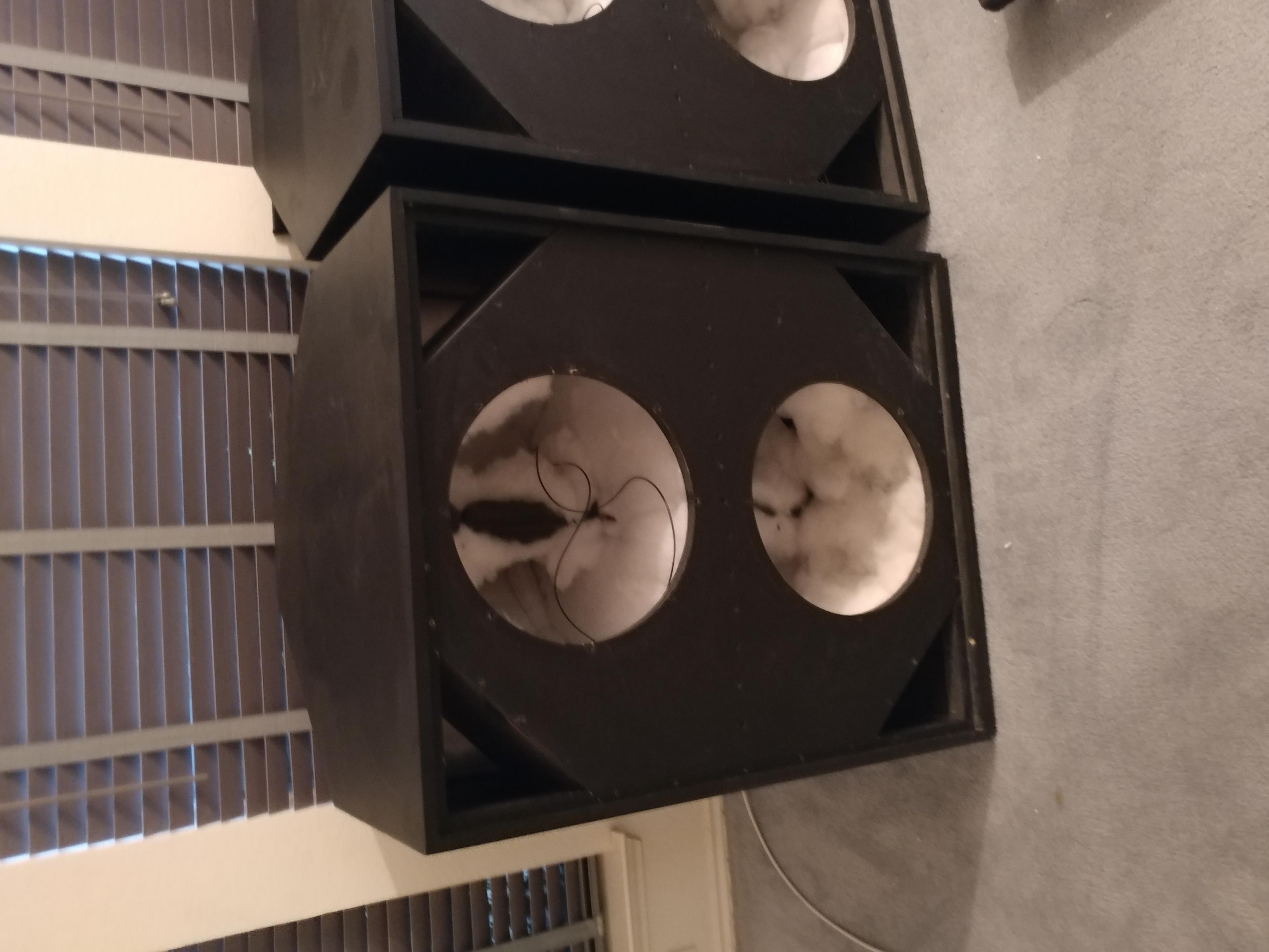

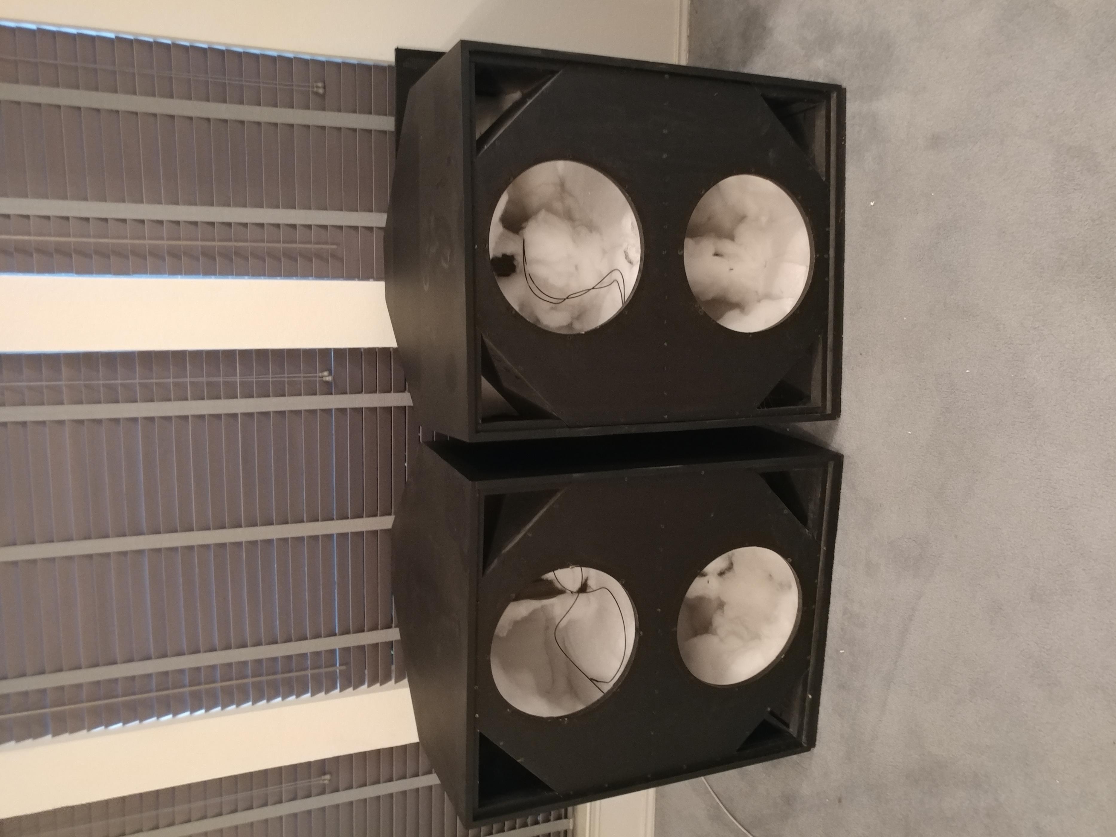

I have an existing cabinet that I got from someone for FREE who was downsizing to an apartment. He took out the drivers to repurpose them. Each cabinet has 2 separate air spaces with speakers connections at the back to connect each 15" driver separately allowing either a series or parallel wiring scheme based on what drivers are selected. I'm driving each cabinet with a QSC CX302 bridged to mono (1200w @4ohm, 700w @ 8ohm)
I took measurements and to the best of my ability to measure the internal volume of each part of the cabinet is 6.4 cu ft. There are 2 triangular shaped ports that tune the cabinet to around 32Hz with both ports open, but if you block one of the ports effectively cutting the port size in half it drops the tuning to 24Hz. Even with one of the triangular ports blocked the opening is still large enough to avoid port noise.
I've done some research and found a few drivers that might work. Since I have to buy FOUR drivers, cost is a concern. I want to get the best performance at minimal cost. I'll list the ones I've run simulations for and what the results were. I certainly don't know all of the drivers in existence, so I hope that someone in this group might know about some that I haven't considered. This is what I'm evaluating so far along with the pertinent parameters. Of course the end result with take into account the increase in overall db from using dual drivers. I list the impedance to consider what the amp will drive. If I use an 8 ohm driver I'll wire in parallel for an overall 4 ohm load. But if I use a 4 ohm driver I'll wire in series for an overall 8 ohm load.
Dayton DCS385-4 $94.30 4 ohm 300wRMS F3=25Hz 88db efficiency
Dayton UM15-22 $189.81 4 ohm 800wRMS F3=24Hz 86.4db eff
American Bass DX-15 $90.48 4 ohm 400wRMS F3=25Hz 88db eff
American Bass XO-1544 $90.43 2 ohm 400wRMS F3=26Hz 88.5db eff
American Bass XD-15 $121.57 4 ohm DVC (I'd wire it to get 2 ohm per driver) 700wRMS F3=24.6Hz 87.5db eff
Based on what I've found so far I'm leaning toward the AB XO-1544 because I can wire it to get a 4 ohm overall load and get more power from the amp. There is negligible difference in an F3 of 24,25 or 26Hz so the 88.5db eff combined with cost is driving my decision.
Is this the best driver or does anyone else have other ideas?

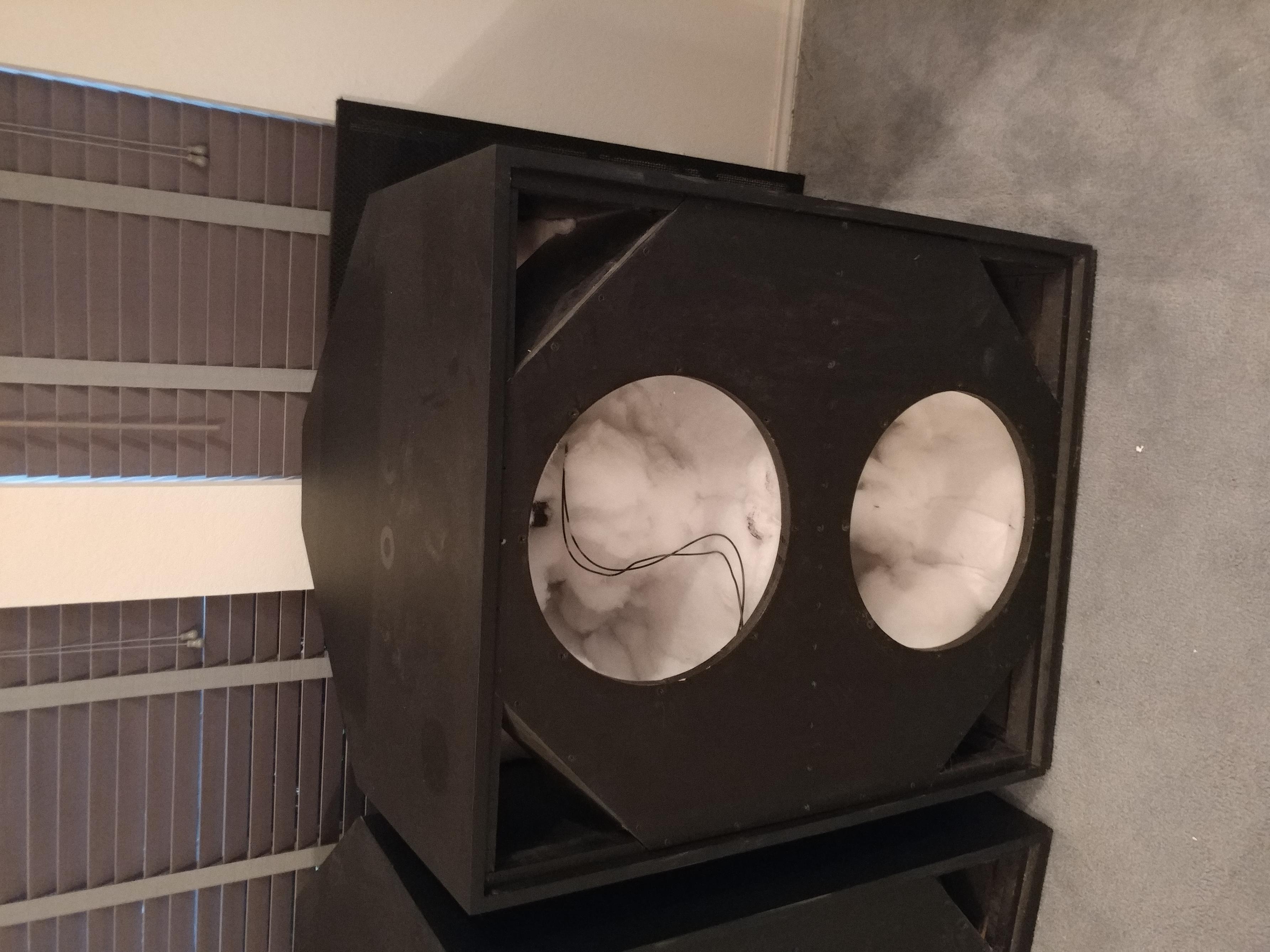

2) the cabinet is already built and there are two 6.4 cu ft chambers per cabinet. There isn't anything I can do about that. I have two ports per cavity in the cabinet and by blocking one of the ports I can change the tuning frequency. I found that blocking one port completely gives an Fs of around 24Hz which seems to work with the drivers I've found. There will be one woofer per cavity with a single QSC amp driving each cabinet (2 woofers per cabinet)

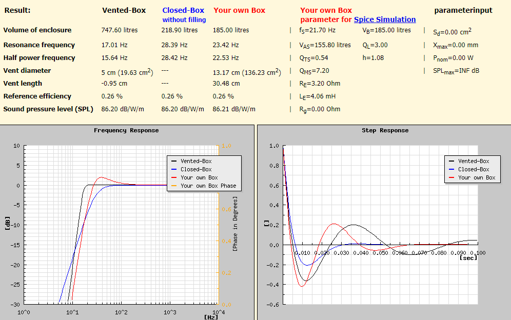

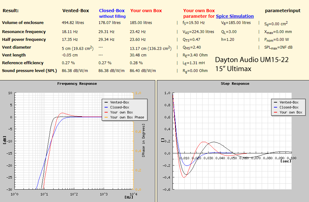

The modeling that I've used so far is the website Lautsprecher Gehauseberechnung mit Thiele Small Parameter. I know there are software programs that are much more detailed, but this seems to give pretty good results for a rough simulation.

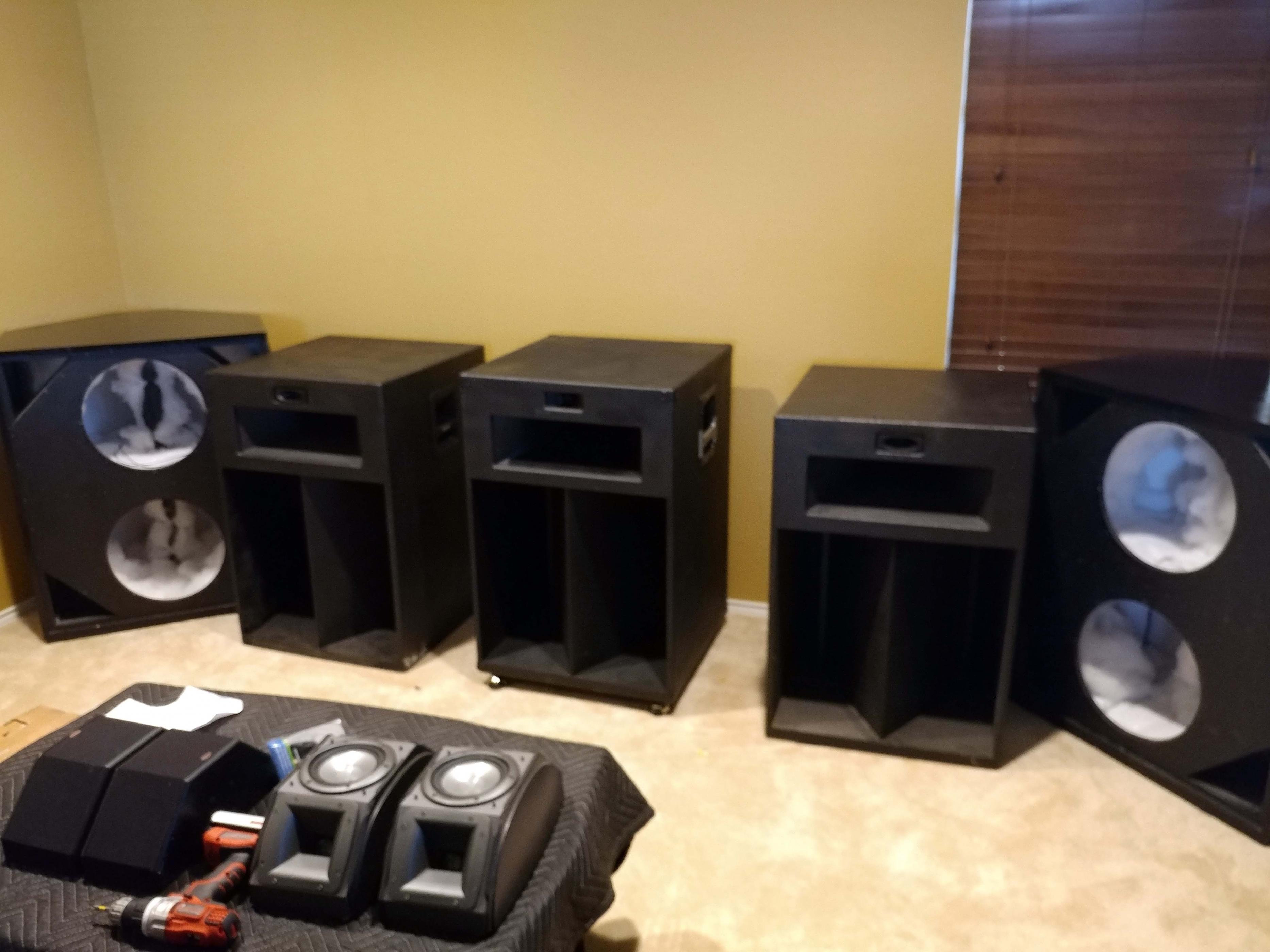

The guy told me that it was designed for the same drivers the Klipsch Cornwell uses (K33-E).

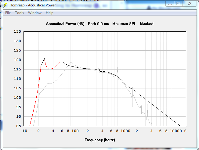

OK, found very different K33 specs, so using the ones that made the most SPL, I plugged in a few well proven sub drivers suitable for, but not designed specifically for, prosound vented, bass horn apps, i.e. mobile audio woofers and not surprisingly [to me anyway], Rockford Fosgate has the best bang/buck in a 15" of the one's I know are still available, but even with Amazon's heavy price discount it's still $192.22 delivered and your cab's vent system is way too small, with a 60+ m/s vent mach/1200 W according to Hornresp :(, so can't use its potential, though at 750 W its good to 115 dB/~22 Hz and worst case may have to critically damp the vent if there's any noticeable port chuffing [sims a narrow spike at ~22 m/s]: Amazon.com: Rockford Fosgate P3D2-15 Punch P3 DVC 2 Ohm 15-Inch 600 Watts RMS 1200 Watts Peak Subwoofer: Car Electronics
Otherwise, the above performance is about the best the cabs can do power ratings wise with the lower tuning, so choose a lower 20-25 Hz Fs, >8-10 mm Xmax depending on efficiency.

GM - you're right. This driver has some crazy good response. Just to compare apples to apples with other drivers I've been comparing I ran it through the same sim I've used on the other ones. I've attached that file. What I found basically matches what Hornresp told you:
Box volume of 185 liters (roughly 6.4 cu ft)
Rockford Fosgate P3D2-15 Punch P3 ($194.22 free shipping on Amazon)
Fs = 23.42
F3 = 22.53
Dual voice coil 2 ohm per
600w RMS
The best performance from what I had evaluated previously was the Dayton Audio UM15-22 15" Ultimax. I've attached the graph for it also. It gave the following performance:
Dayton Audio UM15-22 15" Ultimax ($180 free shipping on eBay sold by Parts Express)
Fs = 23.42
F3 = 23.6
800w RMS
Given that these are more expensive than the American Bass I had looked at earlier, I'm thinking that I could put ONE driver in each cabinet and leave the other one empty (for now) and have a damn good sounding sub. If the day comes where I get some extra money I could always buy the 2nd sub for each cabinet.

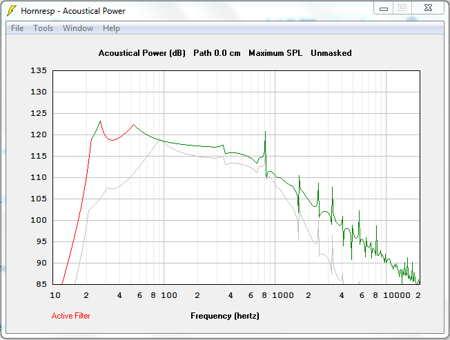

In HR, the only way I know is to adjust the power, Xmax to 115 dB [in this case] for it to calculate the correct vent mach plot.
Since you didn't publish the port dims, I used a single 6" dia. pipe, since it was more than adequate for the higher power listed K-33E.
Hmm, my vent area [Av] is considerably smaller, yet quite a bit longer [15.37"] to get a ~24 Hz tuning, so something's not right; at 7.33" dia. = 42.2"^2 requires a 24" long vent, not 12".
5 % mach is commonly used, though Richard Small [the S in T/S] noted that he couldn't hear any at ~4 %, so with a common 344 m/s SoS, 5 % = < 17 m/s is the recommendation for all but the most extreme apps.

The inside dimension of the 2 equal sides of the triangular port is 7.5" (hard to tell size from the photos). The area would be 7.5 * 7.5 / 2 = 28.125 sq in. To get the radius we use: sq rt(28.125 / pi) = 2.99", so the diameter would be 6". I don't know where I made the math mistake to get 7.33" equivalent diameter but thanks for pointing it out.
With a 6" diameter port that is 12" long and a cabinet size of 172 cu liters (estimating space lost to driver) it gives an Fb of around 27Hz. To get the 24Hz tuning I'm going to have to cut a 12" long 4x4 in half lengthwise and put them in the corners of the port to reduce the overall size of the opening. That would reduce the opening area by 16 sq in, so the equivalent port size is 5" diameter. That gets the tuning back to 24Hz where it should be.
With the smaller port size the airspeed is up to 16% mach (57m/s) which is not good. I need to find another way to drop the box tuning down to 24Hz. Lengthening the port isn't feasible because the box inside wall makes a 45deg angle where the port ends. Since the port isn't a tube, adding another piece of PVC pipe to lengthen it can't be done. That's a task I'll look at another day. My brain is too tired to think any more tonight.
