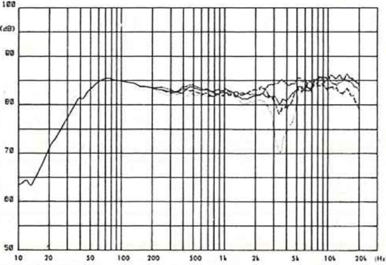

Is there any formula to calculate the Qtc of the closed box from measurements? It’s likely reverse engineering work.

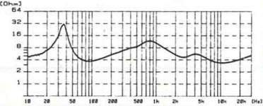

In the design process, I use a Qtc of 0.5 in the calculation. And finally, in the measurement, I got F3 = 28 Hz and Fb = 36 Hz, according to the impedance graph.

You want to use WinISD or simulator for box simulation. Dayton DATS or similar for the basic driver T/S parameters. However if you plan on keeping the woofer/box you have then it's all pretty irrelevant, relying instead on the microphone and impedance measurements as your only two useful guides.

Oh, it's certainly possible... Sorry I have not my my books on hand now to search. 😕
With a QTC at 0.5 and those low F3 and FB frequencies, you indeed have a very large volume, I think... 😉

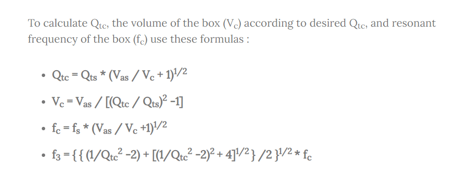

After a quick search, I have found this on the web :
https://audiojudgement.com/sealed-enclosure-closed-box/

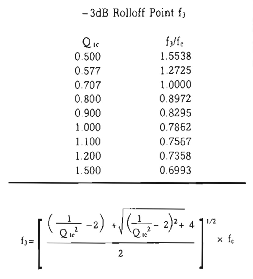

Finally, I have found a hand calculation method from Dickason’s textbook. It provides a table showing the relationship between F3/Fc ratio and Qtc of the closed box system.
Consequently, my speaker’s F3/Fc ratio is 28/36 = 0.78. According to the table, it suggests the Qtc is 1.
So, is this method reliable?
