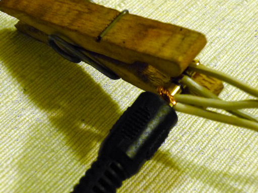

I cut off the made-in-Germany connectors and "linked" the speaker cables to a 3.5mm TRS plug using a clotespin. The output I'm using is a headphone one, and so the volume level is low, but good enough to have a taste of the boxes.
I listened to some early 1970s Canned Heat albums for a couple of hours (trying to be hi-fi, HIstory FIdelity), and liked what I heard. The bass was better than I expected --- I am used to these small oval TV and computer 0.25W speakers. I believe a tweeter can in fact make a difference, but I can't hear much high frequencies anyway, so I am not much concerned. My own "youthful exuberance" endowed me with lo-fi ears for my later life. :clown:
Is there any modifications you think I could try to do to the cabinet? (other than destroying it :smash: ) What should I do if I decide to try getting tweeters?

I hope to build a complete speaker some day, but right now I just want to pick up these speakers to which I am emotionally attached to, and build a "fair" amp for them. So I come to you, my admired speaker experts 😀 and I ask what amplifier would you guess I should build for it. (And I thank for the many nice guesses.)
I finally found the tape recorder they came with. It's a N2405, and the label under it states a power consumption level. My hypothesis of building a 14+14W amp is gone, as the whole equipment takes just 20W!... So I imagine the speakers receive in fact only 6+6W, if much. So I'll probably go for a TDA2007 chip. Later I'll do the definitive test of plugging the thing to a good amp and see how much it can take. (I hope to measure the whole transfer function so we can see its terribly high lower cut-off freq, and the miserably low higher freq limit 😉 )
To finish, here is a pic of my lo-fi adaptor :bigeyes:
