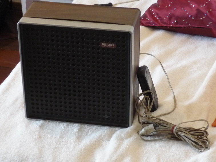

Hello. I found a couple of good-looking old Philips speakers in my parent's home, and I was thinking about using them in an amplifier I want to build. But I would like first to be sure that the speakers would be able to handle the power.
Is there any way to discover the maximum power a speaker can handle by making simple measurements in it? Any theory or rule-of-thumb?
They are 8 ohms and have something like 15cm diameter...

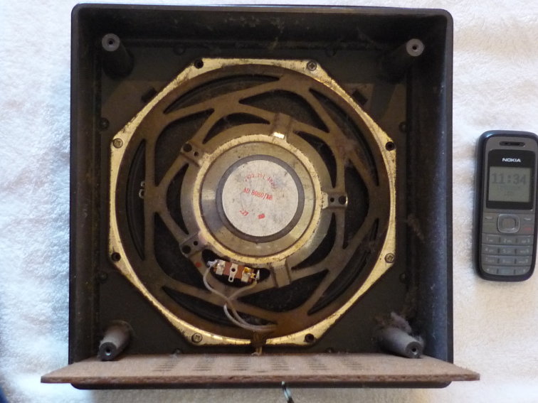

Pop the back of the cab to see the magnet assembly.
1st impressions: Don't put very much power into these.

The application I have in mind is a stereo amp capable of at most 14+14W to use with a computer. For now I am not much concerned with getting low frequencies for example, but just finding out the most I can get from these speakers without much headaches.

While it's tempting to re-use old components, for the large part old speakers are not so good, and are prized more for their characteristic distortion in vintage applications although this is not always the case.

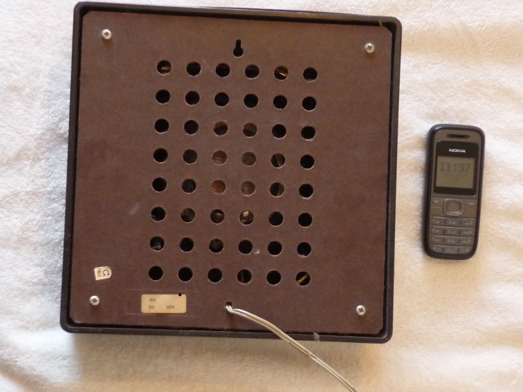

These speakers have a perforated hardboard back, and are instantly identifiable as LoFi. They are not 'good-looking'.

But looking at the back I'd be very careful about bass.

But as someone mentioned, they're not really hifi. They probably will sound pleasant because the perforated back effectively makes them open baffle with damping for the back wave.

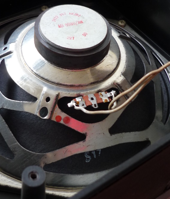

Looks very familiar to me, a Philips AD8080 M4/ or (8) a year 1970 WR driver with fs a few Hz above 70 Hz/ max 18 kHz and 6 W max input power.

Almost correct, bjorno, it's a AD8080 X8 speaker which differs from the M8 with an fs of 95 Hz and max frequency range to 10 KHz but otherwise the same.
It was not considered a good speaker by any means at the time, and certainly now almost 40 years later they probably wouldn't hold their own against $2 bargain bin speakers.
I suggest throwing them out and not waste more time on them.
Known specifications:
Xmax/Xdam: 3mm
Fs: 95 Hz
Frequency range: Fs - 10 KHz
Impedance: 4 Ohm
Rated Power: max. 6 Watts (or 10 Watts depending on production month but most where 6 Watts)

Thank you Saturnus for correcting me, I just glanced at the pictures and drew a too fast conclusion, I also took a look in my old drivers collection but didn’t find anyone.
At that time (late sixties) you could find those drivers in Radios, TV-sets and you are right, they are/were lousy drivers even for DIY’rs and I remember both types had huge peaks between 2-5 kHz, the 8080M more than 10 dB and 8080X around 15 dB.
