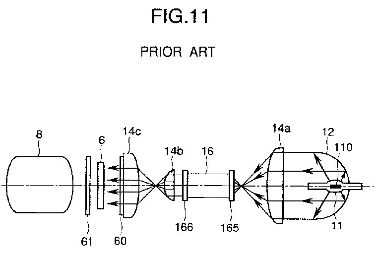

Found these formulae in a patent (5,765,934) describing orthogonal parabolic reflectors:
Y=2{f(f+X)}.sup.1/2 where -f.ltoreq.X.ltoreq.0 Eq. (1)
Y=2{f(f-X)}.sup.1/2 where 0.ltoreq.X.ltoreq.f Eq. (2)
where f is a focal length of the paraboloid located on X-axis of a coordinate (X, Y);
I barely understand parabolic math! Anyone understand this one?
FYI - That same patent has some very interesting ideas which seem to apply directly to what we're trying to do with our reflectors - make non-point-source light behave as if it is. One thing which caught my attention was the use of optical fibers. Here's an excerpt:
The optical performance of a projection type display using a light valve greatly depends on the illumination optical system that illuminates the light valve, particularly the characteristics of the light source. Liquid crystal projectors use a light source such as a tungsten halogen lamp, metal halide lamp, and xenon lamp. These light sources are not an ideal spot light source, while the light emitted from a non-ideal light source is condensed by a reflecting mirror such as a parabolic mirror, elliptic mirror, and spherical mirror that have a substantially ideal shape. As a result, the image projected on the screen is not uniform. Manufacturing variations of the lamps are also a source of significant differences in efficiency, color temperature, and useful life of the lamp. Such differences cause non-uniformity in brightness and color of the projected image, deteriorating the quality of the projected image.
In order to solve the aforementioned problems, Japanese Patent Preliminary Publication No. 4-204883 discloses a liquid crystal projector using optical fibers. FIG. 11 shows a general construction of the prior art light source apparatus for the liquid crystal projector.
An illumination system is constructed of a metal halide lamp 11 and reflector 12, and the light emitted from the system is condensed by a lens 14a. The light is then incident upon a bundle 16 of optical fibers to which connectors 165 and 166 are connected. The bundle 16 of optical fibers includes a plurality of element optical fibers, and the arrangement of the element optical fibers at the end at which the light is incident are not correlated at all with the arrangement of the element optical fibers at the end at which the light is emitted. This ensures that light having uniform distribution of intensity throughout the overall light pattern is emitted from the light-emitting end of the bundle 16 even if the intensity of light at the light-incident end of the bundle 16 is non-uniform. The light is diverged by a lens 14b before illuminating a liquid crystal panel 6 which has a condenser lens 14c and two polarizing plates 60 and 61. The output of the polarizing plate 61 then passes through a projection lens 8 to project an image onto the screen. The projected image with a uniform intensity is thus obtained.

Mitch,
The reason for the optical fibres is to increase uniformity in the light hitting the LCD.
The idea behind them is that the optical fibres receiving the light from a particular area do not all output into the same area of the LCD. They are mixed and moved around so that any hotspots coming out of the light module are distributed throuought the area of the LCD.

Here's some starter info.
Optical fibre is a (usually) very thin strand of high quality optical glass surrounded by a sleeve of a material with a different index of refraction . Then a protective coating is applied to protect from mechanical damage The idea is light rays entering at one end travel the length of the fibre with very little attenuation. Many telephone long distance links are fibtre optic. A fiibre optic cable can carry thousands of times as much as comparable copper lines or coaxial cables. Many buildings have a fibre optic backbone cabling system for high speed computer/ communications. One of the many advantages of fibre optic cables is the fibre can be bent around a shallow radii and the light inside is not lost or disturbed.
It follows the curve with very little loss by a process known as total internal reflection.
An orthogonal parabolic reflector is not a parabolic reflector. It takes a line source of light for example a long halogen fillament or any other long type filament, collects the light and focuses that light to a point. It does not in itself give you parallel rays as a regular parabolic reflector does. The advantage is it is the only type of reflector that can focus a line source light. Other types of reflectors such as elliptical or parabolic require a point source for best results. There is information and drawings on a orthogonal reflector in the video projector part 1 thread.

remp said:There is information and drawings on a orthogonal reflector in the video projector part 1 thread.
I should've used the search function - Good stuff there. Thanks!

Hey, if somebody would draw up a more detailed diagram of just the fiber optic part of (fig 11) from page 3, that would be neato... cause it wasn`t very helpful to us who know next to nothing about fiber optics. I have been researching though and I am learning a little.

Hi Gunawan,
If the bulb is mounted with the filament longitudinally, then most of the light will be emitted transverse to the filament - into the reflector and out of the front. See my crap picture. This way tends to reduce the amount of light coming out of the front of the reflector directly from the filament itself. Though it doesn't eliminate it.
This is actually the problem with the theory behing the ortho-parabolic reflector. Its design is not to collect and focus MOST of the light from the bulb: its design is to maximise the amount of light that CAN be focussed.
Thus, while you WILL get a point source of light, you will also waste probably 90% of the light from the bulb in getting it.
The best bet, if you want the purest point source of light, is to use an elliptical reflector to bring the light to a point(ish), and use a small diaphragm to mask off everything except the brightest center of that point. You will probably not loose much more than you would if you went for the ortho-parabolic, and an elliptical reflector is easier to make/find.
Having said all that, with the LCD diffusing the output, I STILL maintain that treating the LCD as a self contained light source that decouples the output optics from the lamp optics, and trying to get an even illumination across its back face with roughly parallel light is more important than striving for ultra high optical quality in the light source phase.
A rough point source plus two fresnels, or a rough parallel source plus a single fresnel (before or after the LCD, dependent on taste) should give the LCD a decent enough illumination. If the majority of the light that gets through the LCD is fed to the primary objective then a high quality image should result.

Hi Gunawan,
Interesting diagrams - I like them, but they hilight a problem with parabolic reflectors that I have been mulling around with for a while: both your and my diagrams show the removal the light coming directly from the filament at the center of the apparatus.
The end result is the opposite of a hotspot - a black hole right at the center of the beam...
Would it be worth sunbstuting a small convex lens for the little blocking mirror in your diagram? If its focal length were suitable, and its diameter small enough (<= the diameter of the bulb), it would only affect rays coming from the front of the bulb, and collimate them to the same degree as the rear main reflector. The glass of the bulb itself would destroy the coherence any rays reflected through it from behind, so not much would be lost here.
