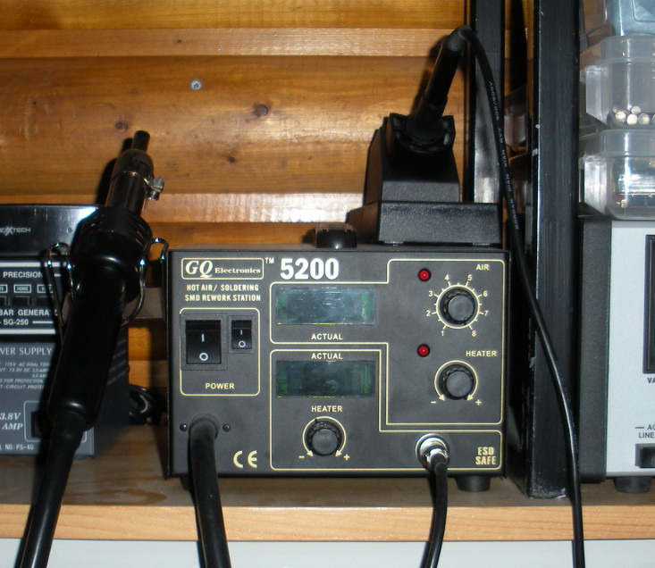

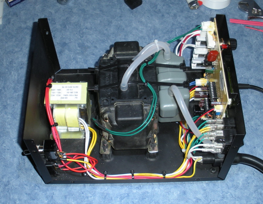

I picked up a 2 in 1 rework station last year, a GQ5200.
I had to open it up to replace a broken tie wrap on the pump assembly, so I decided to make a few other changes while I was in there.
After replacing numerous early failure brand x / no-name electrolytics on various audio, pc, video and power supply gear, I decided it would be a good idea to do the same right away on the rework station.
I also added a power kill switch, to allow for complete power shut down to the unit, after it has cycled itself off in its cool down stage.
I cleaned up and rerouted any wiring that needed it to be safe, as well as cleaned up a few suspect solder joints.
I also did something similar to an Atten APS 3005S power supply.
Routed and secured wiring in a safer configuration, cleaned up a few suspect looking joints, replaced no-name electrolytics with Nichicon pieces from Mouser, replaced the exhaust fan grill with a less obstructive one from an old pc power supply, and installed a quieter fan.
Something you might want to consider when picking up any low cost gear.
Sometimes the quality control and components used are not the best, but that is something a competent diyer can usually take care of.

I wouldn't call the internal parts junk, I just don't trust the brand x electrolytics.
The GQ unit works great, never had any issues with it.
It also came with a bunch of spare parts too, spare iron tips, spare iron heater, spare air heating element, multiple air nozzle sizes.
I don't use the soldering iron though, because I have a Weller WTCPS which I prefer.
I use the station mostly for applying heat shrink, which it is great for.
If you check whats out there, there are 2 main types for the inexpensive hot air units.
One style has an air pump inside the main unit, and an air hose that runs to the hand held piece.
The other style has a small fan unit right inside the hand held piece.
I decided to go with the air pump style unit, and it works quite well.

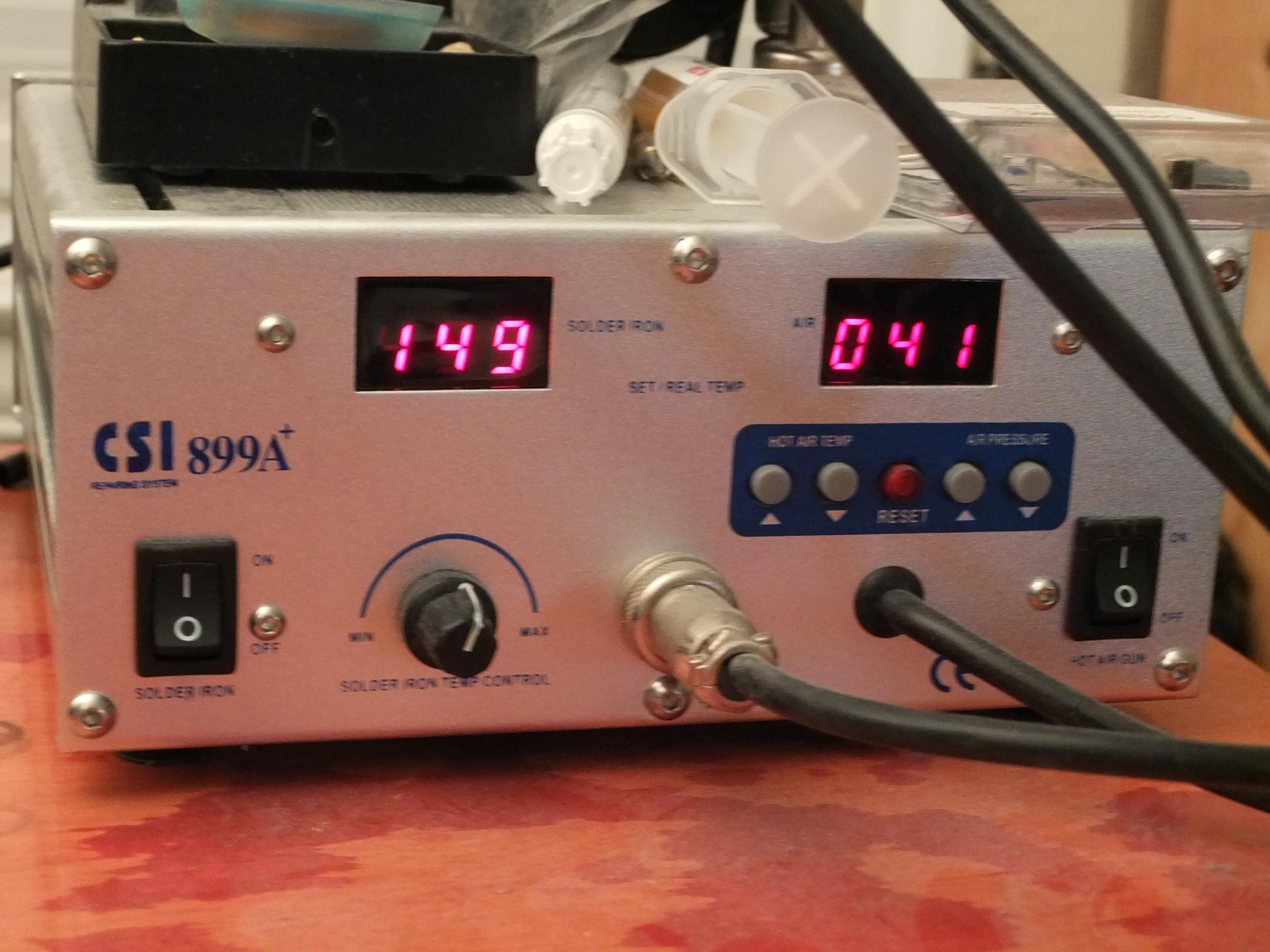

I have a CSI 899A dual station hot-air rework station on my desk. It's great, I use it all the time. I'm sure it's a Chinese re-brand, so you might be able to find in the EU. It's from Circuit Specialists - not sure if the place tinitus mention is the same outfit.
Pic:
Pic:
