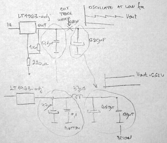

How to solve oscillating on LT1963-adj. I had a inductor and put between small cap after LT, and big 680uF capacitor. Maybe 10r resistor works fine on the same place, i did not try.
Would be much easier to add an 1ohm resistor in series with the 0.1uF. The low ESR 0.1uF is making the chip oscillate, and for the purpose of lowering the HF output impedance, 1ohm doesn't really matter.
Is there any input cap? I didn't see it on your diagram.
Problem is not in input capacitor. Capacitor after LT is to big and LT can not regulate output voltage. I have put small cap on output LT and small inductor between those caps.
After that mod i love this detailed and relaxes sound

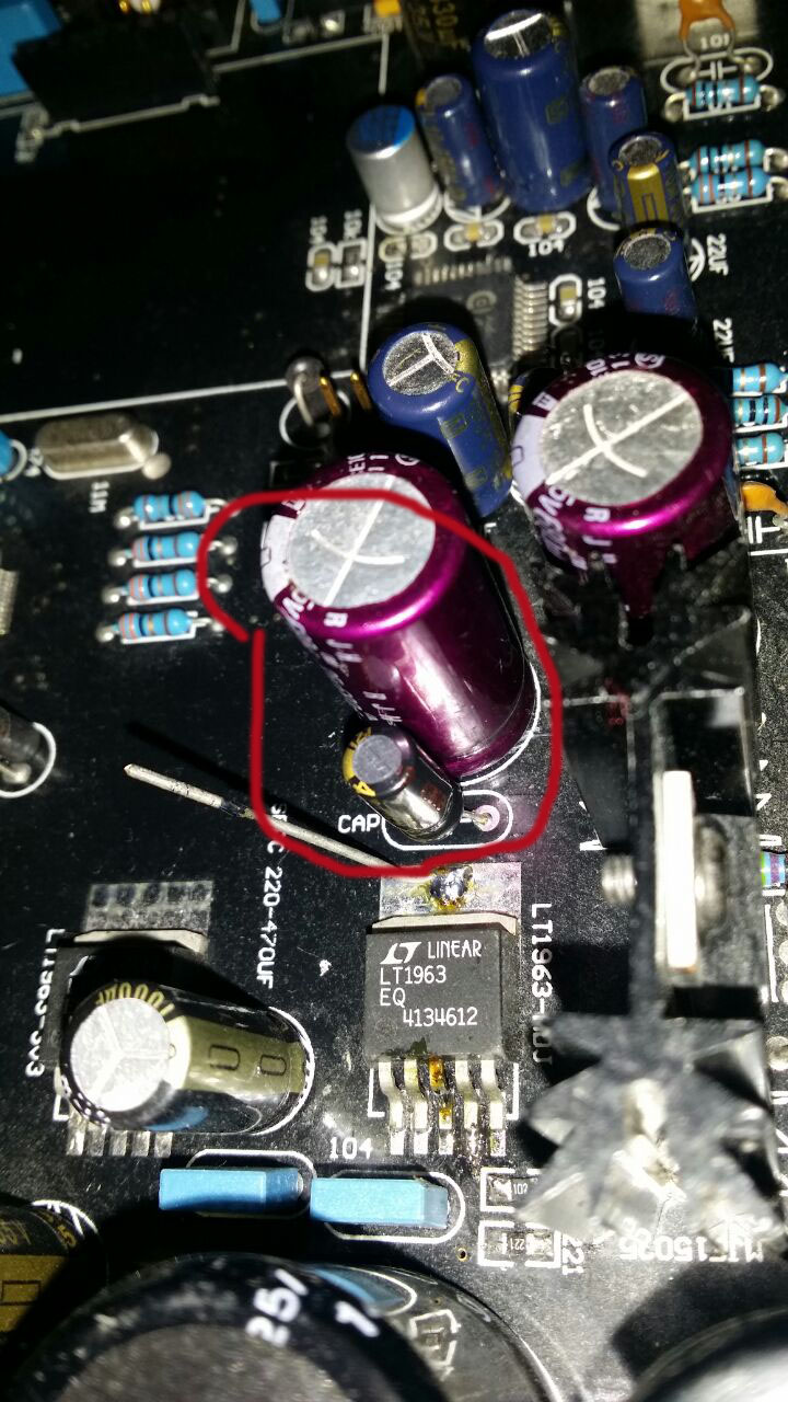

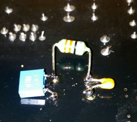

Mod akm4495
Would you show me in detail how to mod this board?Skrstic,
Mods are identified by yellow arrows in the two pictures.
On Above view :
• Restored control over SD and SLOW filter select switches : changed misplaced Dip Switch by jumpers
• Installed resistor attenuator on the output in order to reduce output level (-9,5dB)
• Changed 220uF on VDDL/R and VRefL/R on the output of the 6,7V regulator (LT1963) by 1500uF
• Removed film cap for high frequency decoupling of OpAmp
On Underneath view :
• Turned Off SSLOW filter :
o cut DVDD (+3,3V for Digital domain) track before and after the via feeding pin5 of the 4495.• Resistor attenuator
o Connected the via to ground.
o Reestablished the connection to DVDD (brown wire)
• installed OpAmp decoupling as closest as possible to the chip and with rights caps
• Installed discharge resistor for the 1500uF cap (see above)
That’s it, the DAC sounds OK for now. Next mods are planned in order to replace the MCU by an Arduino and take full control of the AK4495 and 4118. I also have to find a way to check if some critical component (LT1963, Oscon Cap on the Xmos board, 22uF cap around the 4495,…) are not fake.
