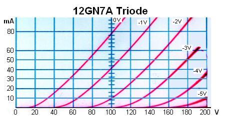

I have a seperate PTX for the filliments of the 6D22S and the 12GN7A. It is 6.3-0-6.3 with (I think) 15amps. I have to make sure of that but I know it was enough to light the 4 tubes without heating up.

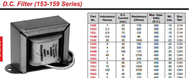

Here are the chokes a friend gave me (thanks Sean) for loading the 12GN7As. I don't know much about choke loading so I am asking if you all think they will work. I am running 350vdc through them.
Opps. They are the 156Cs down near the bottom of the clip

You'll have to run a drop resistor before the choke. With +350V at the top of your choke and an 12GN7 operating point (I assume) somewhere between 150-250V, you'll have (at least) 100V across the choke, resulting in > 27mA – that choke is only rated for 8mA, so....
