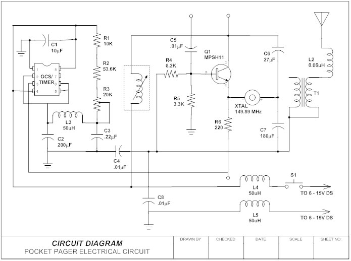

Finally found a schematic drawing tool I like!
FYI for anyone in the same boat... I've been evaluating countless Visio-like programs solely for the purpose of drawing nice looking schematics, saving, exporting, revising, etc. To me the definition of a nice-looking schematic is the simpliciy and heavier line weight of the old Popular Electronics ones. Very few drawing programs have all the shapes needed for tube circuits. But I think my search has ended with Smartdraw.
(SmartDraw - Create Flowcharts, Floor Plans, and Other Diagrams on Any Device)
I was able to draw up a bogus 25 part schematic, never using the program before in about 15 minutes! Wires stay connected and auto-route, line weights adjustable, shapes resize nicely, things stay orthogonal, everything one needs. And here's the best part, they've got at least 50 or so tube shapes! Once you go through all their available shape libraries and find them embedded among passive and semiconductor shapes. Even Klystrons, cold cathodes, directly heateds, CRT's, etc. Many tubes. Like a certain shape library, then just assign it to your drawing and done, I assigned all the electronics and radio electronics libraries. Shapes can even be grouped to form complex transformers or switches, or compactrons, the connectors of all the shapes in a group still work, etc.
Also good is that it's a cloud based software so you can use it anytime a computer is near. It costs 9.95 a month.
Just thought I'd mention it, this isn't spamming I don't think, I've done a lot of work in product evaluating for something as seemingly simple as making a tube schematic. So far this wins for me. I know its not Spice and its not a Netlist, but if just nice drawing is all you need I think you'll like this 🙂
