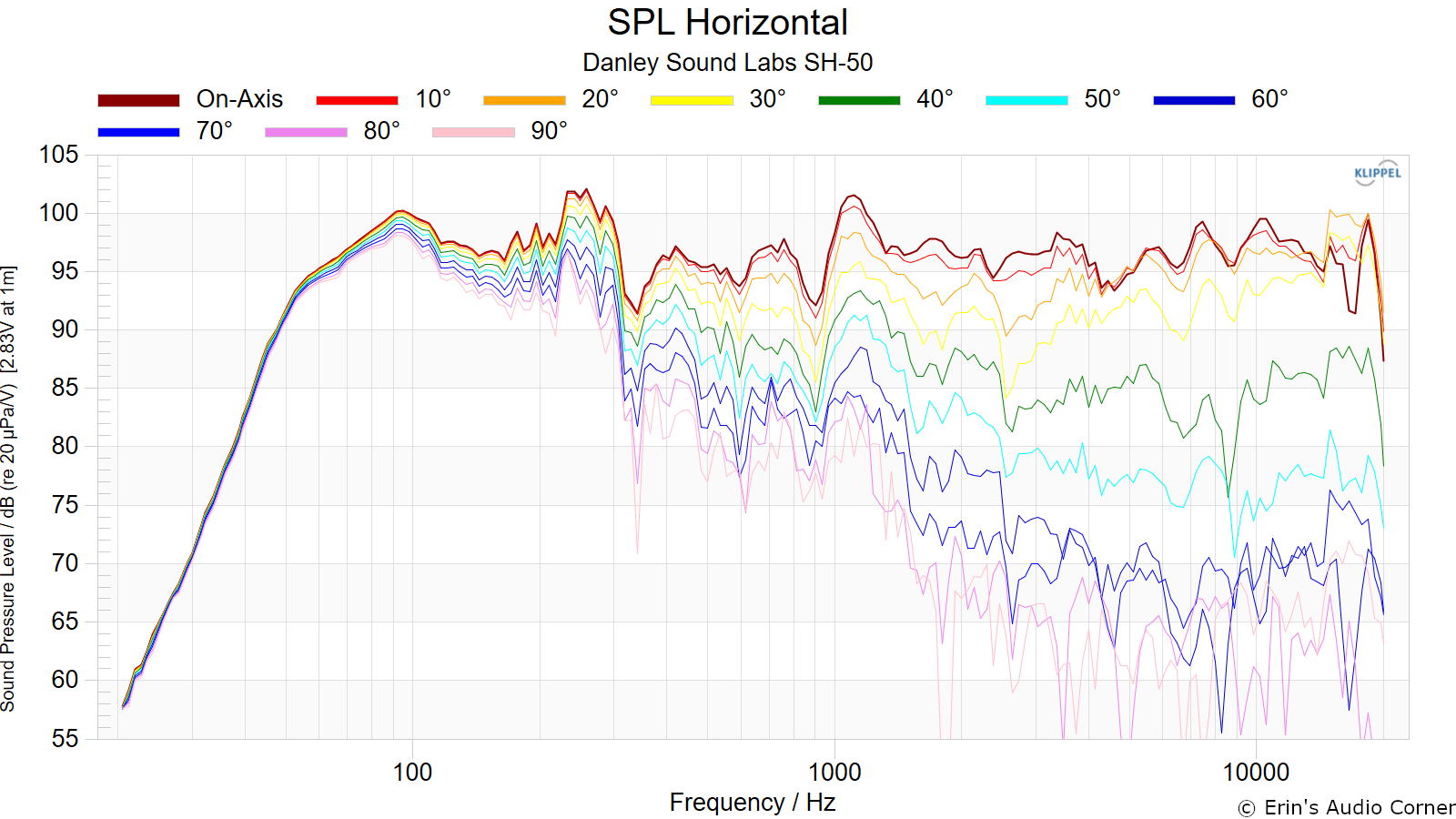

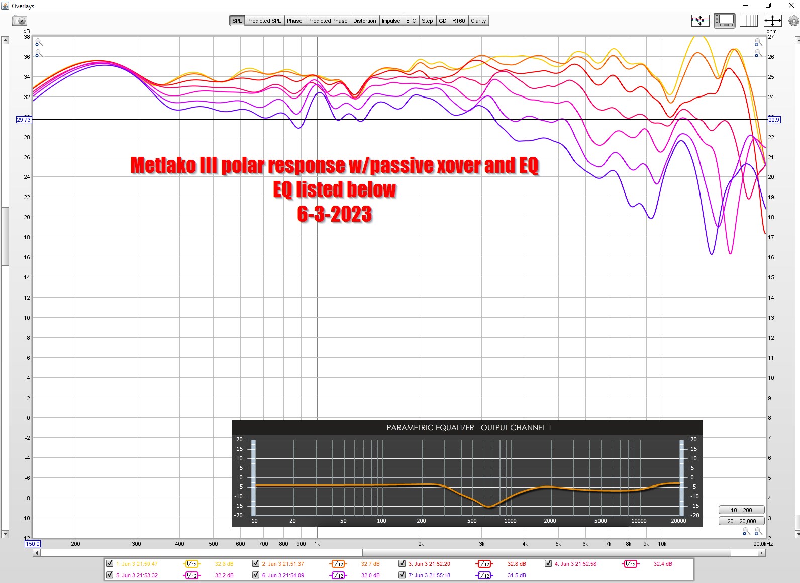

Attached are polar measurements of my latest speaker (waveguide is about 38cm wide, 894Hz is 38cm long) and the Danley SH50 (waveguide is 71cm wide, 478Hz is 71cm long.)
In a nutshell, my speaker should theoretically lose pattern control at 894Hz, but it works to 450Hz, and the SH50 should theoretically lose pattern control at 478Hz but it works to 250Hz.
Note that my measurement goes to 45 degrees off axis while the SH50 goes to 90 degrees off axis, so focus on the first half of the SH50 traces to do a proper comparison.

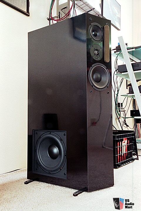

I have a shiny new (to me at least) Xeon workstation here with a pile of RAM and CPU cores, and I need to dig into this one further, but I have a 'hunch' that this phenomenon can be taken a step further by going kinda crazy with the depth of the baffle, a la the NHT speakers from 30 years ago. (pic attached.) To do it properly, the baffle would need to be mostly symmetrical like the Kef blade (also attached.)
There's some common ground with the ambiophonic ideas here too, because in a lot of ways a speaker like the NHT is basically acting like a barrier that divides the room in half, similar to how a good ambio setup can be achieved with zero processing and a physical barrier. I think we've only scratched the surface of this, because to really do this right, it may be optimal to have a metamaterial surface, or some type of absorptive surface, or a specular surface. If the Kef metamaterial technology has taught us anything, it's that the most effective place to "treat the room" isn't the walls of the room itself, it's the first 0.5-1.0 meters around the speaker. I've posted videos of Metlako III playing music, and it's rather startling how quickly the SPL levels fall off as you move away from the speaker. This is because it's a point source and when sound is radiating spherically, it falls off in a hurry. Conventional speakers don't do that well, because in the most important rage (the mid range) the relationship between midrange and tweeter is very complex. In a conventional two-way, the radiation is anything but spherical at the typical crossover point of about 2khz, as well as a range bracketed above and below the xover point. This can be easily seen in the vertical polars.

Hi Patrick, We appear to have different understandings of "pattern control"
My understand is that it means: referenced to some quoted angle, how low in frequency does a horn/waveguide hold radiation to that angle, before the radiation widens beyond that angle. And that frequency, is customarily quoted at f-6.
So in the case of the SH50, its horizontal control needs to be assessed in terms of its 50 H deg reference angle.
I haven't seen what you consider you speaker's pattern control angles. (H-V pattern)
I go by Keele's classic rule of thumb formula that GM showed in #8.
This simple formula is of course for a single section's horn/waveguide wall angle, and putting a horn/waveguide into a larger baffle will obviously lower the frequency pattern some, before control collapses. Ala a simple baffle step effect (better said baffle ramp imo)
On the SH50 polars you posted, my understanding of pattern control leads me to look from the high freq end down, to where 25 degrees off axis, begins to get closer than -6dB to on-axis response. I'd say that is occurring somewhere around 600Hz...fairly close to the 714Hz rule of thumb calc. (Looking between the SH50's yellow and orange polar traces you posted.)
Anyway, I'm self taught and find myself misconstruing things every now and then.....
How are you using the term pattern control?
