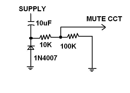

This circuit works for me. The 10K is to limit current into the mute pin on power down.
( needed IMHO as Absolute Max input for Mute is -0.3V )
I use a linear supply with enough filter caps to decay slowly...almost no pop heard on power down.
Hi Doug, In your circuit here, what does SUPPLY represent? Is this taken from one of the PVCC pins, or does it just tie directly to the DC power input? (in my case it's a 19VDC supply)

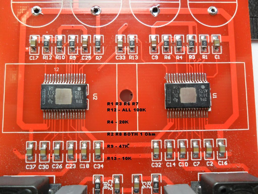

Did you end up fixing your board? Can you post some photos if so?
