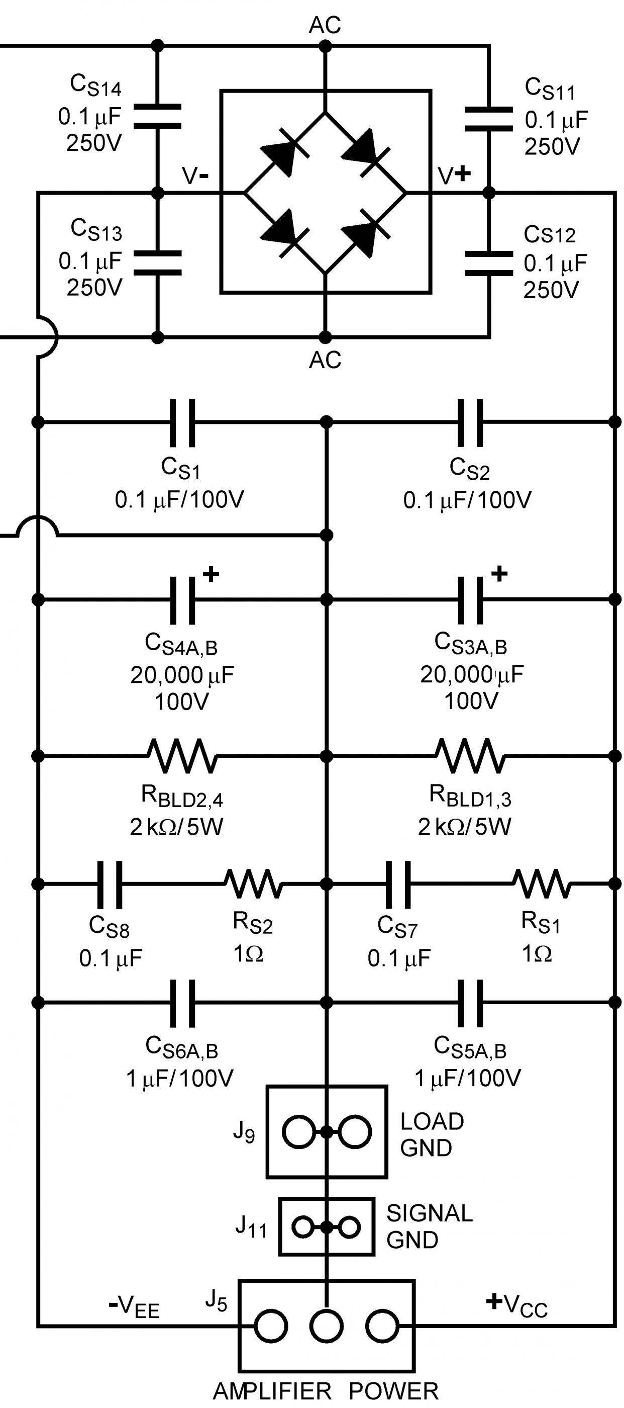

Yes, I see it.
In fact, they state
Now I'd love to know what's the measurable or audible effect of that.
As in:
What's the impedance difference between a 10000uF cap and a 10000.1uF one?
What's the ripple difference between a 10000uF cap and a 10000.1uF one?
and so on.
Before you tell me "what about high frequencies"?
Well, I already see a .1uF cap in parallel.
What improvement might make adding a 1ohm resistor in series is beyond me.
Mind you, we are talking *this* , line frequency PSU ; in SMPS it's a whole different World.
As a side note, even if that PSU design "comes from TI", it might very well be the pet idea of somebody working there.
I found it strange, to say the least, their specifying the *Brand* of all components, up to specifying "Panasonic 1 ohm resistors". ¿¿¿¿??????????????
That said, TI themselves add the following statements, which match my concerns and then some:
But this is the final "sledgehammer in the head" disclaimers:

Isn't this schematic wrong? The negatives from bridges connected
I was understanding that the negative from the top bridge is connected to the positive of the bottom bridge to create the 0 ground reference. all of the Carlos fm schematics on the internet are connecting the negative to the negative? Now the bottom rail has the negative from the bridge connected to the positive of the capacitors?
This doesn't look correct.
Please post one of them here as an image, otherwise the one we find may not be the one that worries you.all of the Carlos fm schematics on the internet
