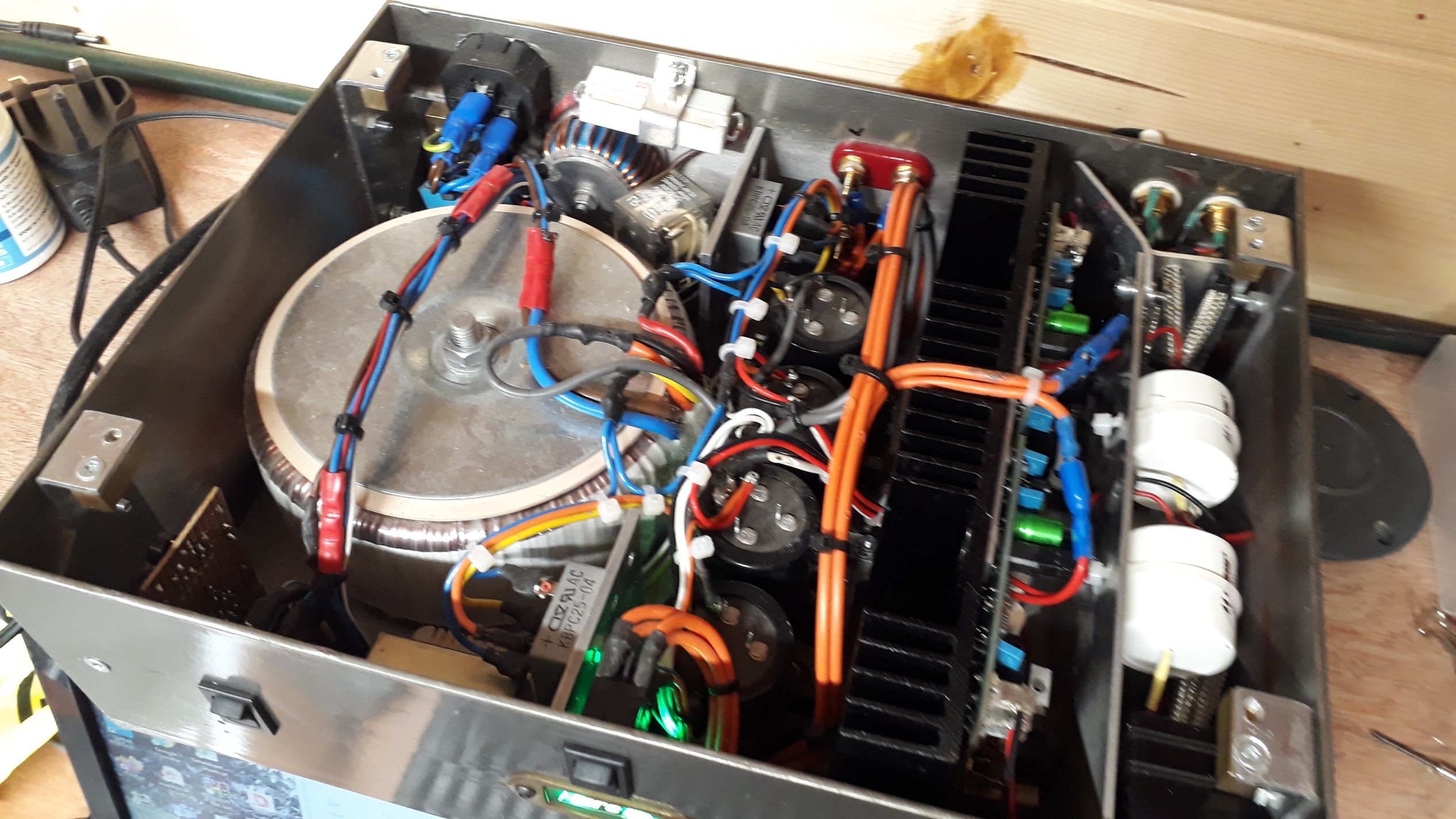

I'm looking to build another power amp and would like to consider using either a CLC (Pi) or CRC filter. It's for +35V - 0V - -35V 100W amp. Three questions:
1. Is it possible/sensible (legal even) to use inductors designed for crossovers?
2. How do I calculate the required inductance value
3. Is it sensible to have a high value cap first, then the inductor then a lower value cap?
Also (sorry if I'm asking too much) how do I calculate R value and power in a CRC filter.
AS you can (hopefully) see there is no room for extra, well anything really. But a really helpful response. Just wondering what is big in inductance terms - familiar with capacitance but less so inductors when it comes to power supplies.
The L in a CLC filter is for filtering the 120Hz ripple and harmonics. Unless the first C is
quite large (much larger than most rectifier tubes can handle), there will be a lot of
voltage ripple on the first C (tens of volts). You can download PSUD and experiment.

All of the inductors I ever used in CLC were xo inductors in the mH range. One even has a steel core.
You just want to be sure the inductor doesn't get too hot from the heat (P=V^2/R) of its internal DC resistance, and that you account for the voltage drop in the rails.
Say you want a low pass filter with the corner at 12Hz to significantly attenuate 120Hz ripple.
Then 12Hz = 1 / (2Pi x sqrt(L x C) )
If C = 20uF, after rearranging we have:
L = 1 / (20uF x (2Pi x 12)^2) = 8.8 Henries

Very few solid state amplifiers use inductors in their power supply.
As a simple example a 300ohm + 470uF as a RC filter gets to 1Hz as a low pass with a suit case of issues - the current for capacitor, the current through the resistor (at inrush) and the voltage drop 300ohms gives plenty to think about. Also 470uF wouldn’t go well with valve regulators.

...Is it possible/sensible (legal even) to use inductors designed for crossovers?...
Power filter frequency is lower, so you want more H.
Power filter impedance is higher, so you want more H. (400V 100mA is like 4,00 ohms, rather than 4r-16r.)
You want about 100 times the inductance. You can do this by taking the wire off, slicing it to 1/10th cross-section (1/3rd diameter) (buy new wire!), and re-winding.
If space is tight you sure want modern e-caps not iron cores.
R-C filter: figure how much voltage drop you can tolerate. More drop is better filtering but less audio output. Figure out how much ripple filtering you *really* need (no blue-sky numbers). Do math.
