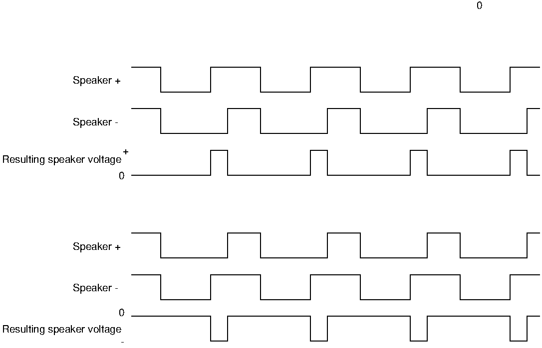

I have always a priori seen class D without an output filter as something for low power use and very cheap designs. Actually, the PAM-chips can run without an output filter and sound surprisingly well. But for TPA3116 and the higher power level, I assumed the EMI to be unacceptably high. Puzzled by your results I started thinking about how an equivalent circuit would look without an output filter.
First the function with an output filter (circuit 1 as appended). It is possible to modulate the output voltage due to the output filter by varying the duty-cycle of the carrier square-wave signal (typically 400KHz). Because the impedance of the output filter choke is much higher than the load impedance at the carrier frequency, but much lower at audio frequencies, such regulation is possible similar to the functioning of a Buck converter.
When the output filter is removed, the carrier signal looks directly into the load (speaker; circuit 2 as appended). First order I would expect the speaker to resemble a resistor (the speaker driver DC impedance) in series with an inductance (from the speaker driver coil). I would expect the inductance to be low because eddy-currents inducted from the coil to the speaker driver pole-piece (probably MU-metal) should reduce the inductance value. I would expect the DC impedance to be dominating of the two. If the class D amplifier is used without an output filter and operating with traditional PWM, the load (speaker) always sees the supply voltage of the class D amplifier and the coil should try to move back-and-forth at the carrier frequency but can’t due to the diaphragm mass and air mass. As result, it should result in high power loss. This was why I asked you to check the idle current consumption. But you are right, the time it takes to bleed-off the charge on the power rail decoupling capacitors is an indication of current consumption. You indicate that this takes time.
There is a different possibility with much less power loss and still no output filter – the possibility that the TPA3116D2 uses its BTL configuration to change traditional PWM modulation into PDM (Pulse Duration Modulation). This is possible by phase-advancing or phase-delaying some switching edges on the carrier signals with respect to one another (drawing 3 as appended). This way the load (speaker driver) will still see the full amplifier supply voltage but only in short moments while in periods the speaker terminals are effectively short-circuited (no voltage). The current surges from the supply rail will be important and that could fit with your observation that good decoupling is important for the sound.
If the TPA3116D2 actually uses such PDM modulation, the operational principle is rather reliable. It can be checked if that is the case with a two-channel oscilloscope but at present I am disabled. I believe you can bring the EMI down to a reasonable level by having very short wires and use some screening as you suggest.
Good luck with the project.

Apologies in advance for the briefness, I’ll take more time later to dive deeper into your message - thanks for the perspectives! Work is conflicting with hobbies!
First, to be clear, my experiments are using the newer TPA3126D2 chip (not the 3116, although the pin assignments are essentially the same) in hybrid mono PBTL mode. I have done lots of experimentation with the 3116, but now I’m convinced that the 3126 in “ultra low idle current” mode is superior. They run very cool in my system (only get slightly warm to the touch) and as I said, the sound quality is exceptional compared to any other class d amps I’ve used.
I look forward to continuing this discussion when I get a chunk of time!
I think this text from the 3126 data sheet on the BD Modulation mode provides a good explanation of the method used to produce low idle currents:
This is a modulation scheme that allows operation without the classic LC reconstruction filter when the amp is driving an inductive load with short speaker wires. Each output is switching from 0 volts to the supply voltage. The OUTPx and OUTNx are in phase with each other with no input so that there is little or no current in the speaker. The duty cycle of OUTPx is greater than 50% and OUTNx is less than 50% for positive output voltages. The duty cycle of OUTPx is less than 50% and OUTNx is greater than 50% for negative output voltages. The voltage across the load sits at 0V throughout most of the switching period, reducing the switching current, which reduces any I2R losses in the load.
Again this is not a feature of the 3116 chip.
