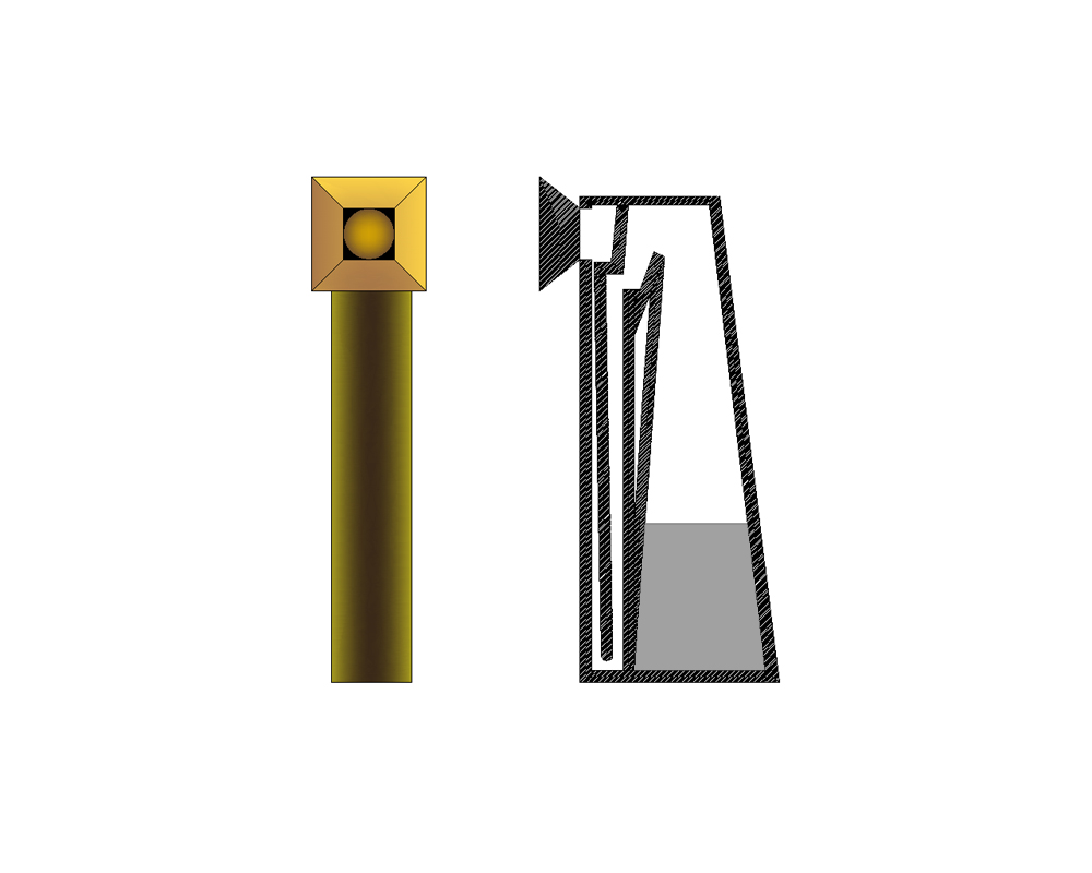

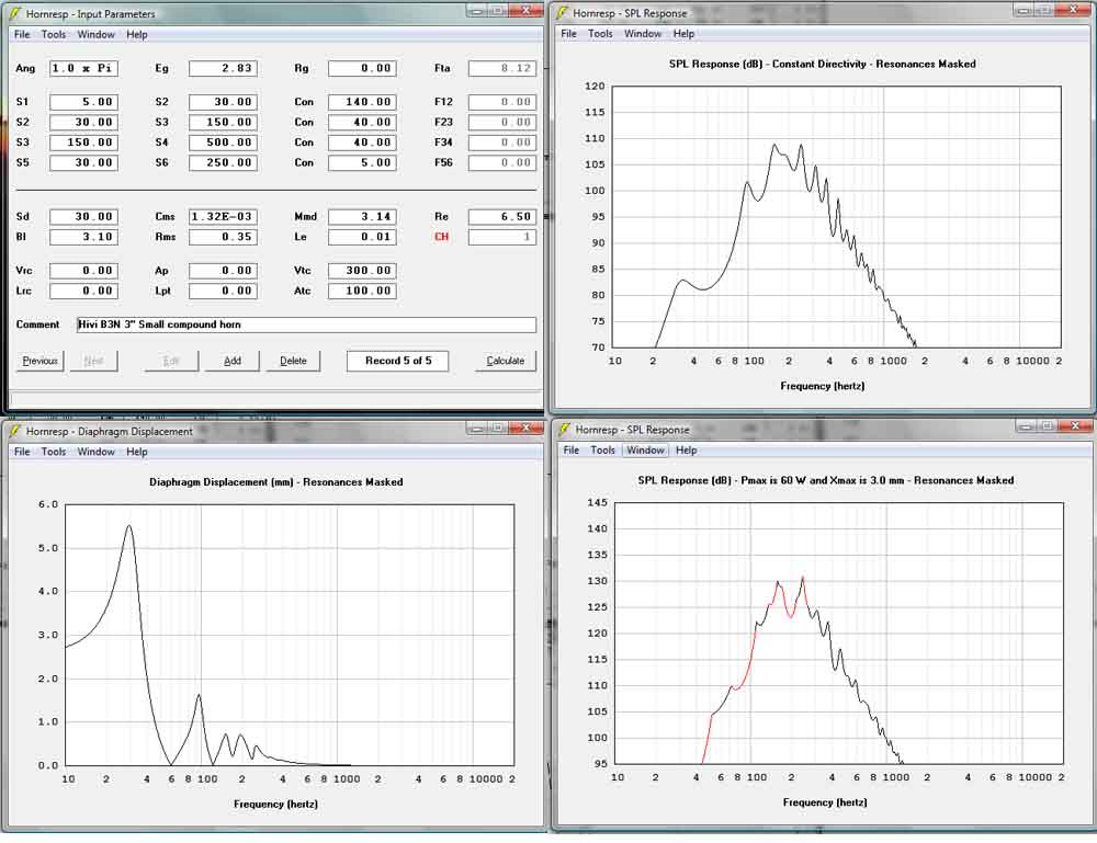

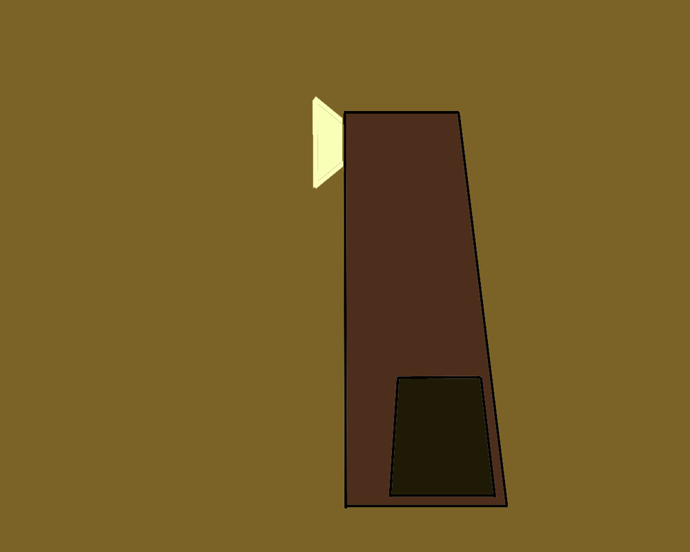

A little question of opinion for the more experienced guys. I designed a compound horn for the Hivi B3N. As it sits the bass is flat down to only about 100hz, but it's pretty small so that isn't so bad. But the pass band of the rear horn models so sensitive that I doubt even a front horn could bring the mids and treble up to match. Now the bass has plenty of excursion left so that max spl is decent down to 55-60hz. My question is this: If I filter the frequencies between about 80hz and 400hz and bring them down to the level of everything else, would this sound good or would a filter have a big negitive effect on the dynamics and speed of the horn design?
Hello brsanko,
did you listen without front horn?
Your horn throat sims very small?
Is the horn mouth bifurcated?
Better no filter, there is a lot of music,
Kammerton a = 440 Hz,
if you get this SPL why kill it with expensive parts,
may be no front horn helps enough.
nice design,
i made a small bookshelf sat horn for such driver,
i listen to it already with my sub double bass horn,
my experience shows that no bass for such single driver
is better in every way, movement goes down and mids and highs are better.

I haven't actually built the speaker but I was looking for a design that was small enough for resale without a sub so bass is important. As for the front horn the 100-250hz region would be about 12db louder than everthing above it without it. At least according to the simulation, and they have proven pretty accurate in the builds I've done so far. For my own personal use I would avoid using filters perhaps using an EQ, but for a commercially viable design flat frequency response is pretty important I think. I'm just wondering what the negative affects of a filter would be. and yes it would be pretty expensive for the parts.
actually I've come up wit a better design that gives lower bass without a filter in a similar sized cab so I guess the point is moot.
