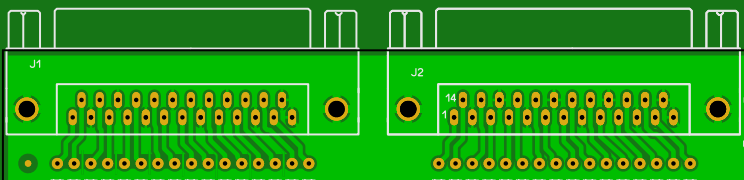

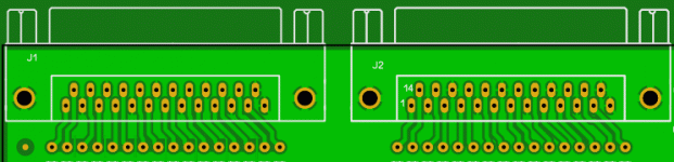

Attached is a picture of a layout of 2 db25 connectors, wired as balanced tascam.
1. My worry is about the small gnd fills in between pins and traces. ¿can they be a threat to crosstalk? ¿should i get rid of them? ¿what can i do to improve the layout?
2. Besides, as i will use filtered 90º angle db25 connectors, that have a planar ferrite in between their pins, i would like to know if i have to take any measure to prevent contact between the ferrite and the gold plated thru holes.
Thank you for your advise!
