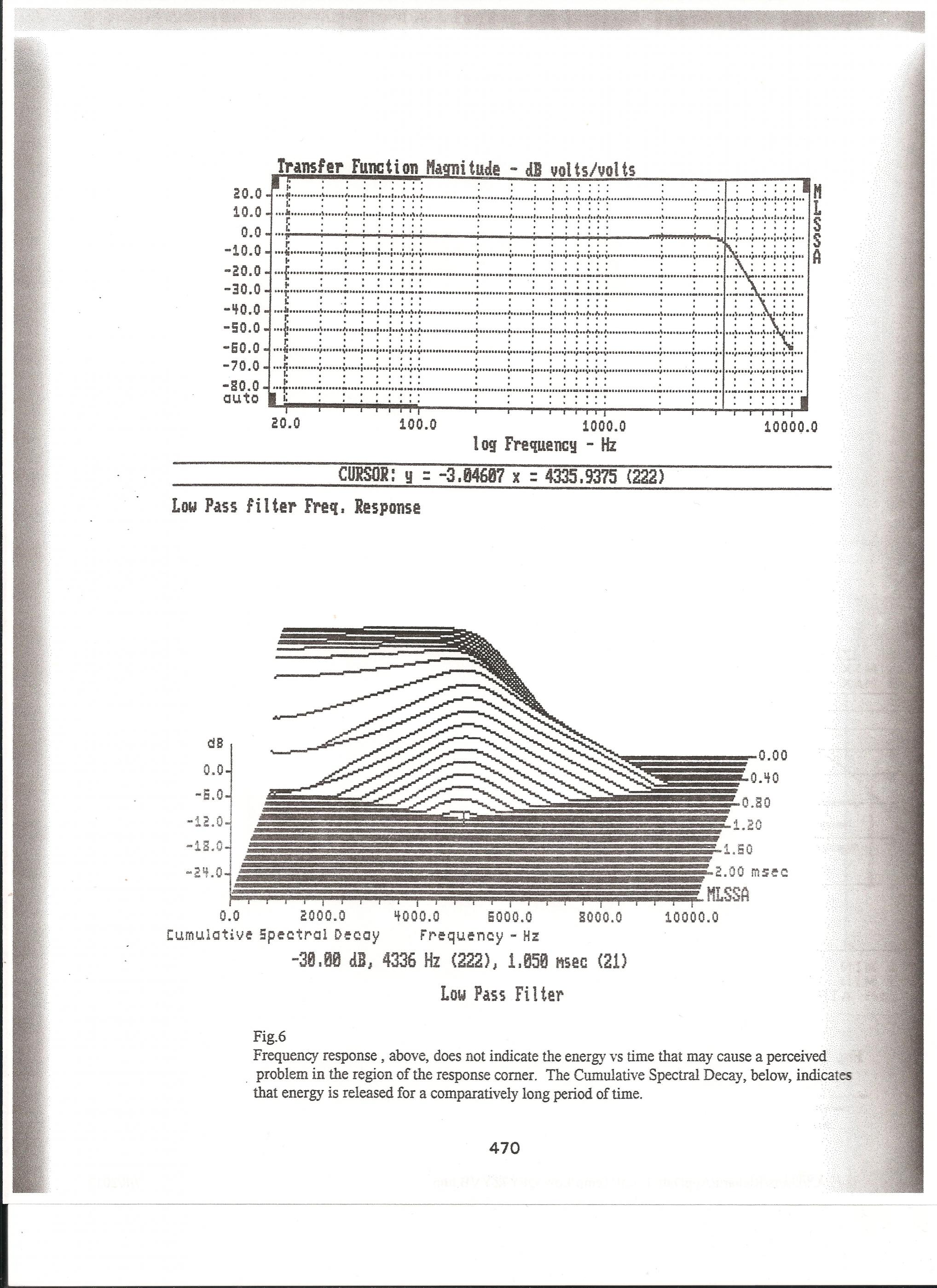

I see your point,but the ~1msec in your example doesn't phase me much tbh.
who cares about that? its only to illustrate a point I am making. the delay can be anything depending on your filter freq and Q.
-RM
Anything? Within bounds im sure,depending on phase rotation id imagine. Imnot sure I follow you entirely. I don't have the ability to model in the way you have demonstrated, any help here?
My LP for eg is 5th order, RC @ 500Hz, 3.8kHz @ Q=0.618, 2.8kHz @ Q = 1.618.
The plot was from an active filter... passive would do same (speaker cross-over etc.) Do you have access to MLSSA or MLS software?
