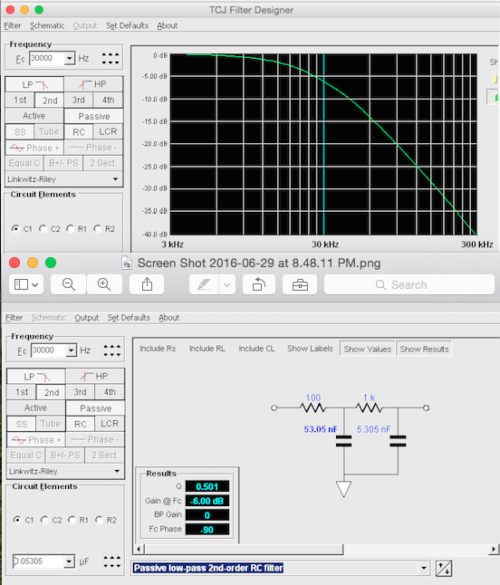

Here is filter to use, plugging it in now.
Half bridge, irs2092.

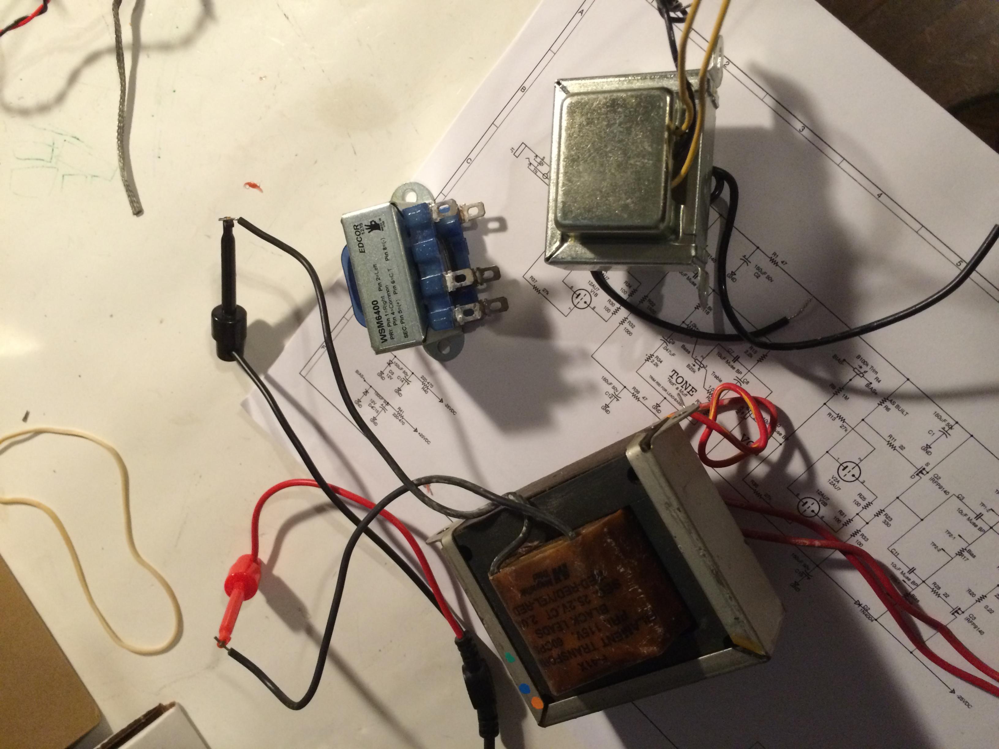

I know now the simple reliable passive solution for diy is transformer isolation.

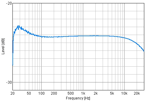

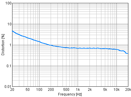

The EDCORS work great but have a 10v max input. So I tried using a few different power transformers and they all worked. Here is some data on the common F-41X. I think 1% THD can be used based on the measurements. So if analyzer said 1.04% THD, the actual is 0.04%. We'll see if it works in practice.
Now can go to 2.5KW without using a pad.

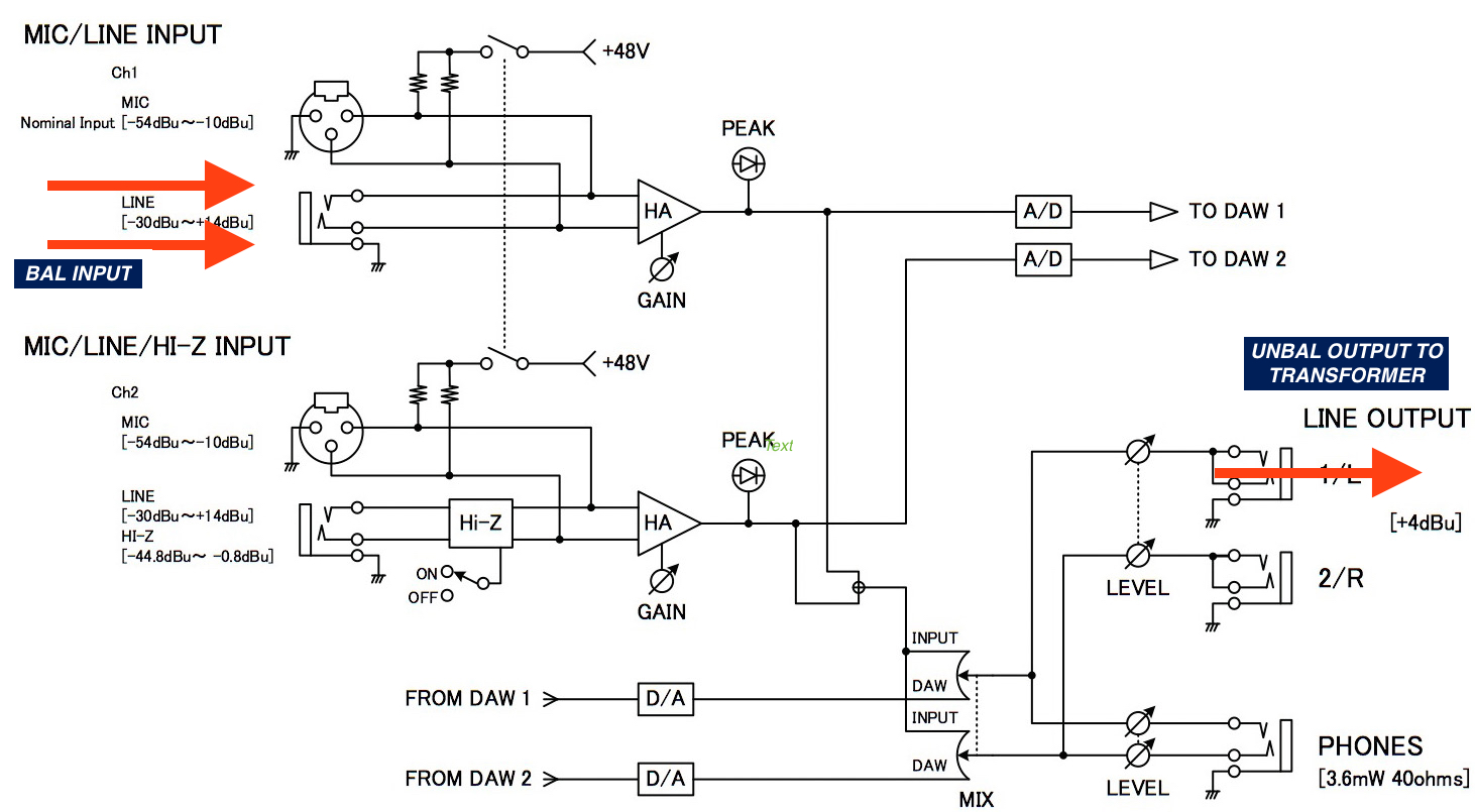

One transformer is needed for input to BAL line input to the UR22.
Another is needed to isolate the line out to D-Class under test.
This worked using the EDCORs. Half and full bridge.
Frequency response is super, down 1db at 20khz
The bal 1k,1k,0047,.0047 filter not used here or shown. It adds about -1db 15khz up.
