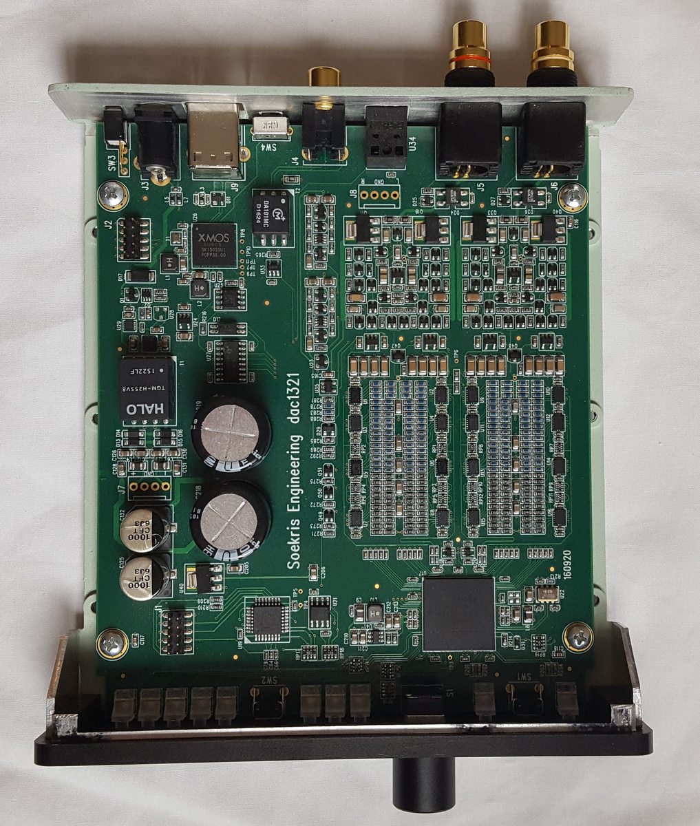

I have the dac1321 and I'm interested in trying out the community made filters but I'm kind of lost as to where the actual wires connect. I believe the dac1321 has similar (the same?) headers on the PCB as the 1121, J1 and J2. other then a rpi and the appropriate cable, what else would I need?

Hmm, that's a prototype board, where did you get that from ??
Anyway, that board is missing the 3 pin serial connector, so you need to use J1, here's the pinout you need, still 3.3V digital levels, use any GND pin, please note it's a 2mm header.
And yes, the dac1321 use same filters as all the other boards and units, Firmware is specific for the board or unit.

@soekris I got the picture from the product listing on the website. (Soekris Audio ApS, Products dac1321)
I opened up my dac1321 and found the same pinout of your attached picture but on dedicated headers. Just looking at pcb traces it looks like the header connects to where the J1 connector connects to the IC. For reference my dac1321 has serial number 59. I assume I should use the dedicated header?
I have a usb to serial port, should I just measure between TXD/RXD ports to ground to verify its 3.3v? following this guide (Soekris R-2R: Firmware upgrade | Dimdim's Blog) says that for the dam1021 you need a RS-232 interface, does the dac1321 use TTL instead of RS-232? sorry if this is a stupid question, trying not to blow anything up :wiz:
This is a link to the picture, for some reason it won't upload from my computer :confused:
Aah, I should have recognized my own picture....
Yes, it's easier to use J10, the pins are named and 0.1" spacing. There is a guide to firmware update on soekris.dk.
