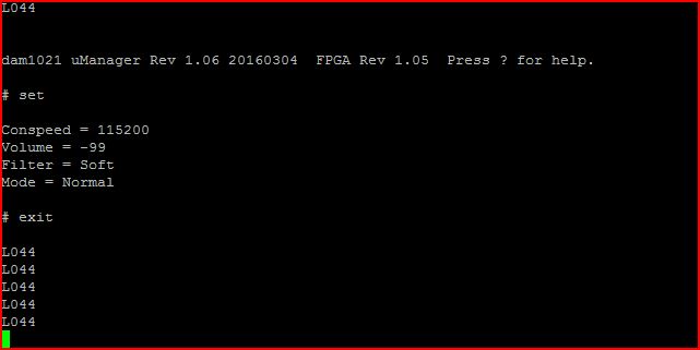

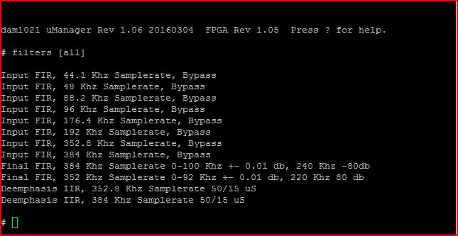

Hello all,
I recently joined the diyAudio community looking for information on the Soekris dam 1021 unit.
Thanks to several threats here I was finally able to get the proper USB/RS232 cable connected to the dam 1021. Right after that I uploaded the NOS filter published by Spzzzzkt back in 2015 but after power cycling the unit the SPDIF signal doesn't lock anymore.
I reverted to the original Soekris filter and the signal locks OK again.
Has anyone seen this problem before?
Thanks.
