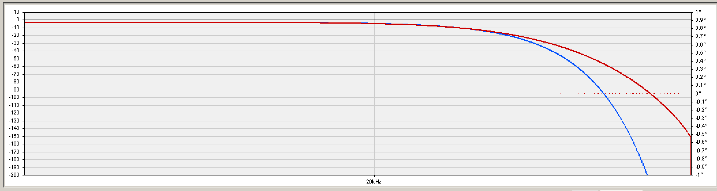

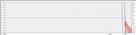

I have to admit that there is a bit of an imperfection with the TNT1 filter. I did a new one and have listened to it during the day. Definitely more clean - actually the cleanest filter I have heard on DAM. Its geared even more to the theorem and mirror suppression (-163 dB at 22,04 Khz) rather than hammering out the last 0,1 dB at 22,045 Khz... being down 0,3 dB at 19,4 - bats may weep ;-/

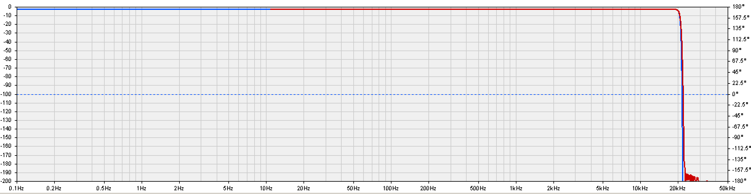

Good observation - it's 3 dB down in filter on purpose - no inter-owers!!

Theoretical characteristics. Red is valid due to no_of_taps limitation (2k). Thanks rePhase!!!
