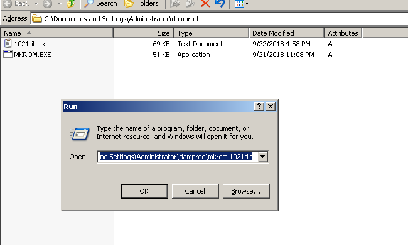

Filter brewing for the Soekris R2R
For C:\Desktop\damprod\MKROM.EXE 1021filt.txt
i get Windows cant find c:/Documents....

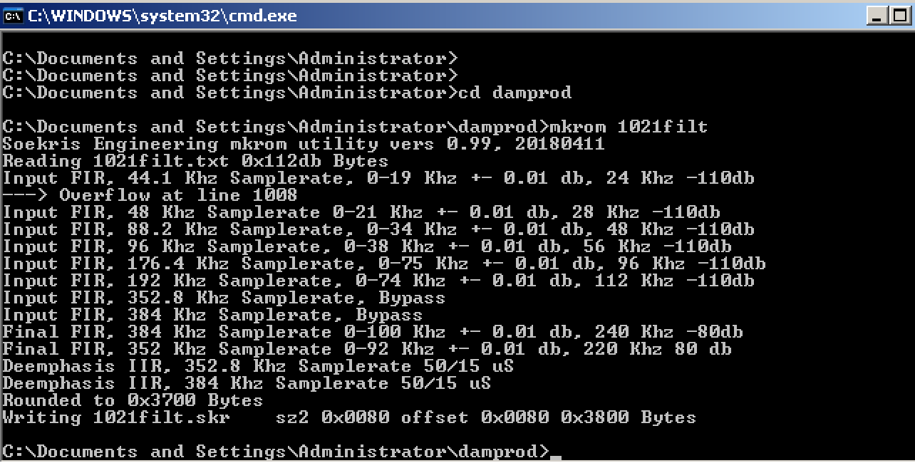

I took an old file and modified red text to make it read:
(and the removed the old code and insterted 1999 new lines instead of thr old 383 (or similar) to read:
dam1021,44100,8,1,1999,8
Input FIR, 44.1 Khz Samplerate, 0-19 Khz +- 0.01 db, 24 Khz -110db
0
-0.0000000080755026309958713
-0.0000000323239300280718
-0.000000072776843661477532
-0.00000012946407841209499
Nothing special with line 1008 ??
Okey - got it!
As I'm trying to create a filter which not only do D/A fs/2 filtering but also compensate for my corner-placed linesources, I have som "wild" EQ going on. I'm using rePhase and I needed to lower the output of the filter to not clip. Overflow... clip. That printout didn't really trig that insight.

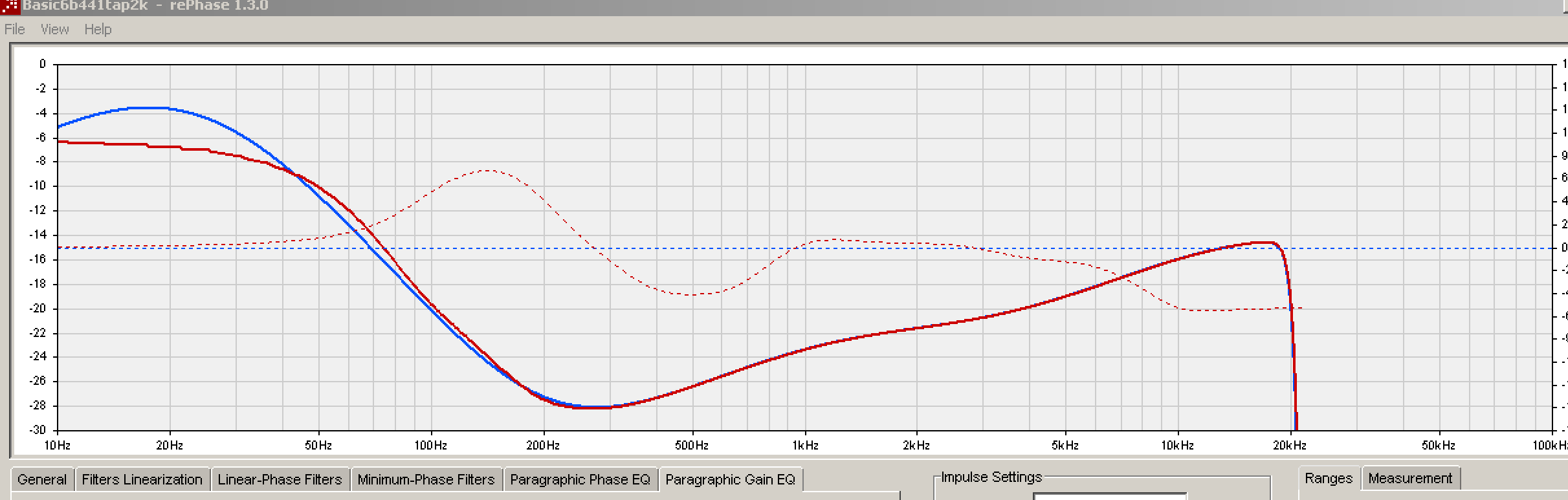

Stumbling into problems with the FIR filters, I took a break and inbestigated the IIR option. This at least I could make sound reasonably:
-- IIR for my FR10 Line Source (picture show filter)
dam1021,44100,8,16,5,0.8
16 IIR biquad 1
b0 = 0.9172257802529049
b1 = -1.792384354953564
b2 = 0.8759611472790664
a1 = -1.792384354953564
a2 = 0.7931869275319711
dam1021,44100,8,17,5,0.8
17 IIR biquad 2
b0 = 1.0143276105115997
b1 = -1.9937904939813273
b2 = 0.9794745396614566
a1 = -1.9937904939813273
a2 = 0.9938021501730564
dam1021,44100,8,18,5,0.8
18 IIR biquad 3
b0 = 0.8921442650005743
b1 = -1.147917583936177
b2 = 0.3692549599892966
a1 = -1.147917583936177
a2 = 0.26139922498987106
dam1021,44100,8,19,5,0.8
19 IIR biquad 4
b0 = 1.1028532631739936
b1 = 0.9067249064166488
b2 = 0.10268425080507655
a1 = 0.9067249064166488
a2 = 0.20553751397907014
The biquads was calculated from this page:
Biquad calculator v2 | EarLevel Engineering
After swopping a for b in the biquads, the system now sound at least like music 🙂
SQ? Hmm, but still, at least in the ballpark!
MROM overflow fixed by setting the last term here to "0.8".
