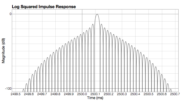

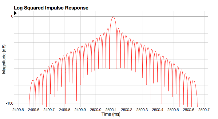

I thought I try to articulate what I think is going on with the time smear effect, and why the LSIR plots are useful in understanding the filters.
The basic premise is that the wider the "smear" the greater the apparent energy in the signal. As far as I can tell the peak value of the signal is not effected so the signal level measures the same. This is why the effect does not show up in frequency response plots.
The Log Squared Impulse Response shows how the impulse effects the signal plotted as amplitude vs time. As the "shoulders" of the impulse become wider and higher the apparent level of lower amplitudes is increased. It's this increase that results in what gets described as "detail". The race off seems to be that as the this boost increases the dynamic quality is reduced as there is less apparent range between soft and loud sounds. Anyway that is my interpretation and it seems to work in general terms 😉
Thought it might illuminate things if we had a look at a few filters in the LSIR view.

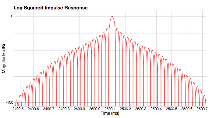

Soekris Stock 441/FIR2
attachment.php
The Stock 441 filter has quite broad high level "shoulders" to the main impulse. This will tend to boost lower level detail. I believe the fact that the spread is more pronounced in the -20 to -30dB range accounts for the "forward" and "shouty" character of the filter.

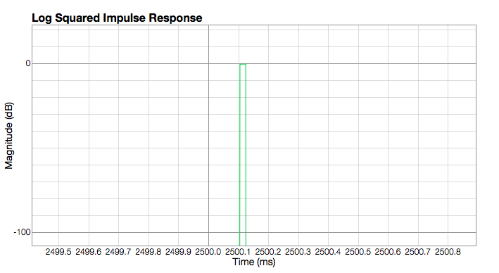

NewNOS
attachment.php
NOS filter concentrates all the energy into a single impulse.

v4RG was considered to be rolled off in the high end and female vocals behind a "curtain".

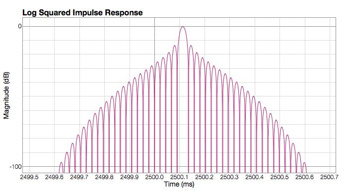

NQtb65
attachment.php
Vastly improved high end response and no obvious curtain effect on female vocals. The main change to the filter is that the width of the transition band was decreased to 6.5kHz making the filter slightly steeper.

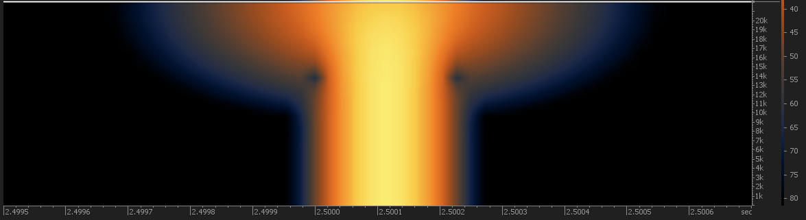

Filter Tuning 3

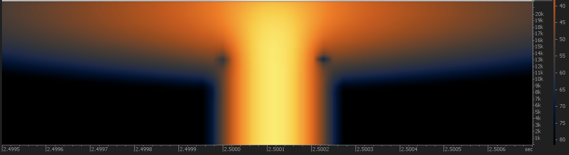

I was starting to doubt the veracity of my theory that the time smear works almost entirely in the mid to high end so looked at the spectrum of the impulse in Isotope RX. Sure enough the impulse spectrum looks very much like an inversion of the Log Square Impulse Response. For most filters there is little influence below 10kHz.
This shows 0-22kHz, 2.4495-2.5007 seconds and 0-85dB and done on SoX processed impulse using bother FIR1 and FIR2 filters.
I'm half-tempted to call these "Elephant diagrams" 😉
Default Soekris 441
attachment.php
Time smear starts to bite at a lower frequency than the other filters tested. This might be due to the lower corner frequency of the filter, and may be a reason for the "forward" character some listeners have reported.

Someone observed in the construction thread that the totalcrap was "very detailed". I believe this is mainly due to the large amount of time smear above 12.5kHz increasing the amount of energy in the HF.

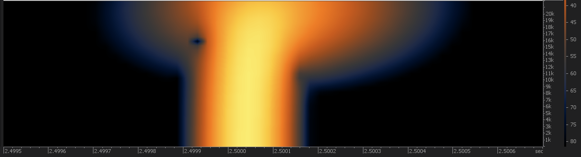

IPv4p35:
attachment.php
You can clearly see the redistribution of energy resulting from the intermediate phase. And again there is little time smearing below 10kHz.

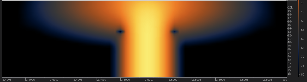

NQv4:
attachment.php
NQv4 was perceived to be rolled off in the HF. I think this has about the same total smear as the IPv4p35 filter but with symmetrical distribution. The main thing I can pick is that the smear extends to a much lower frequency in the post-ringing of the IPv4 which will give better perceived HF response. The NQv4 shifts the cut in of the smearing to a higher frequency (corner freq is higher), and there is less smearing.
